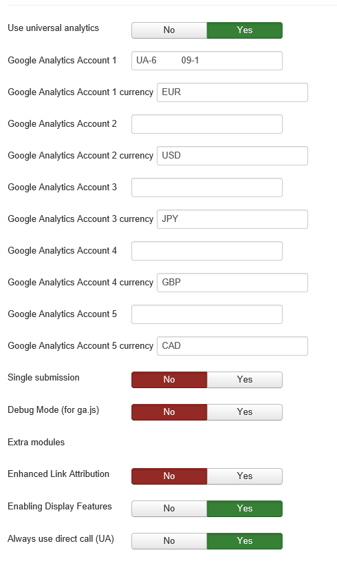

Could anyone help me to set up e-commerce tracking with google analytics?
I have been reading all hikashop topics related to this but still can't get it work. Not sure why....
I have enabled and set up google analytics plugin like on screenshot attached.
I have bank account, paypal, paysera, and cash on collection as payment methods....

The settings in your screenshot are correct.
Make sure that you install a joomla google analytics plugin, like this one:
extensions.joomla.org/extension/asynchronous-google-analytics
The ecommerce data requires also the normal analytics data for GA to use them.
Also, it could comes from the settings in the Order section of your HikaShop configuration not configured correctly.
The ecommerce data of an order will be changed when an order status change to the status selected in the "Payment confirmed order status" setting of the HikaShop configuration.
Finally, you configured the plugin only for the EUR currency. If your website is using another currency, the plugin won't do anything and you'll have to change the currency code in the plugin settings to the currency code you're using.

9 years 7 months ago #237676
I just had a look at the code and it seems that you have to enable the "Single submission" option else the data will not be sent on confirmed order status.
  • Posts: 1119
  • Thank you received: 114
9 years 7 months ago #237693
Thank you Xavier for support in this matter. I have enabled it.
