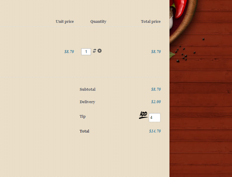

Website was working just fine, then we update joomla then that result to update also Hikashop to the newest release,
however website and hikashop works just fine, then all the sudden no TAX Showing and not collected, please help and its urgent

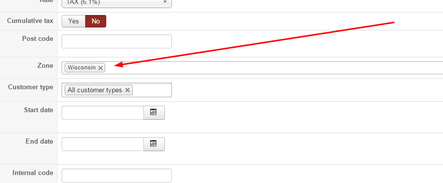

Hello Nick, and thanks for the quick reply,
well i checked that already and here is a screenshot,
do you think there is another scenario, Thanks

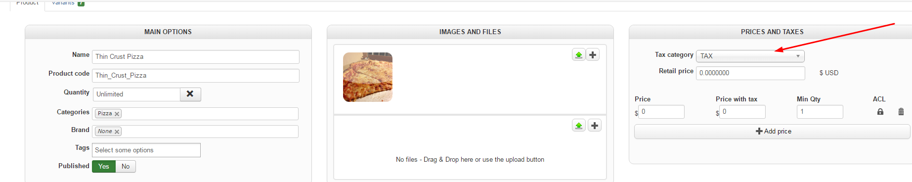

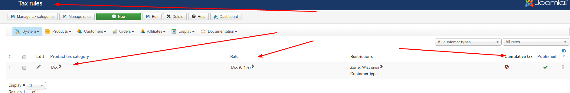

If that doesn't help, either your products are not linked to the "TAX" tax category or the wisconsin zone you selected in the tax rule is different from the wisconsin state zone that customers select in their address.

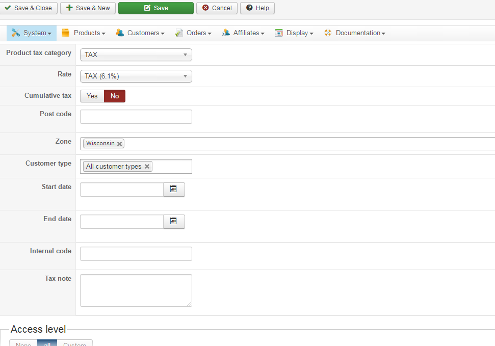

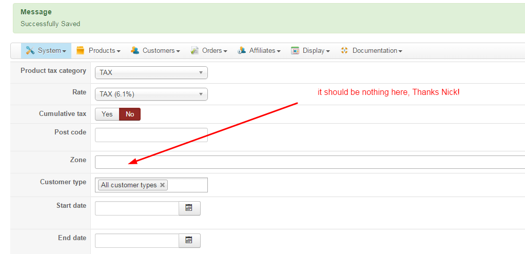

  • Posts: 154
10 years 3 months ago #239708
thanks for the help the issue was that i choose Wisconsin as a state that make it restricted , this for other people benefit see attach
the screen shoot shows the mistake the second one the correct
