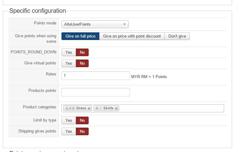

Hi support,
We set up a User point plugin in Hikashop and the setting is 1MYR to 1 point.
We tried to checkout two products -
product A with no variant and product B with variant.
When the order has confirmed,
we took a look at AUP activities and we found that user can only receive product A's point but no point from product B.
Both products are set into two categories - Dress and Skirts.
We hope to hear from you soon.
Thank you.

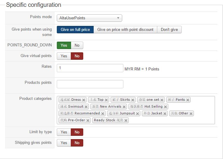

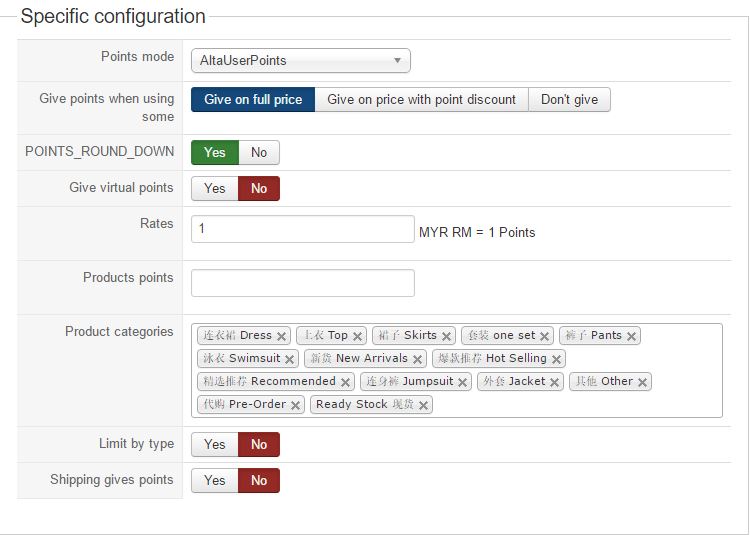

  • Posts: 29
9 years 11 months ago #249315
It seems the problem still exists.
We have already upgrade our hikashop to 2.6.4 but products with variants still unable to gain user point.

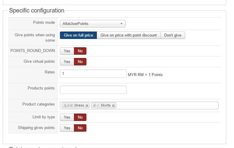

Attachments are the settings of products and userpoint plugin.
Please guide us. :) :)
Thank you.
Last edit: 9 years 11 months ago by haur0214.

  • Posts: 29
9 years 11 months ago #249371
No I did not modify the file on live site. I test the code on my localhost.
I upgrade my live site once 2.6.4 release.
It works fine when we did not set product categories on user point plugin.
But when we set few categories into it, products with variants not working again.

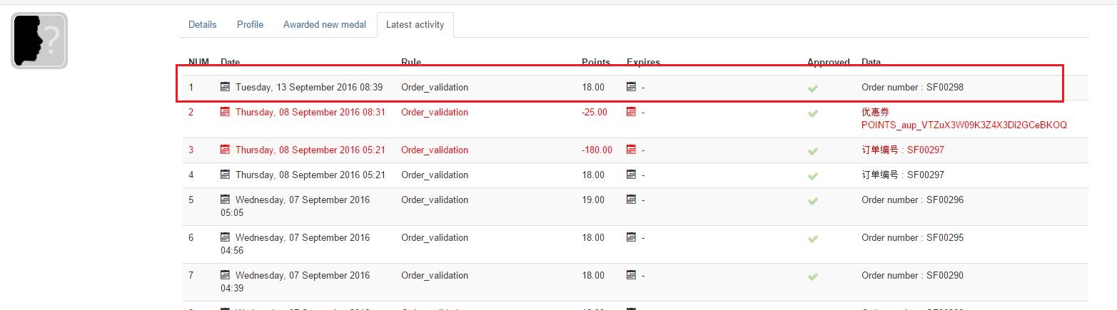

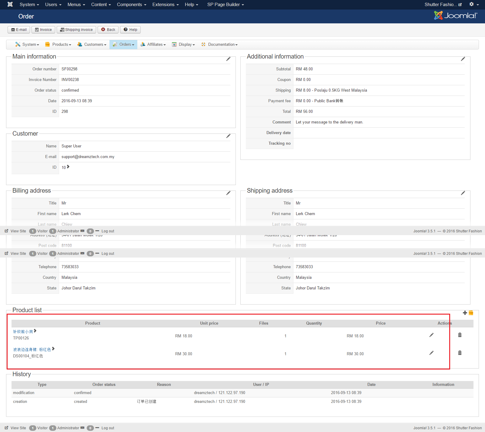

  • Posts: 29
9 years 11 months ago #249682
Hi Jerome,
We selected Alphauserpoint as the point mode so we are not able to try out on hikashop demo website.
The userpoint payment method and userpoint plugin are both published.

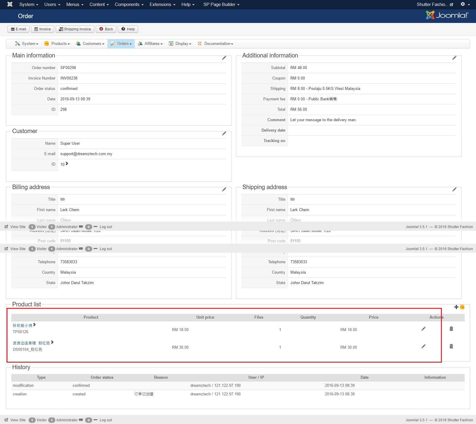

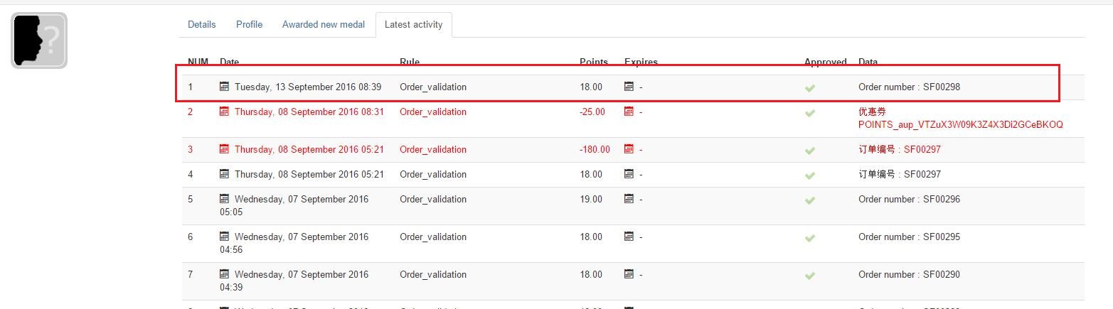

As you can see the images attached shows that SF00298 only assign 18 points for the user but the order contains two products with different prices - 18 and 30.
  • Posts: 26381
9 years 11 months ago #249688

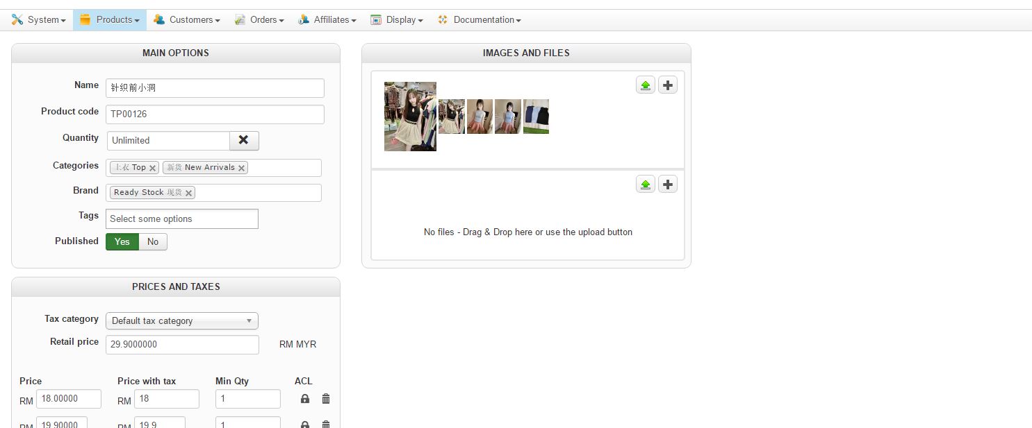

And regarding your previous screenshots, I have to deduce that TP00126 is a variant ; right ?
  • Posts: 29
9 years 11 months ago #249764
Hi Jerome,
Soory for the lack of information in last reply.

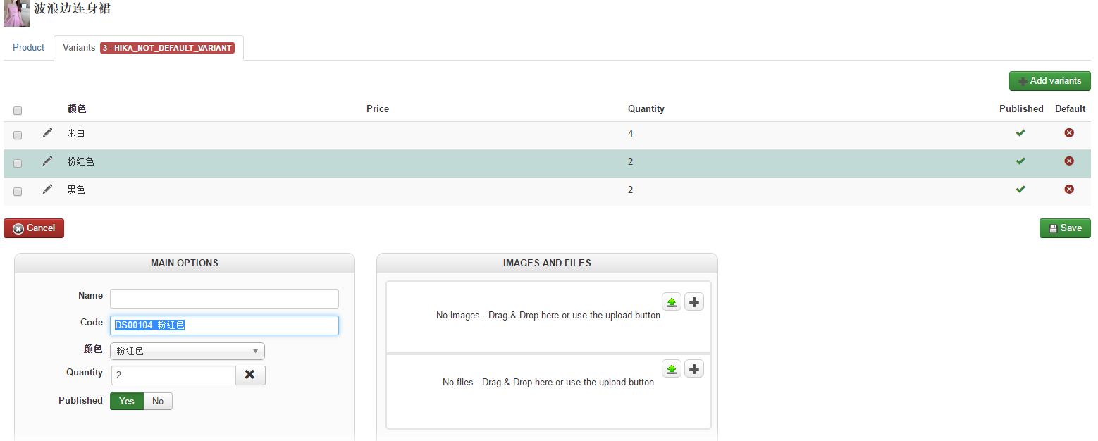

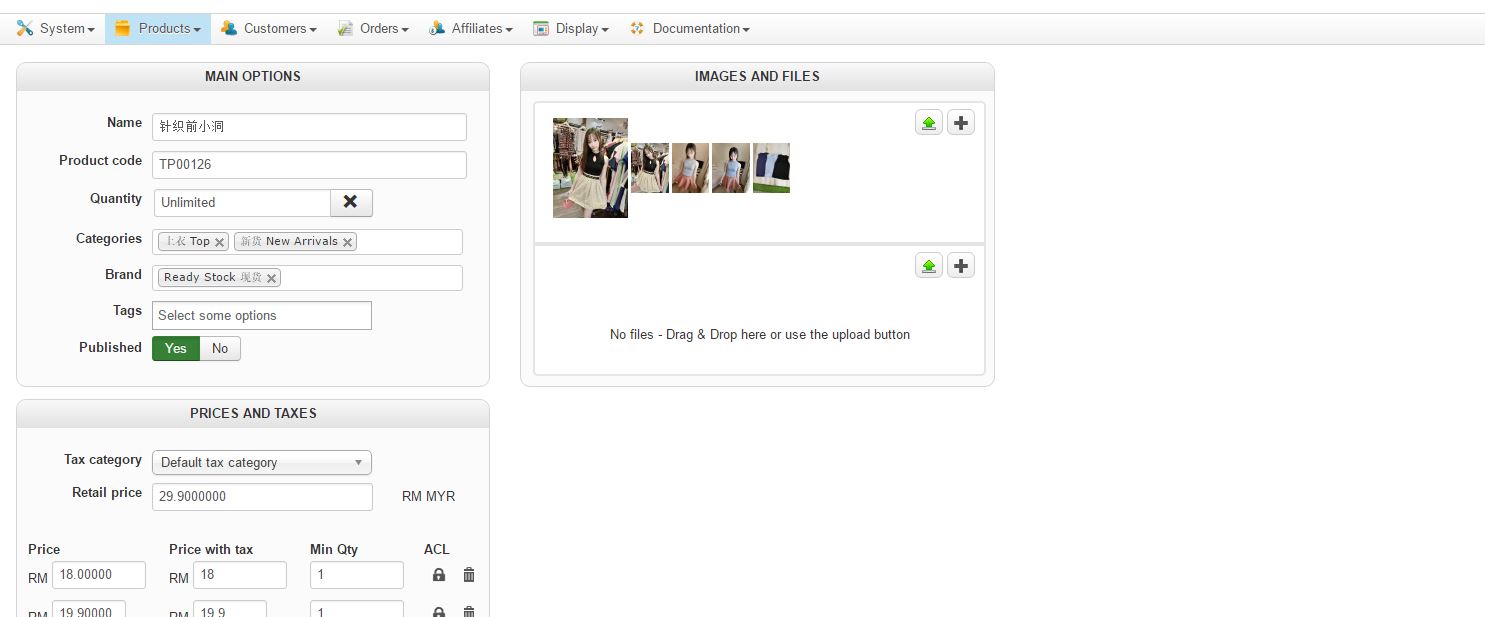

DS00104_粉红色 is a variant which does not give point in this order.
TP00126 is not a variant.

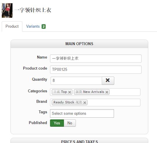

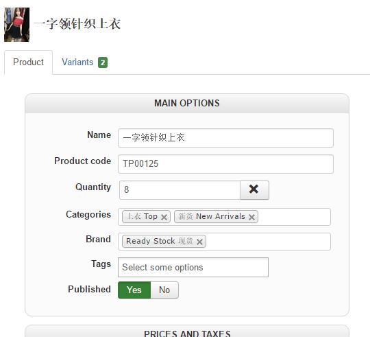

  • Posts: 26381
9 years 11 months ago #249831
And what are the categories of the main product of the "DS00104_粉红色".

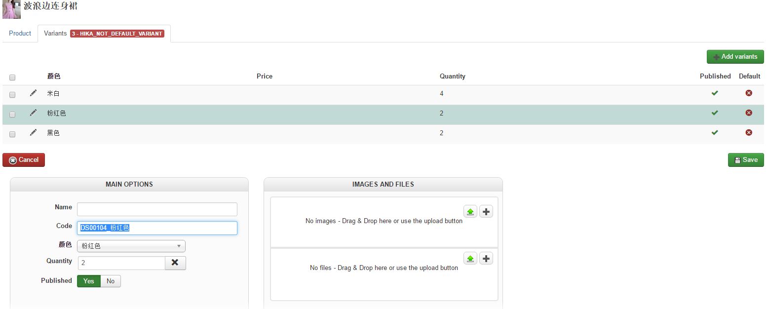

Why do you not have a default variant for that product ?
How your categories are configured ?

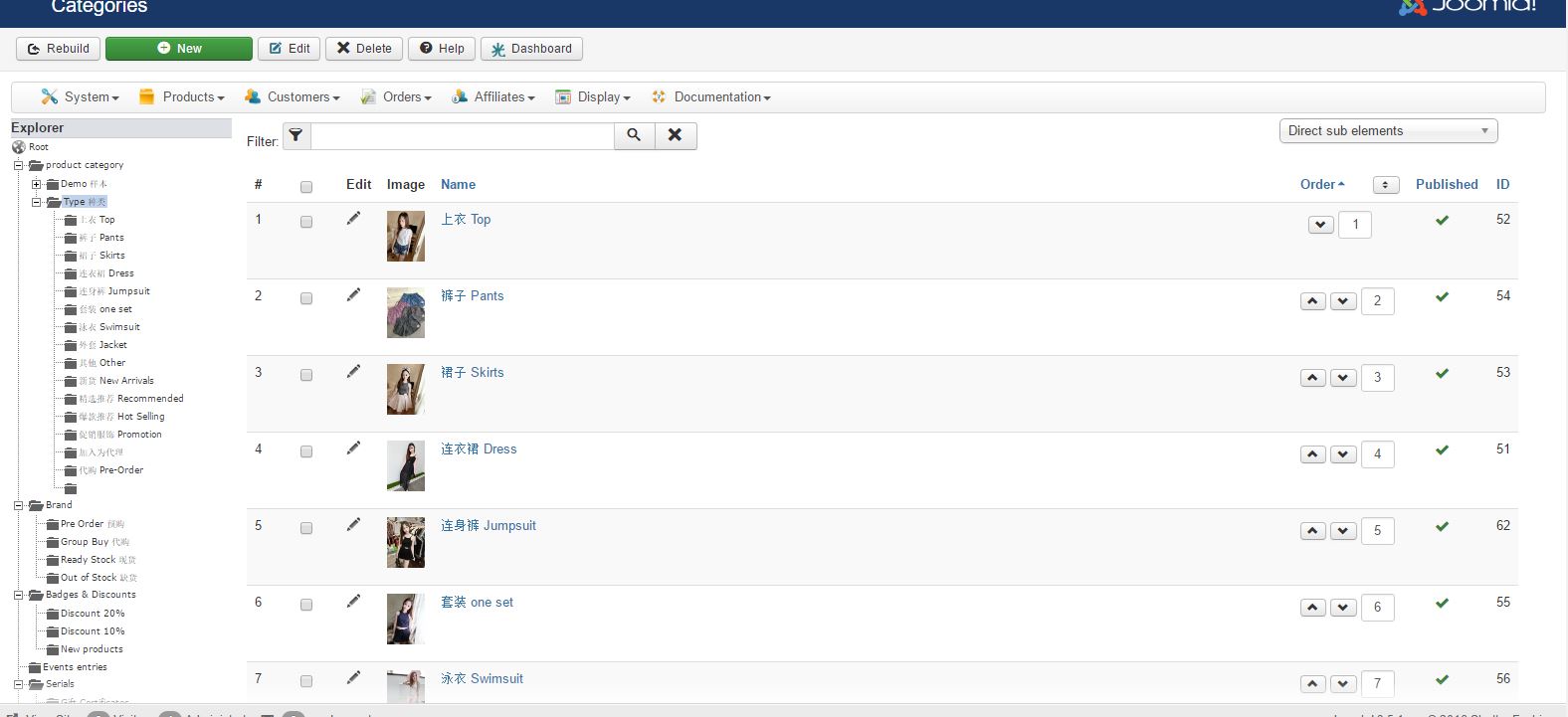

Did you try to just use one category in the "user point" plugin so, instead of selecting a lot of categories you can choose if the product will give points or not by placing the product in a specific (and hidden) category.
  • Posts: 29

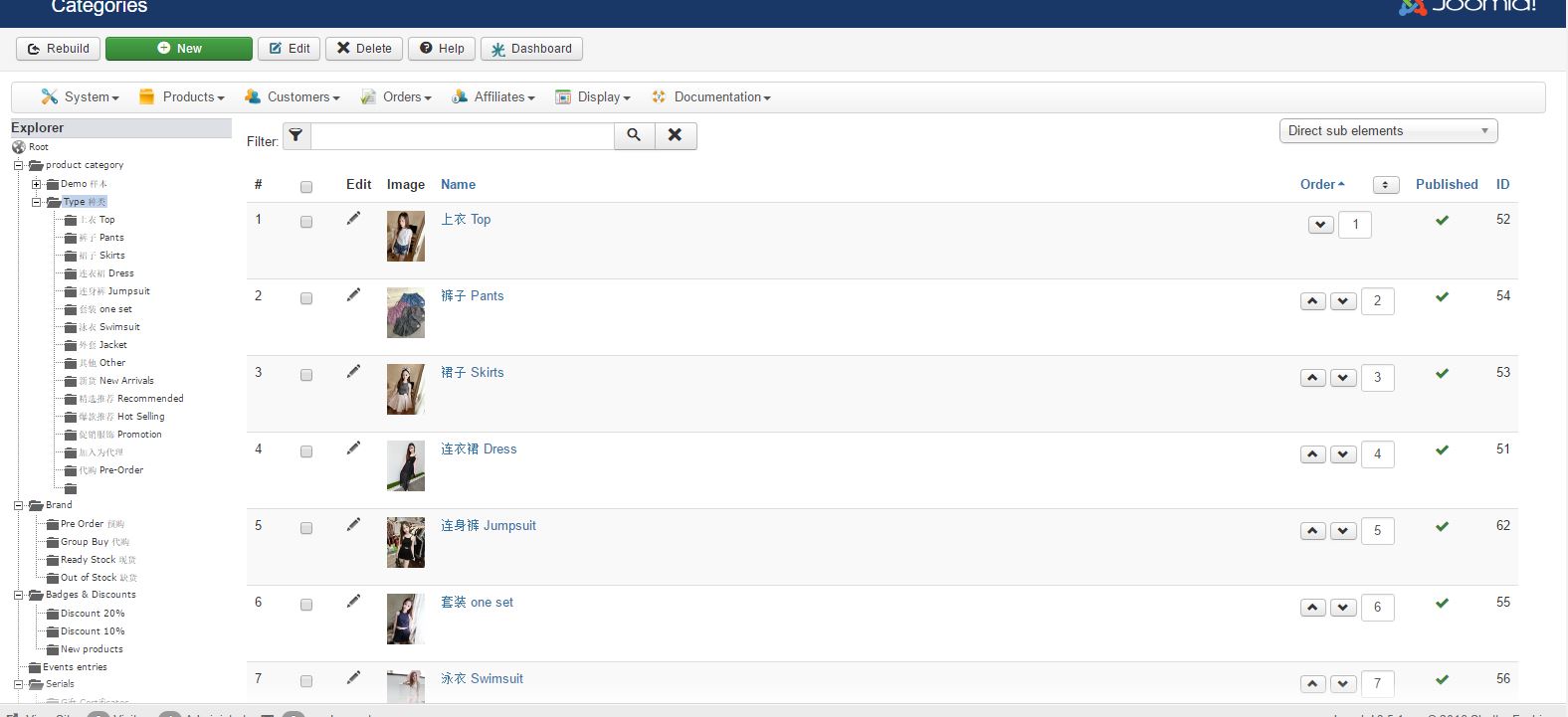

9 years 10 months ago #250134
The product categories of "DS00104_粉红色" is Top and New Arrivals.
These 2 categories are under another category which call "Type".
So the category flow is like Root -> Product Category -> Type -> Top.
We also set a default variant to test and it still not working.
We select a lot of categories because we do not want some of the categories under "Type" to give point.
We also tried to select only "Type" this category but the result is still the same.
Haur
