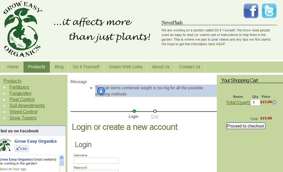

I read the other post on this error message and changed all states to min 0. I am still getting the message. What do i need to do? I attached a screen shot. Thanks!

There is no screenshot attached to your post.
If you have a weight error message, make sure that the min and max weight limits of your shipping methods allow for the combined weight of all the products in the cart. If unsure, set 0 for both and the shipping method will be displayed.
