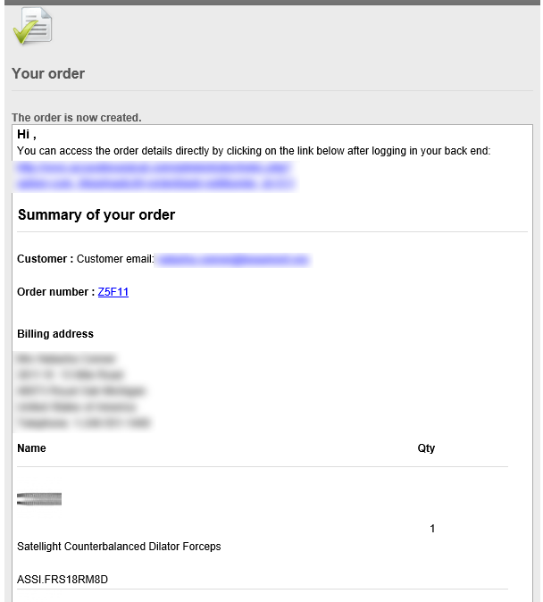

I have my shopping cart set up like a quoting system so customer and admin emails should never say "order", instead I have overrides in place so that everything says "quote" or "quotation". Recently, they have all stopped working. Any ideas?

This indicates an error in the override language file.
Turn on the debug language setting of the Joomla configuration and go to a HikaShop page of the backend. Look at the debug data at the bottom of the page.
It should tell you on which line of which file you have an error which should help you find the issue with the language override.

It states:
**Parsing errors in language files**(in red)
JROOT/language/en-GB/en-GB.com_hikashop.ini : error(s) in line(s) 2121, 2123
JROOT/language/overrides/en-GB.override.ini : error(s) in line(s) 24

So it means that you have created three errors in these files. Fix them and it will work again.
I can't say exactly what to do since you didn't provided the content of these files.
