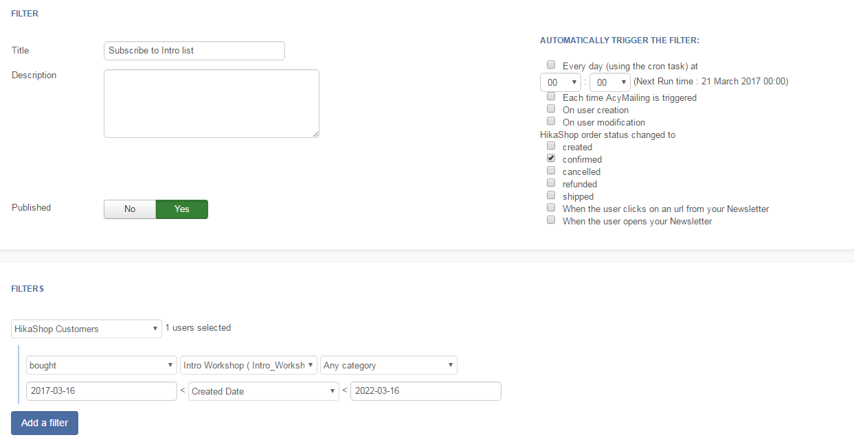

Indeed the mail is triggered but I'm waiting 10-15mins to get them. Shouldn't it be instant like getting the invoice email? I have both activated the acymailing/hikashop plugins and triggering the filter when order is "confirmed' (attached), but still isn't getting it after an order is made.
  • Posts: 86102
  • Thank you received: 14203
9 years 5 months ago #265385
It's normal that you have a delay. When you add an email to the queue in AcyMailing (or that you add the user to a list, which has a campaign which adds an email to the queue), you have to wait that the queue is processed by the AcyMailing cron so that the email is sent. If you want it to be sent faster, you have to configure the AcyMailing cron to trigger AcyMailing more often. Please check with the AcyMailing support about that.
