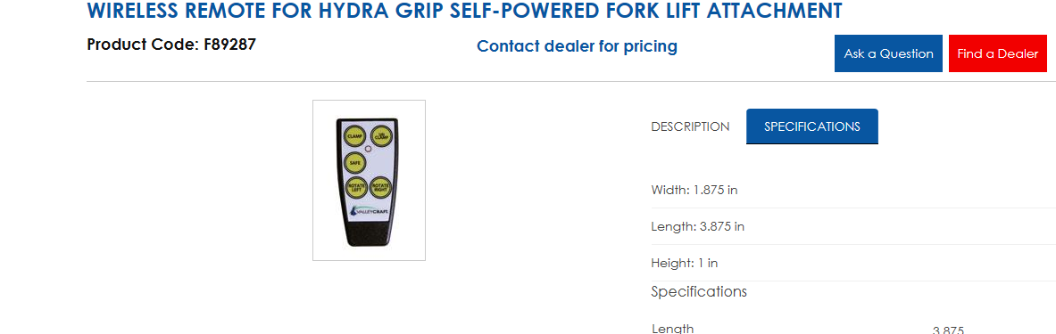

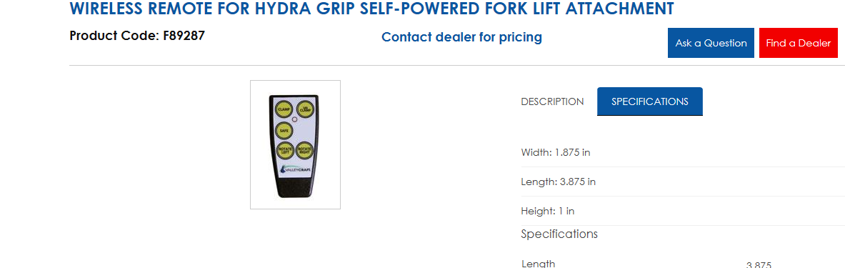

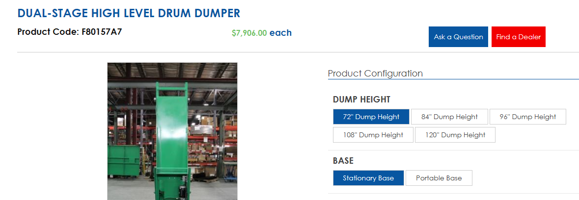

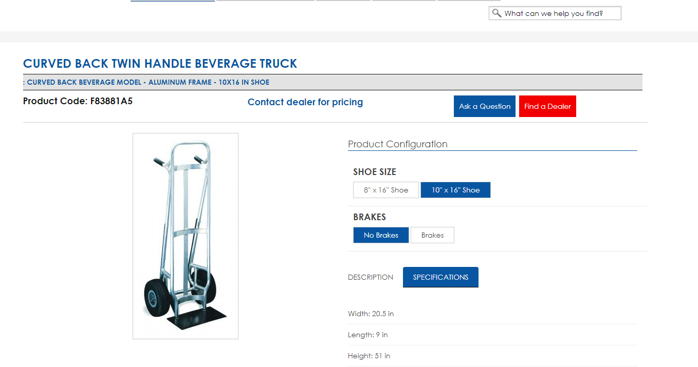

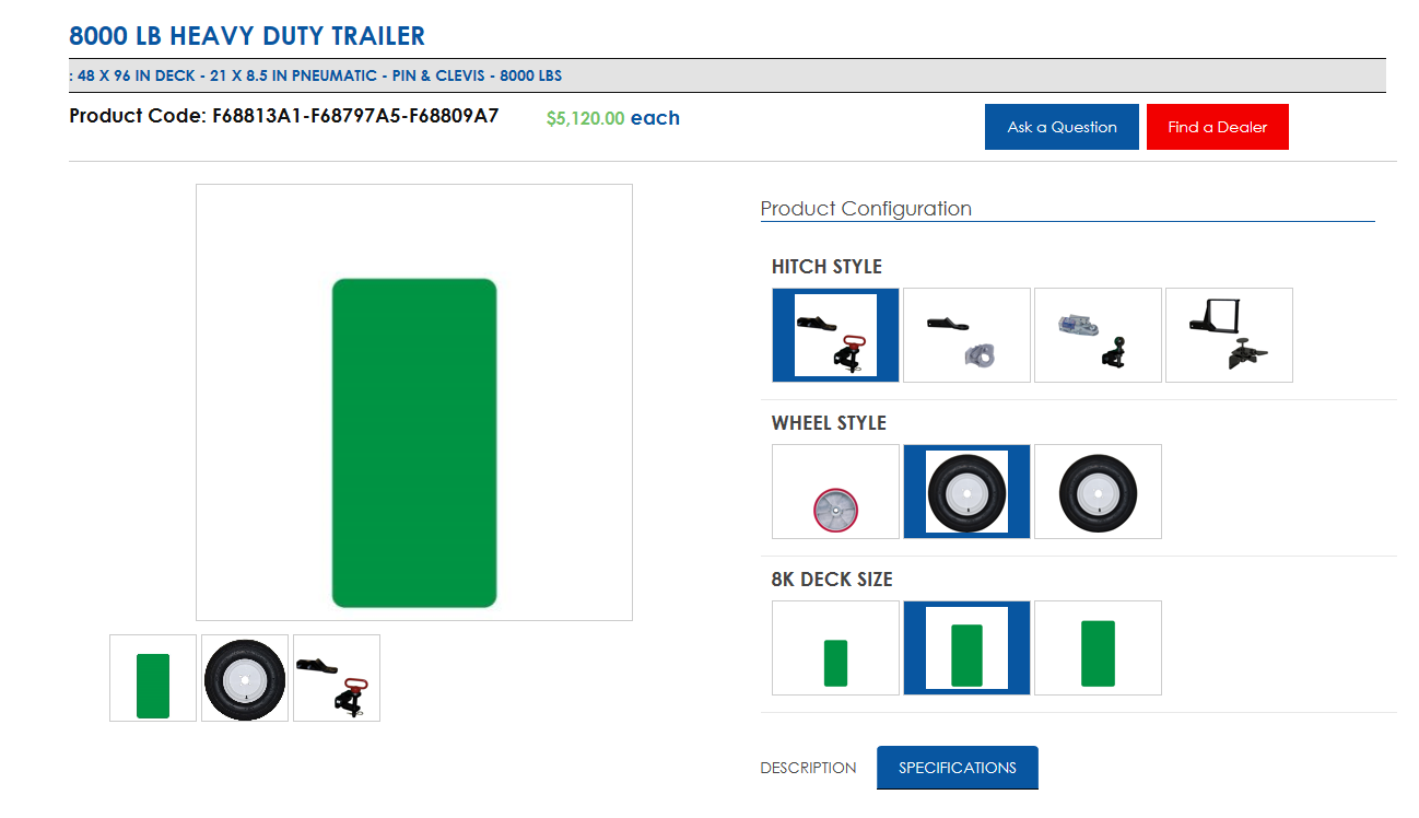

  • Posts: 17
8 years 5 months ago #290078

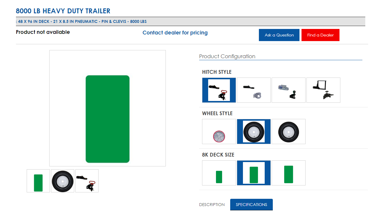

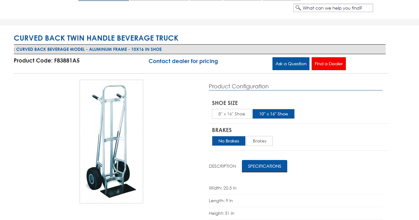

I went through and was able to make each variant product display price individually, rather than doing it on a mass basis. However, now the product codes are hidden as well, although I didn't opt for this to happen. Do you know how I can get that do display again?

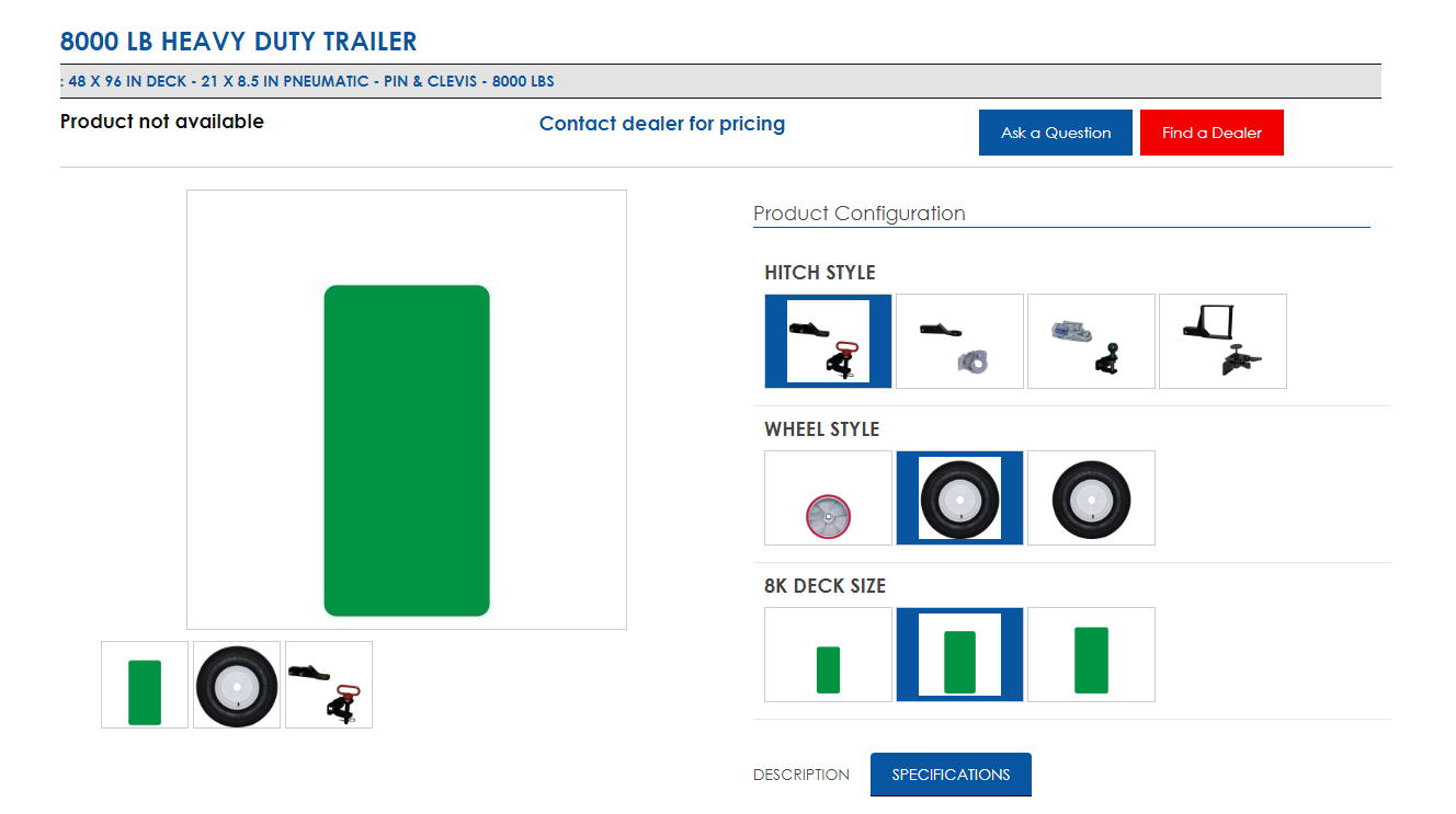

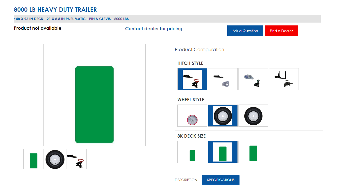

  • Posts: 17
8 years 5 months ago #290080
Just wanted to send some attachments to make this more clear. When you search a product on our website, it shows up, but when you click the options, the product code disappears. For example, the product code shows when I search F833881A5 and click on the item, but if I click "No Brakes" it will then say product not available. I'm hoping to remedy this glitch.
Thanks!
  • Posts: 86104
  • Thank you received: 14204
8 years 5 months ago #290108
This means that there is a problem with how the product layout view file (show_default, or show_tabular, you can see it with the Display view files setting) was customized.
Unfortunately, I can't say more with just screenshots and without knowing how the product layout was customized.
