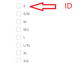

7 years 11 months ago #297925
How could i get each filter characteristic value id in product / filter.php view?
As each filter is added with "$html[$count]" i am not able to find it...

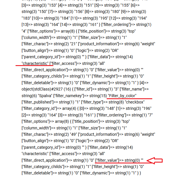

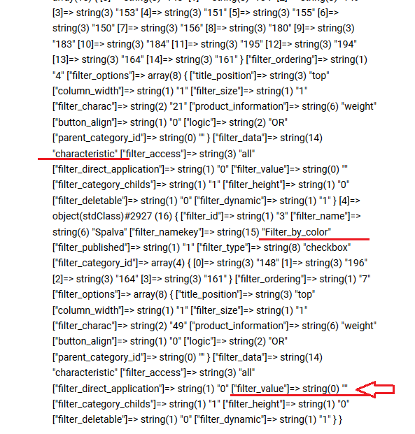

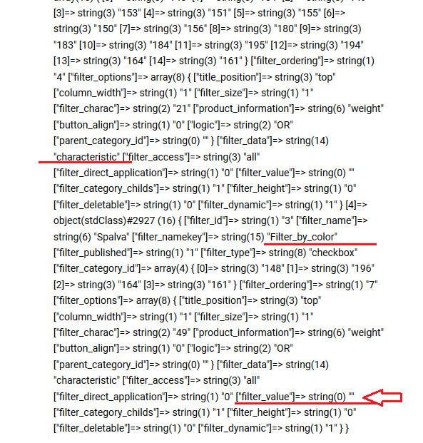

7 years 11 months ago #297950
Thanks for replay Philip.
Well yes, it gives array for filter_value if filter is by price. However if it's by characteristics it gives " string(0)".
