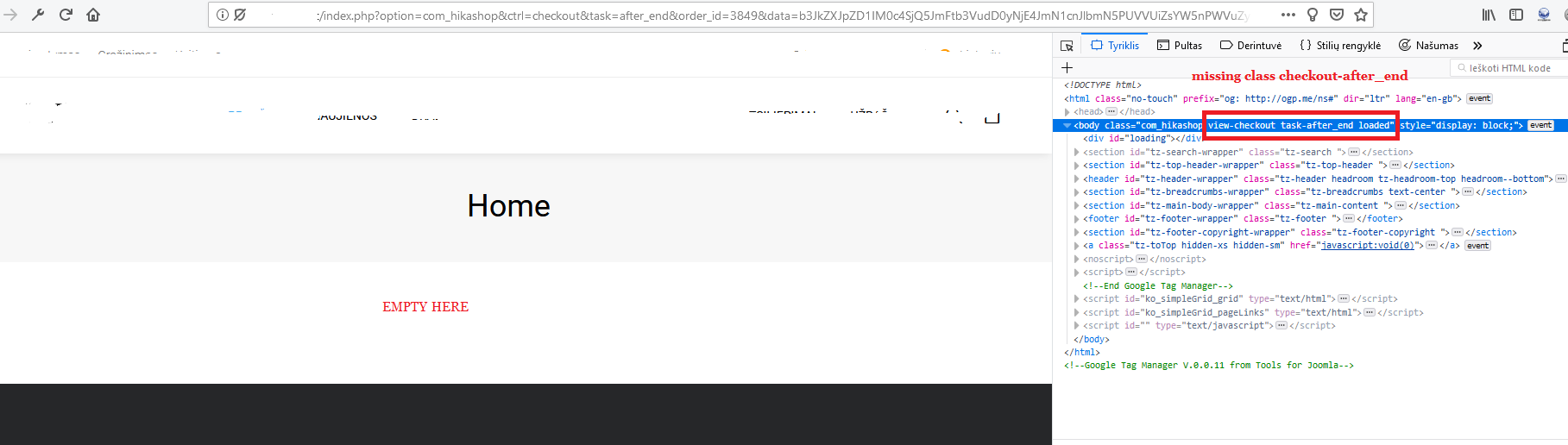

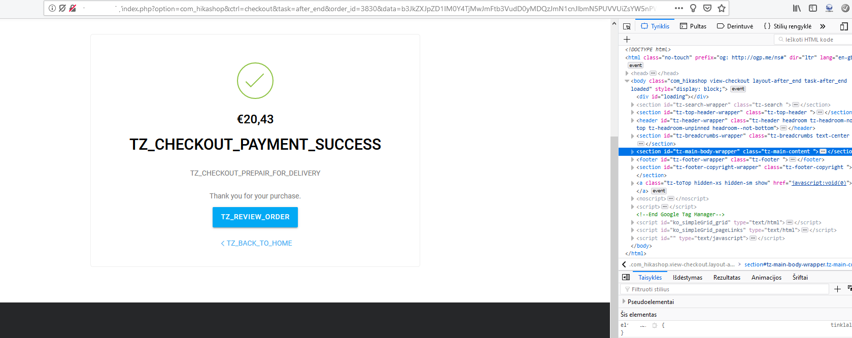

2. I do not have anything in return url, so it's empty. After returning from payment processor, hkashop component view returns nothing. However, i have done few more test and found that it only effects guest users. So it works fine for registered users!
I am attaching 2 screenshots. First one is for registered user and second one is for guest user. As you can see, after doing it as a guest, in body there is missing class "layout-after_end" compared with registered user. So i assume layout after end is not loaded for guest user, those there is no thank you page....
Hope you can reproduce the issue.

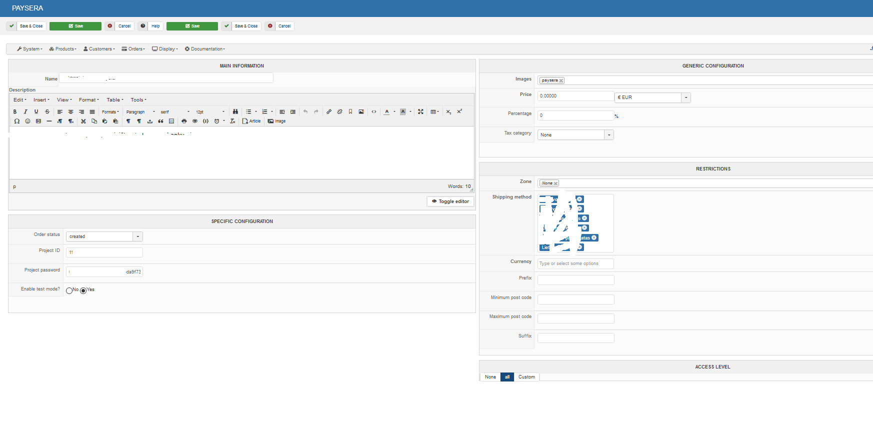

So which payment plugin are you using ? Could you provide a screenshot of its settings and blur the sensitive data on the screenshot ?
Also, it looks like the after_end view file has been heavily customized by your template. Do you have the same issue with the default template of Joomla ?
  • Posts: 1119

I am using payment plugin paysera. Maybe it's related only to that plugin? I couldn't test with paypal plugin as this would require to pay for the item... We will update our live site soon and then probably i will be able to give you more info regarding this....
There is nothing special in that plugin. Here is the screenshot.
