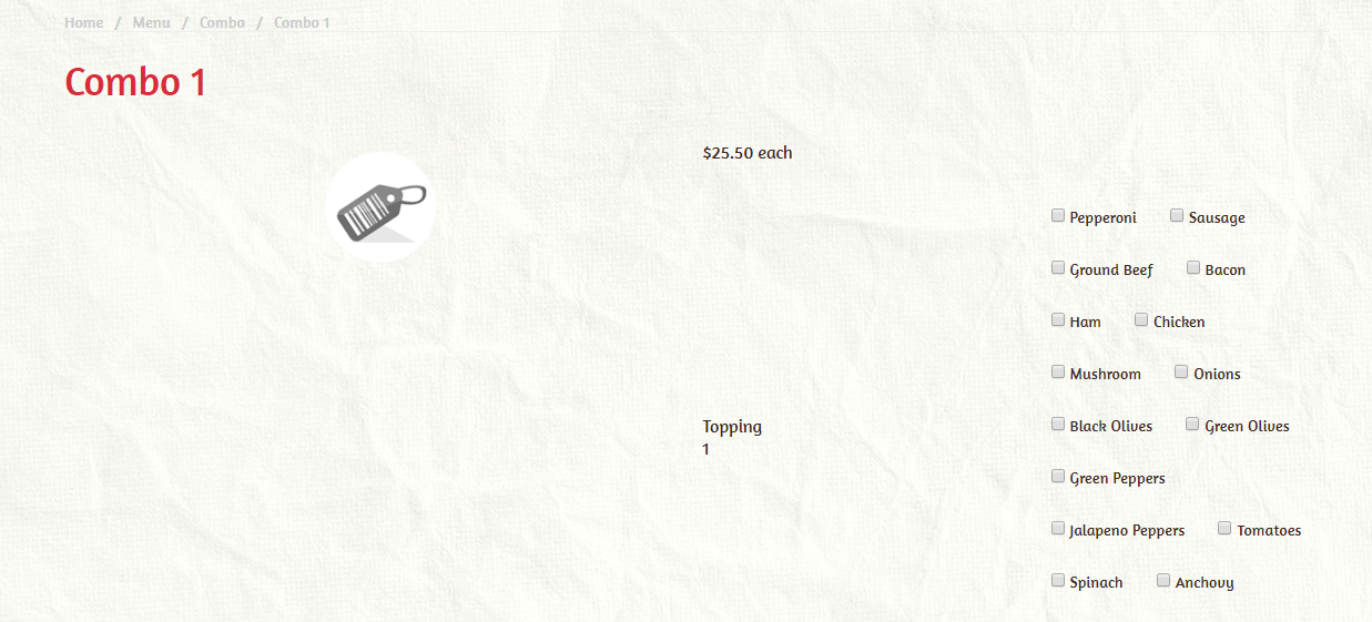

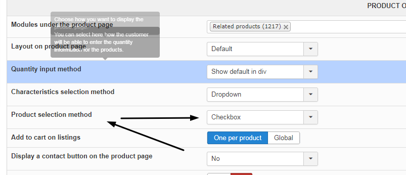

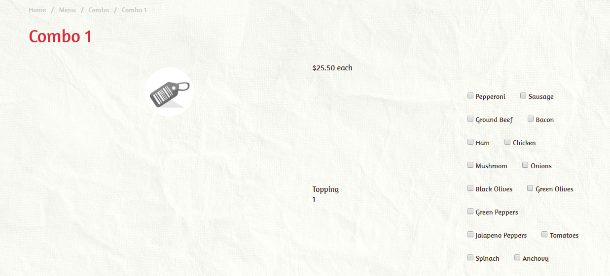

that was a perfect solution, but my options come to a checkbox, we had to change them in the product configurations, see screenshot, in this case, Customs will be able to check all the options, less than I'm missing something, please give me hint, thanks

You should change the "product selection method" setting of your topping 1 and topping 2 products to "single dropdown" in order to have a dropdown and not checkboxes. That way, only one choice can be made by the customer for the topping 1 option and only 1 for the topping 2 option. That way, you'll be sure that you'll have only two toppings selected.
If you want to do it with checkboxes, that would require some custom coding as there is no system to restrict the number of elements selected in checkbox mode.

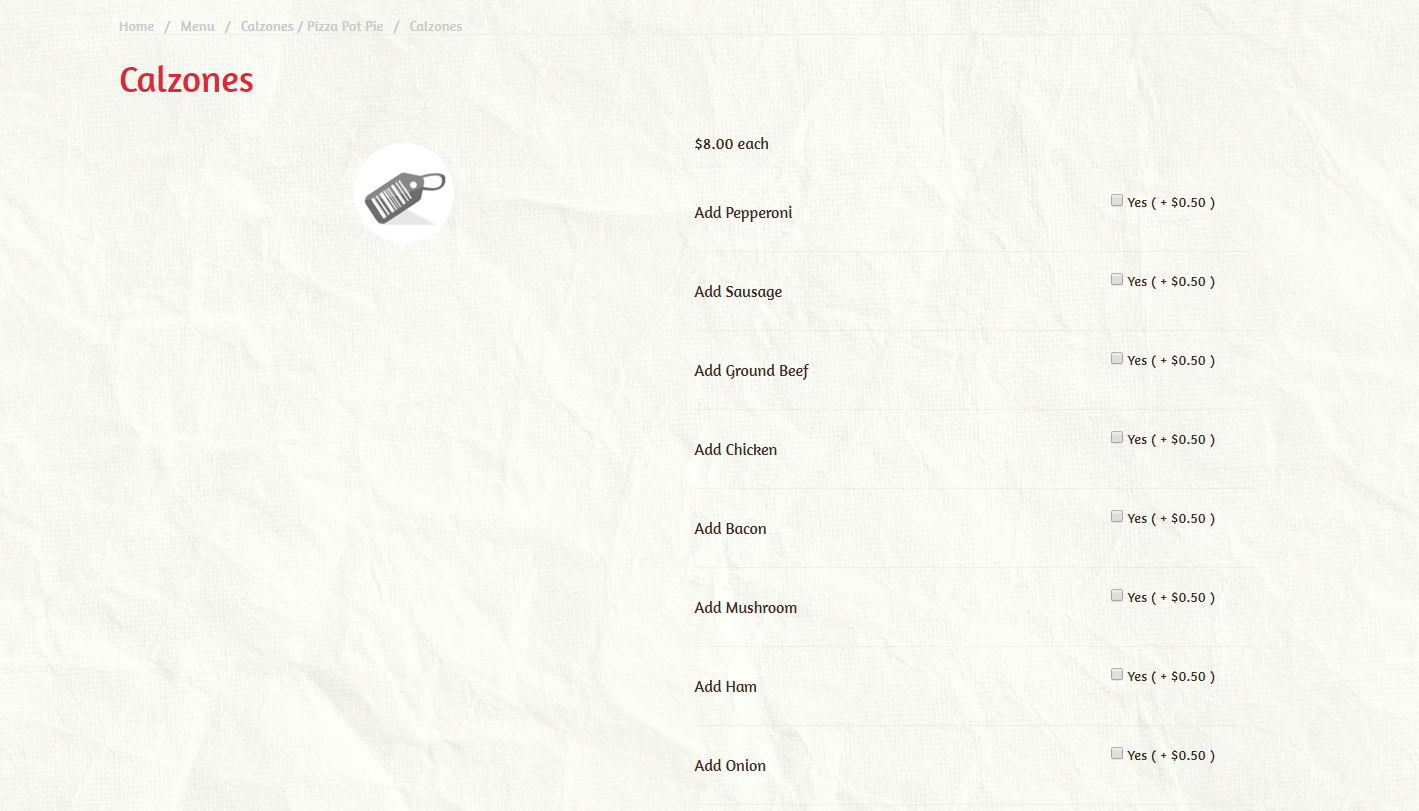

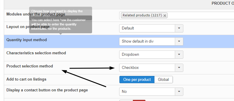

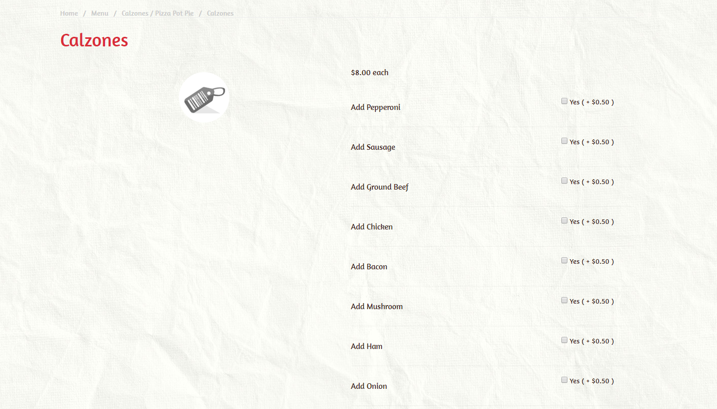

I agree with you, but remember we had to change the product selection method to a check box because we had to do a different product as addon, then as options see screenshot, is there is a way to make only these two topping or these two products which is Topping 1 and Topping 2 as a dropdown without making a big change in the all other product ?

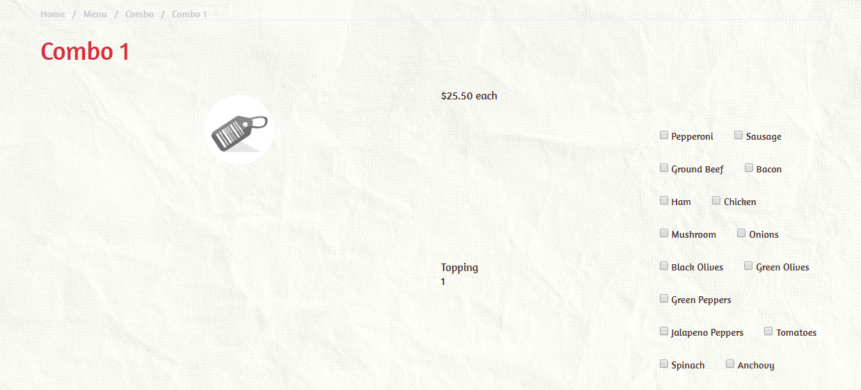

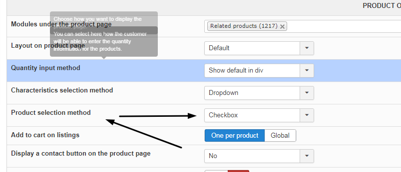

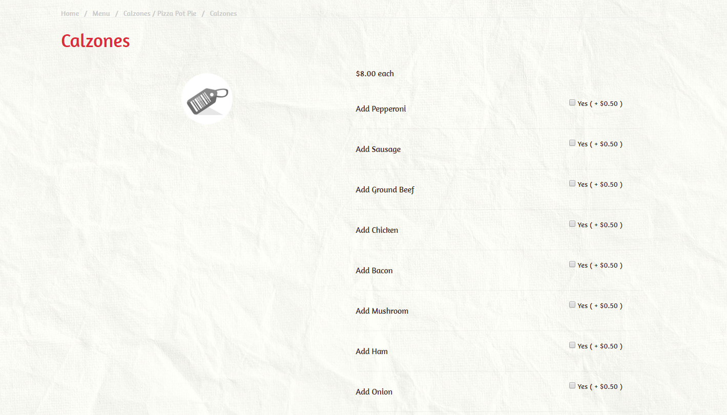

This is what we did
so we can have this result like this in this product
ANy help appreciated Thanks

6 years 10 months ago #310034
In the "product selection method" setting of the HikaShop configuration, select "on a per product basis".
Then, in each option product, you'll be able to find the same setting so that you can have a different look for each option.
