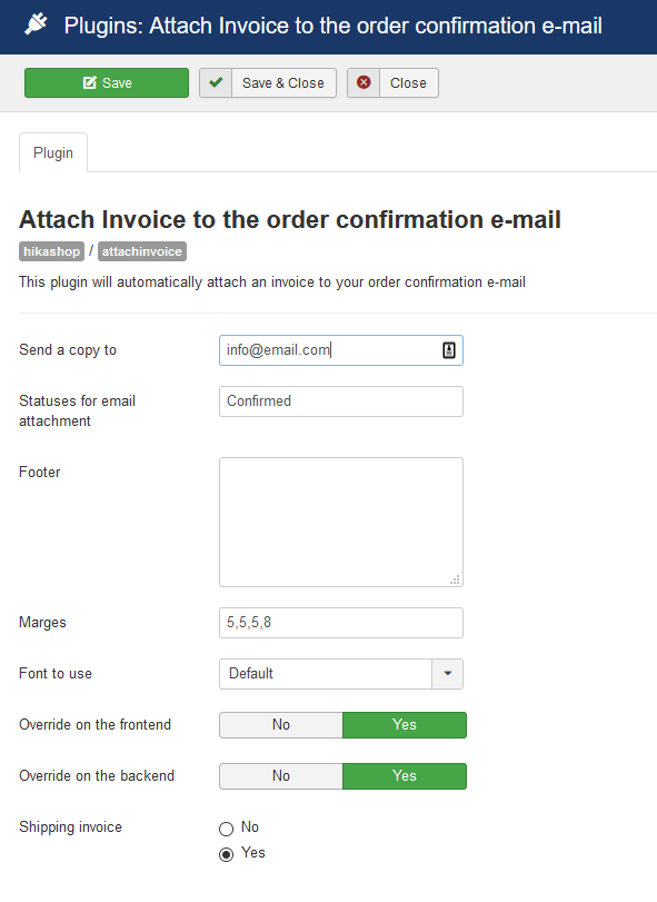

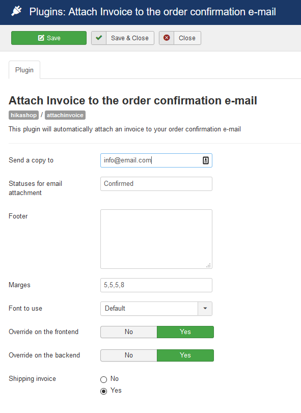

  • Posts: 14
6 years 10 months ago #310586
We have implemented the new Payfast Plugin and even though the sale is marked as "completed" the PDF is not attached to the outgoing email.
I have attached a screenshot, is there something we are missing?
  • Posts: 85880
  • Thank you received: 14119
6 years 10 months ago #310587
You should use a lowercase "c" for the "confirmed" text in the "Statuses for email attachment" because the namekey of the status is with a lowercase. With an uppercase, it won't match with the status of the order.
