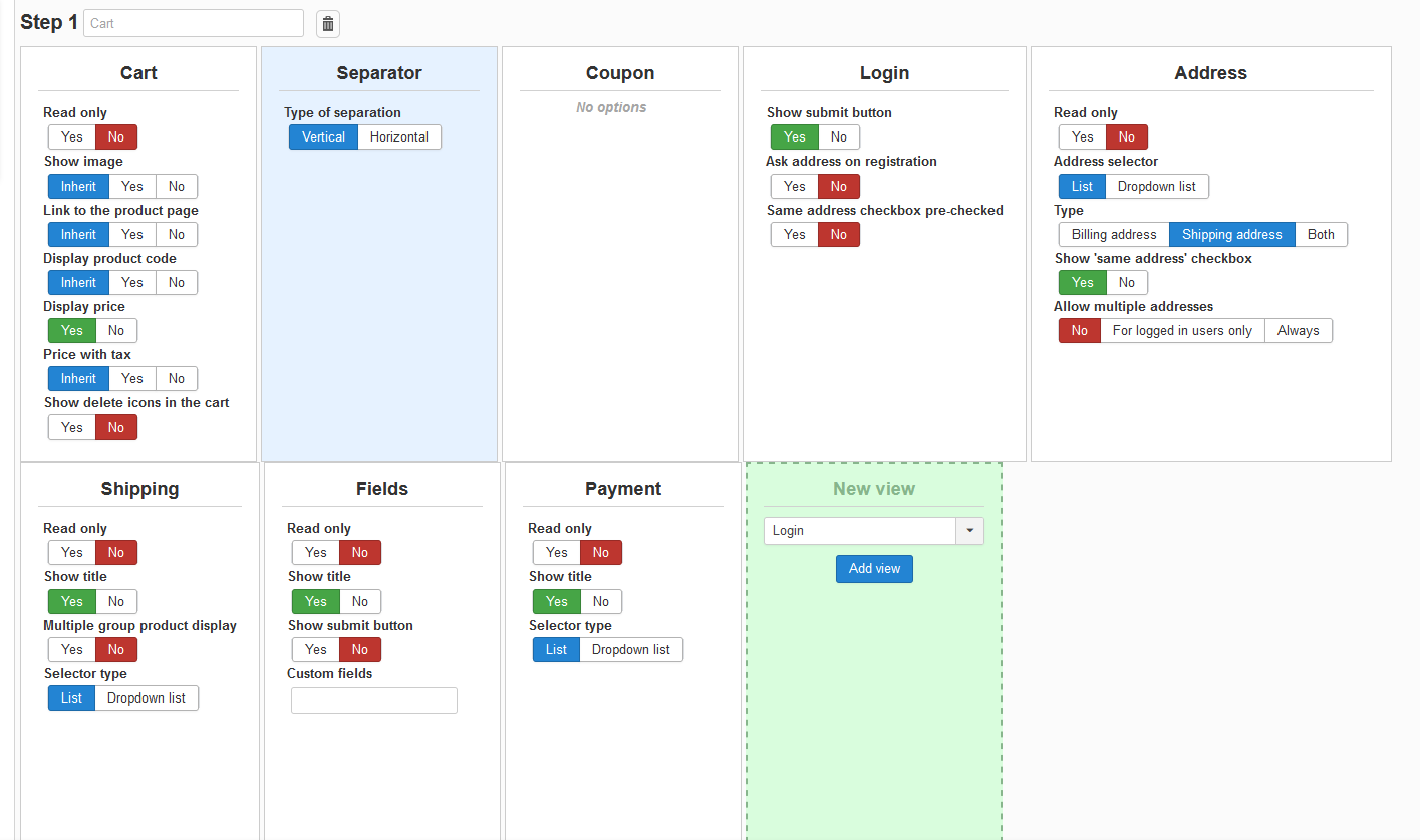

6 years 10 months ago #312350
Sorry if i was not clear enought. Let me explain.
As example i have checkout only as a guest and configured as per my screenshot attached.
When user first come to checkout he see only email input to enter, then shipping and payment methods. The address is not visible. So all is fine.
When user adds email and press submit button, the blocks are refreshed and new shipping address is asked to add. So he fills it and submits...All fine here.
After user submits address, we see guest user information, address, shipping and payment blocks. All great here too...
Now what i don't like:
1. If user press change guest information, the address is hidden ( here i would like address still be visible but with some overlay which would have css like opacity:0.5, pointers-events:none ), which basically would prevent him to edit address while changing guest information.
2. If user change hes email (maybe because of mistake), he needs to fill address again. But he only want to edit email and nothing else, so why would he need extra effort to add same address again?
3. Each time user changes hes email, the new custom is created in back-end? Wouldn't it be better to update it as the existing one. It's the same person is changing hes email, which he added like 2-4 minutes ago.... + less useless customers in back-end.
4. After checkout, if user wants to buy something again, the guest information (email) is there (which is great), but the address is empty and he must add it again?
I have investigated like 20 checkouts of high brands and this is not like for my needs, this is more for better user experience and make Hikashop even more better!
I hope you see what i mean and what i want to do/have.
Thank you
