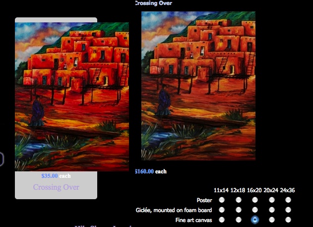

I have set-up a site that sells art prints in various sizes and types. I used variants to give customers different options and their prices.
However, in both the category listing and product displays, Hikashop lists the lowest variant price only ($35). No price range is listed, even though "Price range" is selected in the configuration for "Price display method" and prices for a given variant can go as high as $350. This could lead customers to think that a given item is priced at $35, when larger prints (variants) for the same piece can have many different (and higher) prices. (The attached image shows the category listing on the left, with the listing for the same product with a different variant price on the right.)

The price display method of of the configuration is a default setting which is used for new menus and modules. If you already had created your menu/module before setting it, it's normal that you don't see any change when switching that option.
You should go in the hikashop options of your menu/module to change that same option (they are accessible via the menu Display->content modules and Display->Content menus). You could also try to create a new menu.
