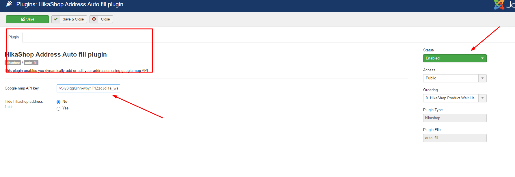

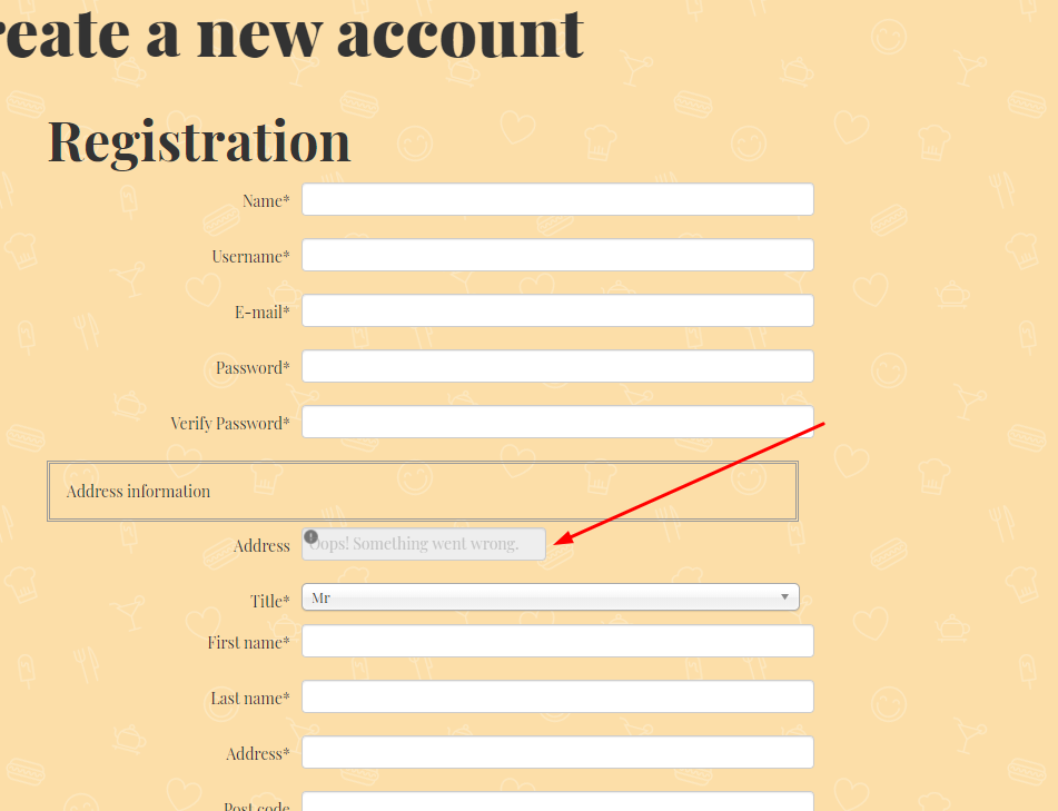

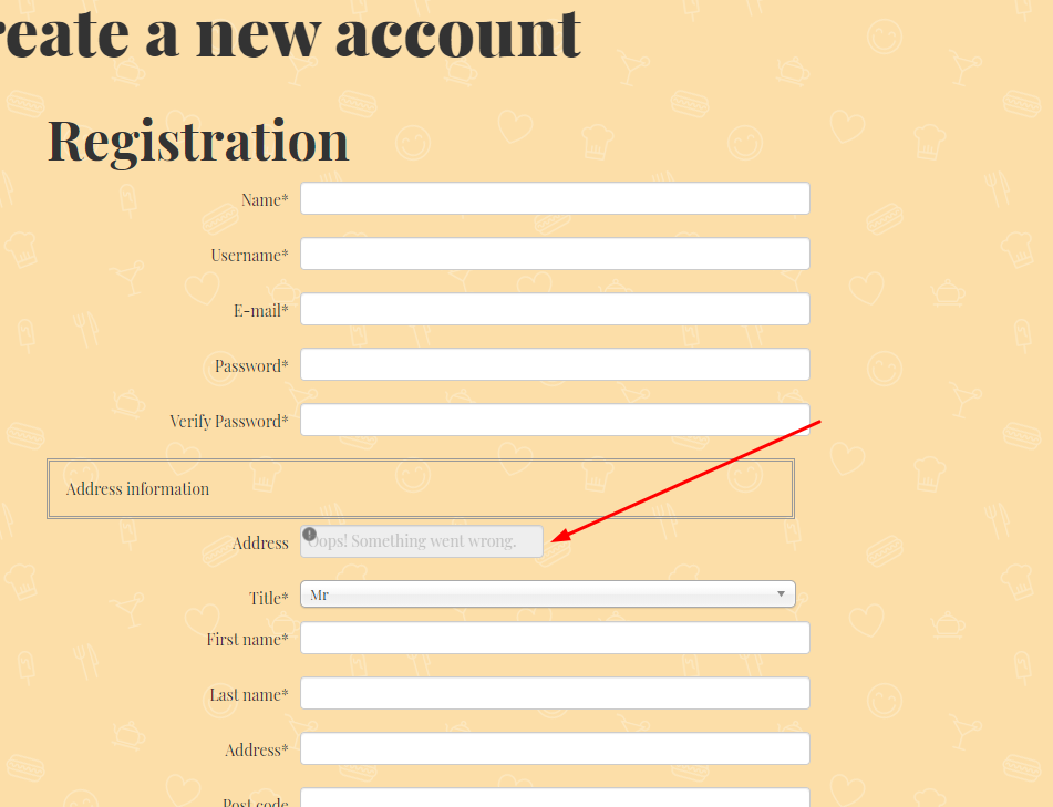

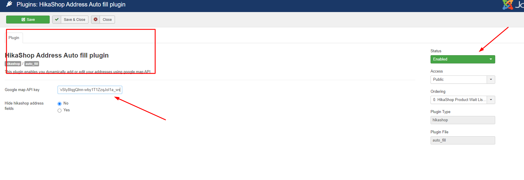

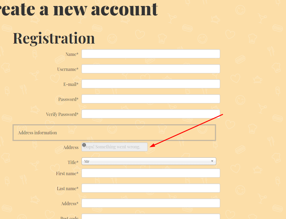

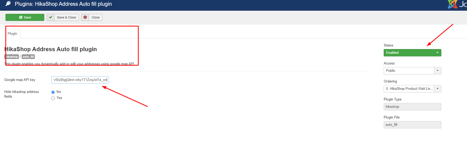

Hope all ok and doing just fine and safe during the Covid 19, I recently bought the autofill address plug in and installed it, follow all the instruction, looks works but still something not working quite right, please attachments, any hint or help appreciated, thanks

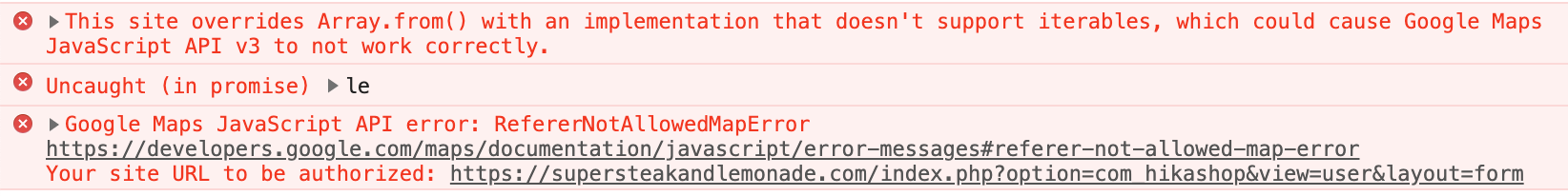

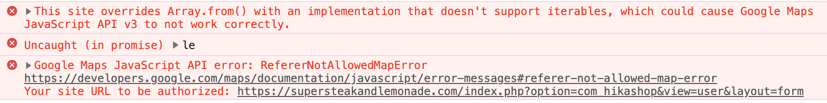

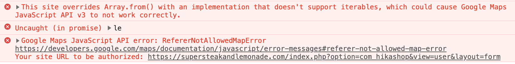

Well, it's easy to find and see: supersteakandlemonade.com/index.php?opti...iew=user&layout=form
If you look up the browser console, you'll see that there are multiple errors, most if not all caused by the Google Maps API Key setup:
First and foremost, the "RefererNotAllowedMapError" indicates that the domain or its sub-pages is not in the list of allowed ones in the Google Maps API Key settings. So, you want to correct that at Google's end, as well as double-check that the correct key has been entered in the shop site. This alone may fix the problem.

5 years 8 months ago #326648
Thanks for the hint all works perfect, would you check it again thanks
