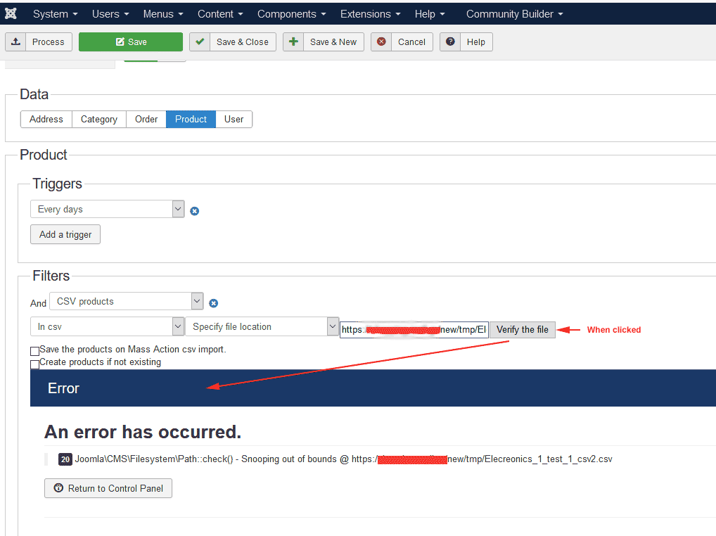

Hello
I am trying to set a Mass action for updating the products quantity with values taken from a csv. Unfortunately i am stack to a...
20 Joomla\CMS\Filesystem\Path::check() - Snooping out of bounds @ https:/my_domain.com/new/tmp/Elecreonics_1_test_1_csv2.csv
The csv file exists and it is accessible if called from browser.
issue when i click on "Verify the file" button. (Please check screenshot)
Our goal is to update only the stock value of the products from the csv. Here we also need some help as we can not find any documentation anywhere. Everything we find either does not contain a solution or is general about the csv import.
Please advise about the settings of the Mass action in order to periodicaly update the values of product_quantity column.
Thank you.

5 years 4 months ago #331639
That means that there is an error in the CSV file. I can't say what though. Could you provide a copy of that file ?

5 years 4 months ago #331661
Yes Nicolas you are right!
It was not a csv problem but a problem with the csv path that we were writing like... http://...
When we changed it to /home/account/.../csv_file.csv everything worked fine. So here comes another question now.
If the csv file is online at the server of our provider, how can we set the Mass Action to get the data from the csv? How can we use a file location like... https://url_of_provider.com/csv_file.csv?
Thank you!
