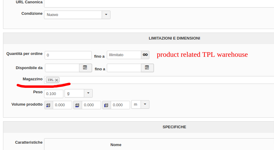

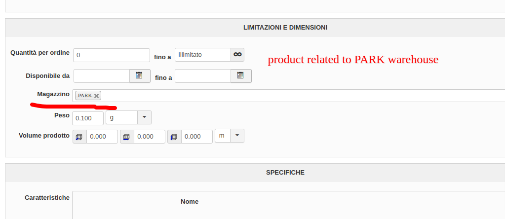

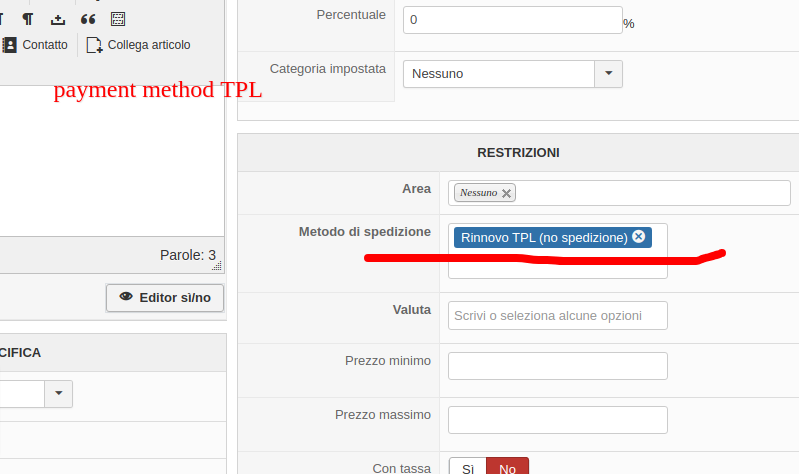

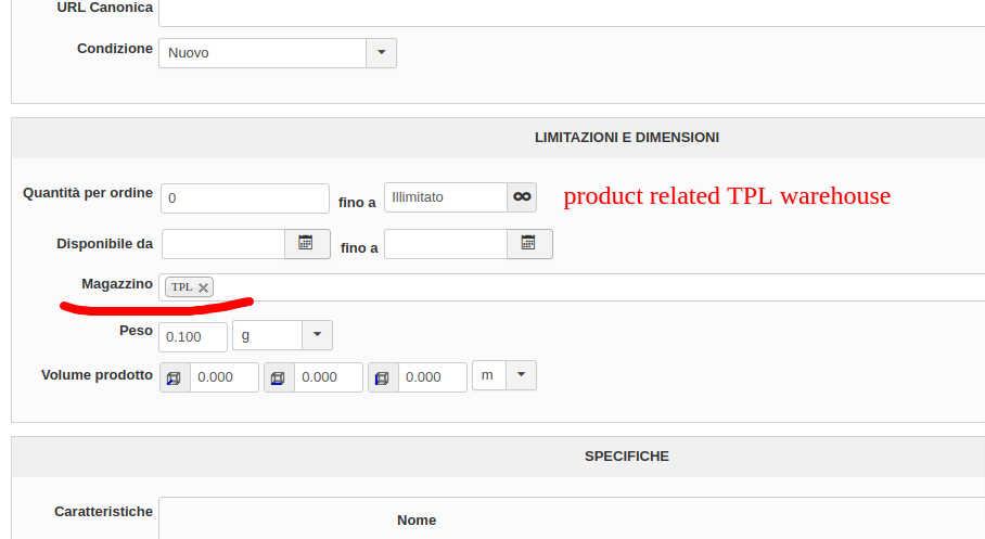

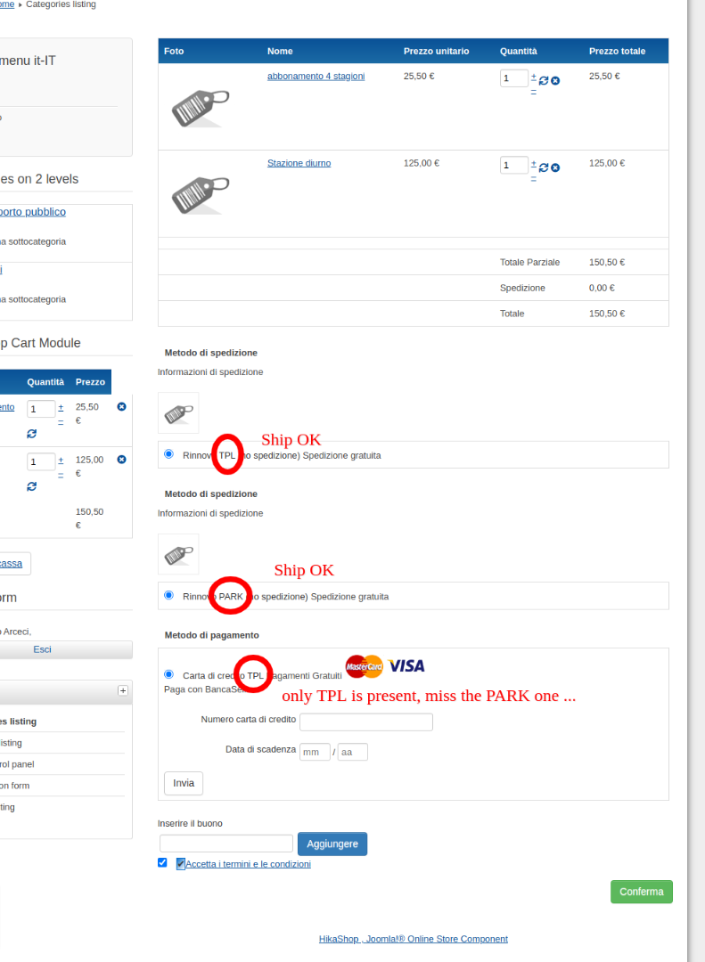

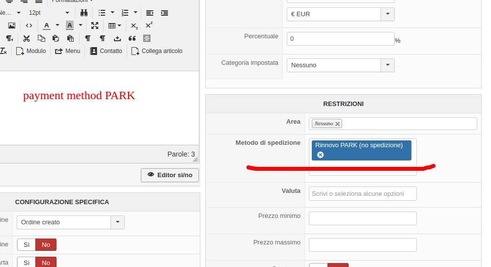

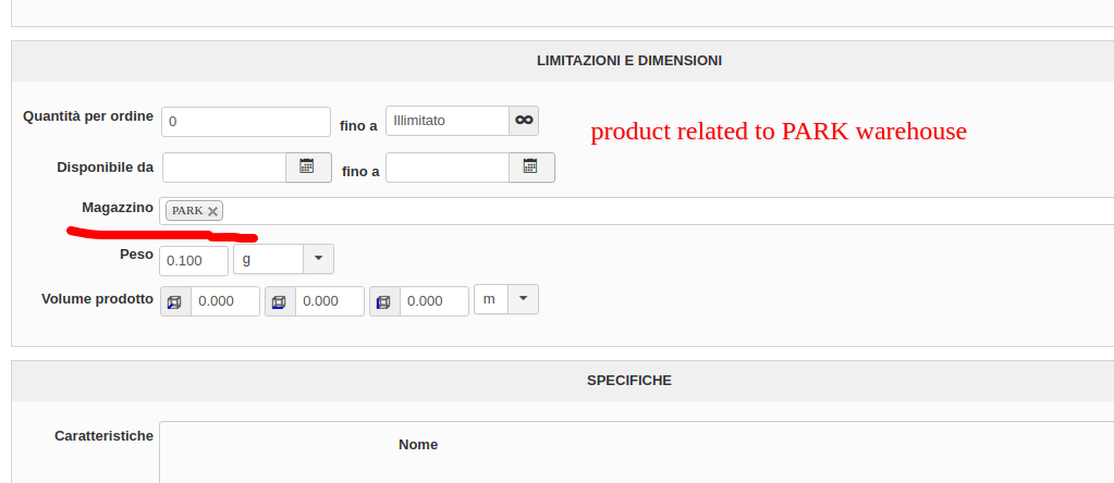

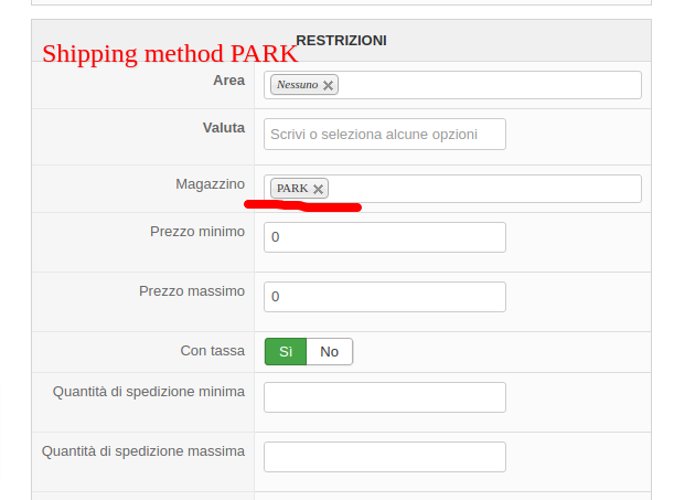

Hi there,

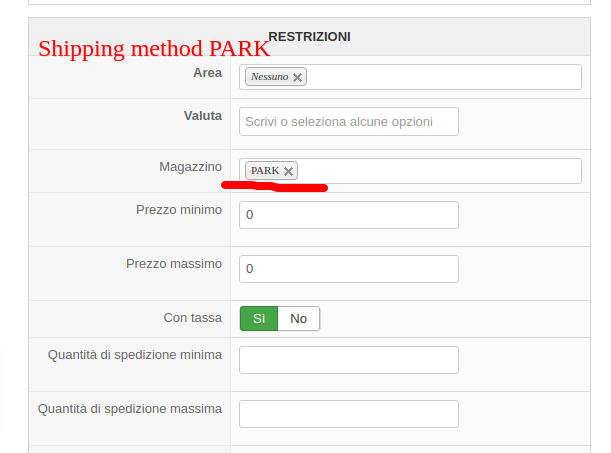

We would like to be able to have separate payment methods in the same cart, as is the case with shipping methods using the warehouse and restrictions technique.

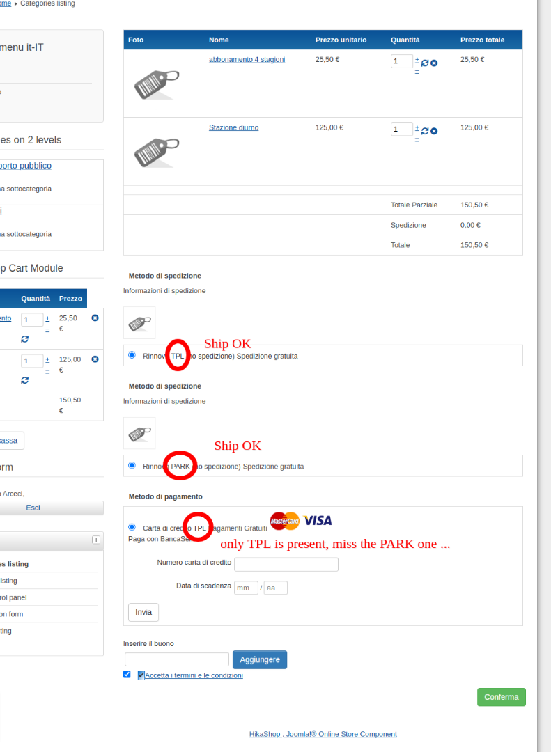

As you can see from the screenshots, products on different warehouses in the same cart have shipping methods that match the warehouse, but the payment is only one!

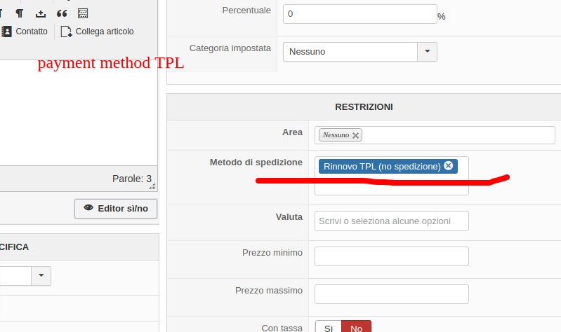

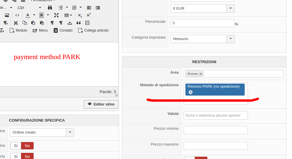

Payments have been successfully configured with the right shipping method as a restriction (following the wharehouse and so the related products).
It would be useful to have the payment method for the products in the first section along with a specific "Confirm" button.
Same scenario for the products in the second section.
When you press one of the "Confirm" buttons present in the Cart, you proceed to pay for that specific section using the payment method chosen from the possible ones in list.
At the end of payment session, it will return to the Cart with remaining products (second section), and you can proceed with the second payment.
Is it possible to achieve this result?
We have two different vendor, each with a different payment account (for credit card) and a different company name.
We would like the end user to be able to place the products of both vendor in the Cart and then make two separate checkouts.
Thank you,
  • Posts: 86183
5 years 3 months ago #333071
There is no option to do that.
With some custom development, it could be achieved. But that would cost several hundred euros to hire a developer to work on that.
However, I would recommend a cheaper and more user friendly solution:
You could use HikaMarket Multivendor ( www.hikashop.com/hikamarket-multi-vendor.html ) + Stripe Connect ( www.hikashop.com/marketplace/product/133...nect-by-obsidev.html ).
Then, each vendor could have each a merchant account with Stripe connected with your shop's main Stripe account.
Then, you can just attribute each product to the corresponding vendor and the rest is automatic. No need to use warehouse/shipping methods restrictions, the system will automatically split the order into one suborder per vendor, and it will only ask one payment from the customer, and Stripe Connect will automatically split it between the shop (if you have fees/commissions) and each vendor.
That way, each vendor will get the funds on their Stripe merchant account, which they can then transfer to their bank account independently.
