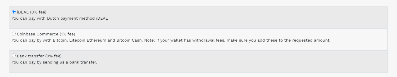

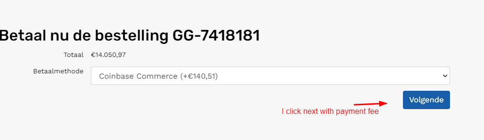

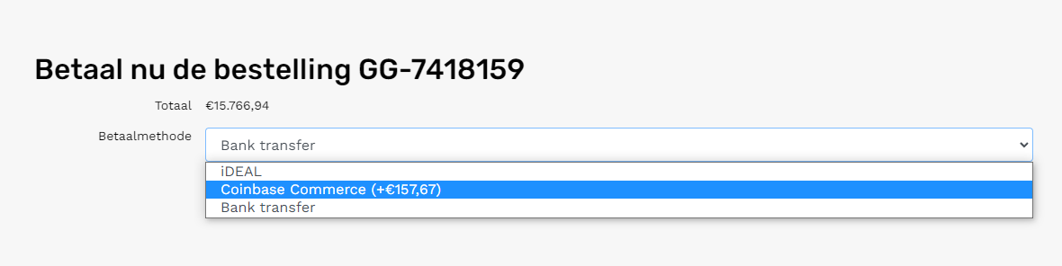

I have recently changed to show the payment fee in % instead of price shown in the attachment below(hikashop_paymentfee.png).
I came across the pay now fucntion in the order listing page and noticed on there you still see the payment fee in price instead of % as shown in the second attachment.
How do i also show the payment fee in % instead of price on the pay now page.
Thanks in advance,
Ismael
Thanks in advance,
Ismael

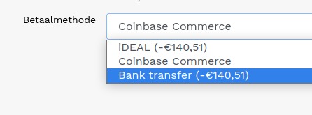

4 years 6 months ago #340401
by ismael
Replied by ismael on topic Hikashop pay now payment fee

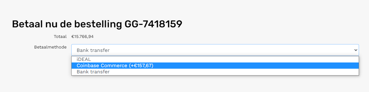

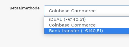

I found a bug on the pay now page.
Whenever i click pay now with a payment fee and cancel the payment by going back to last page the other payment methods price change instead of the one with a payment fee.
Screenshots in attachment if i was unclear.
Thanks,
Ismael
Thanks,
Ismael
4 years 6 months ago #340402
by nicolas
Replied by nicolas on topic Hikashop pay now payment fee

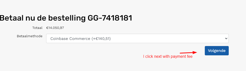

The payment method without a + or - fee is the one selected in the order. So its fee is included in the total of the order.
The + or - fee of the other payment methods is the difference it will make if you switch to the other payment methods.
So on your first screenshot, you have a total 14050.97€ with another payment method.
And you selected coinbase which adds +140.51€ to the order.
On your second screenshot, you must have a total of 14050.97 + 140.51 = 14191.48€ with the coinbase payment method selected.
And if you switch to iDeal or bank transfer, it will remove these 140.51€ that were previously added to the total.
