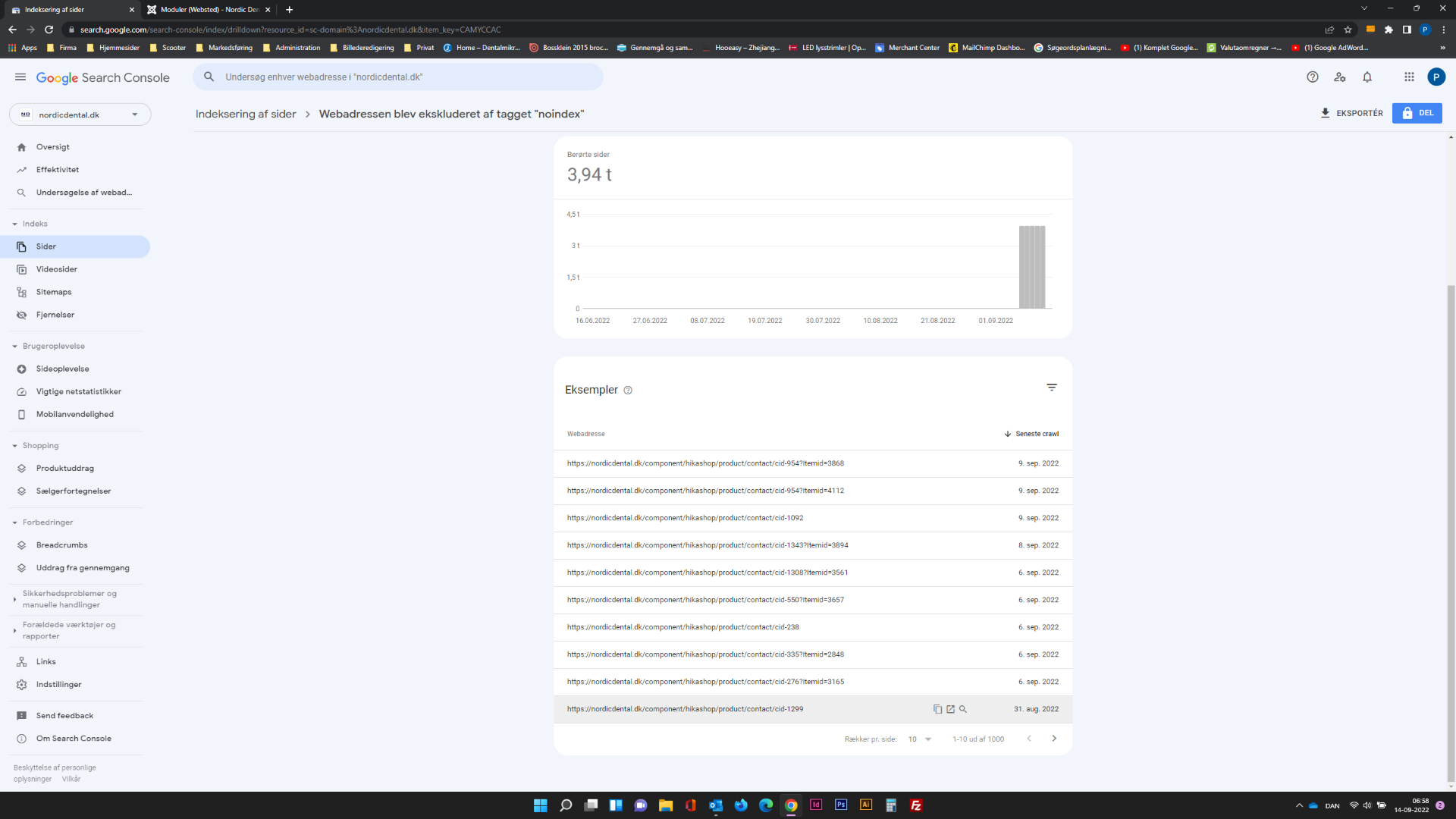

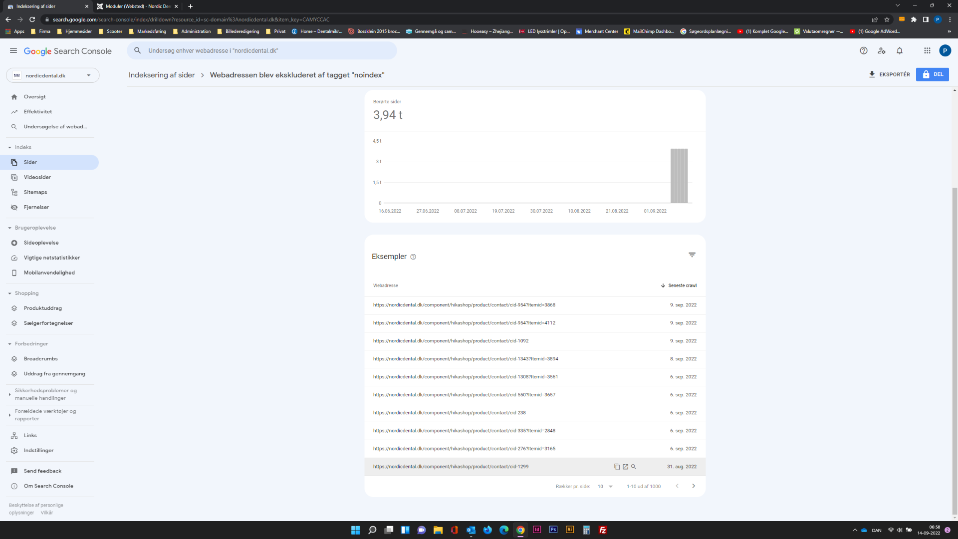

4 years 2 months ago #344654 by Peter Kjeldsen
Please see photo.
4 years 2 months ago #344660 by nicolas
Replied by nicolas on topic Photos in center of frame
I don't see any errors there.
It's just a list of the noindex URLs. And that's normal you see the contact form pages there as you don't want them to be indexed for each product.
So there's nothing to worry.
