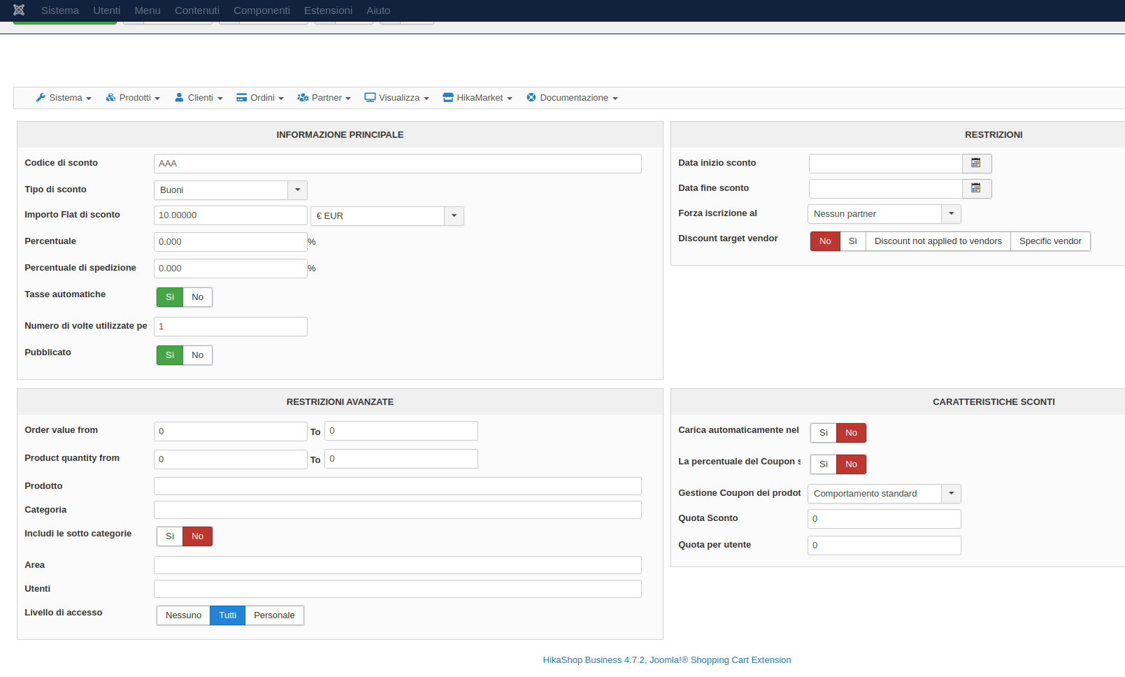

  • Posts: 53
3 years 3 months ago #351339
sorry but i cannot get it!
here is my website 93.65.142.236:22080/joomlabresciarevamp2021
user: This email address is being protected from spambots. You need JavaScript enabled to view it.
pwd: cv56py
go to cart and chekcout
plugin is active, try to add coupon AAA (see attached screenshot) nothing appends
thank you
