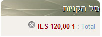

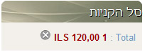

My site is in Hebrew (RTL).
The numbers in the cart are displayed as hundreds and then the thousands come.
the image attached should show 1120,00 and not 120,00 1.
Also, while we are at it - how do you get rid of the fractions (the ,00).
Thanks!

You can remove the fractions by changing the formatting of your currency (by setting both fractional digits options to 0 ) in the currency edition screen via the menu System->Currencies. You will also be able to remove the space (by increasing the "Digits groups" option) in your currency formatting so that the price isn't RTLed:
www.hikashop.com/support/documentation/i...ncy-form.html#locale

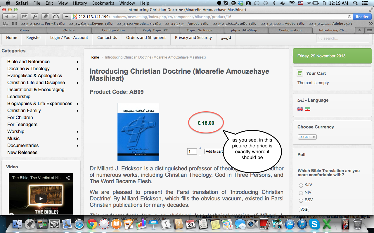

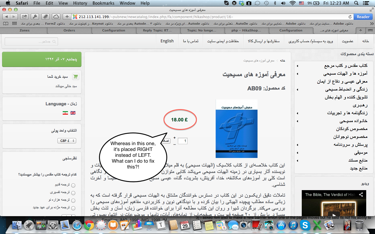

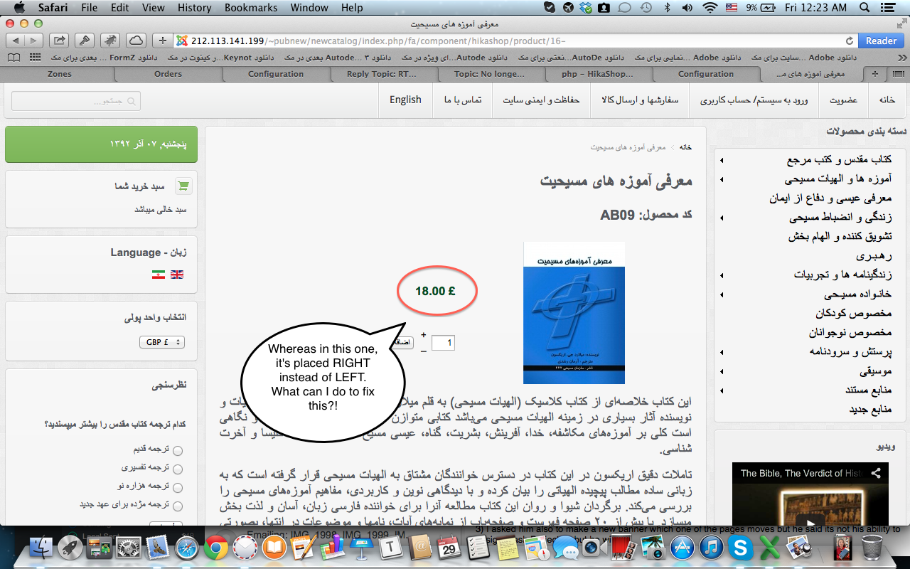

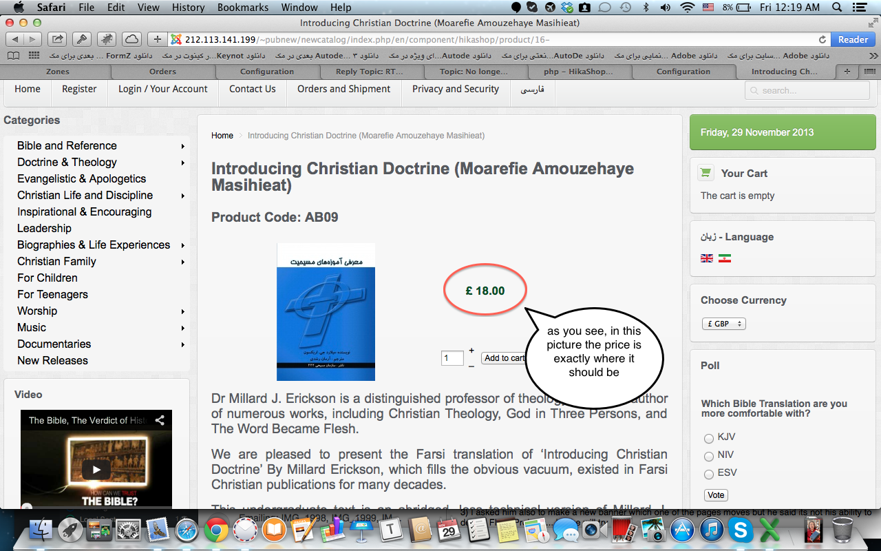

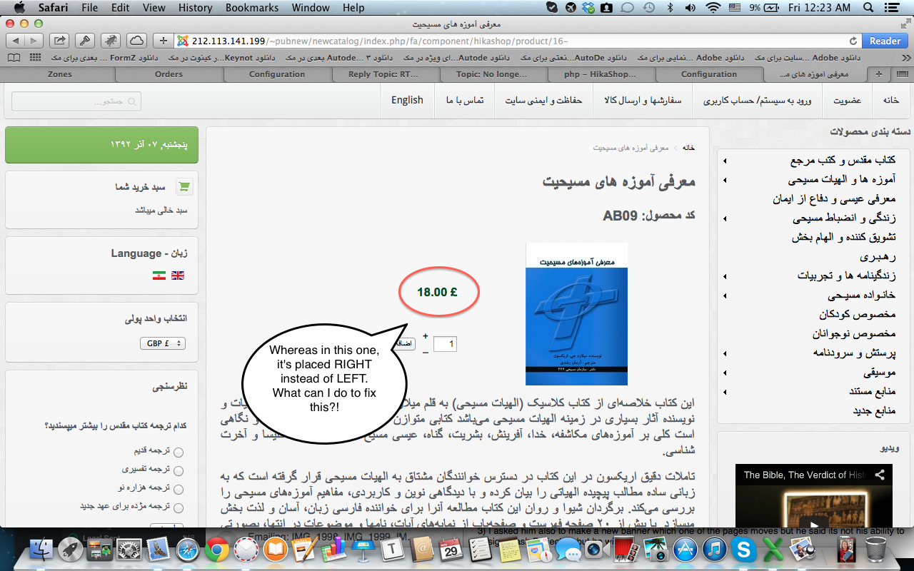

I still have a problem though.. in the link : 212.113.141.199/~pubnew/newcatalog/index...yahova-ra-beshenasim as you can see everything is fine and working correct. but when you click on the IRAN flag for Farsi, you see that the currency symbol is RTLed and I don't want it to be, I want it to be shown exactly like the one in English.. how can I stop this from happening?

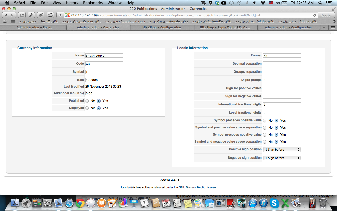

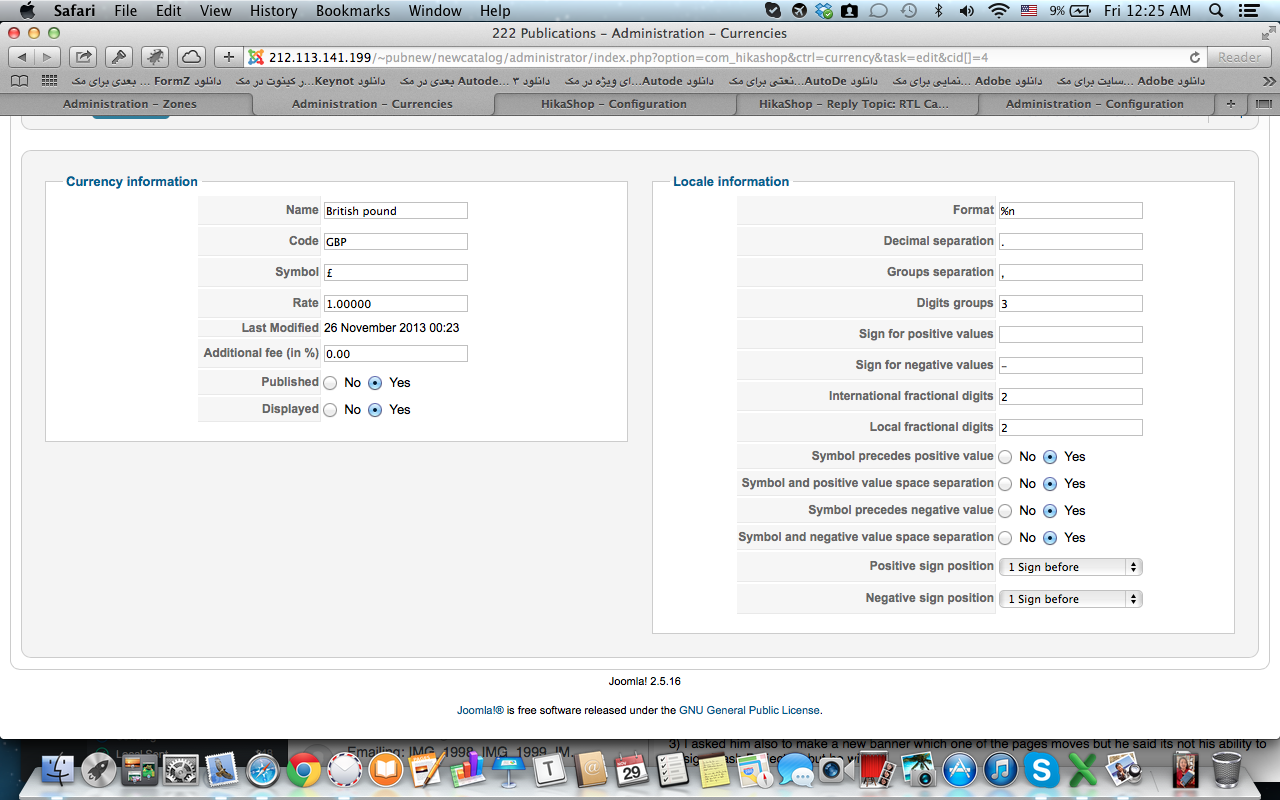

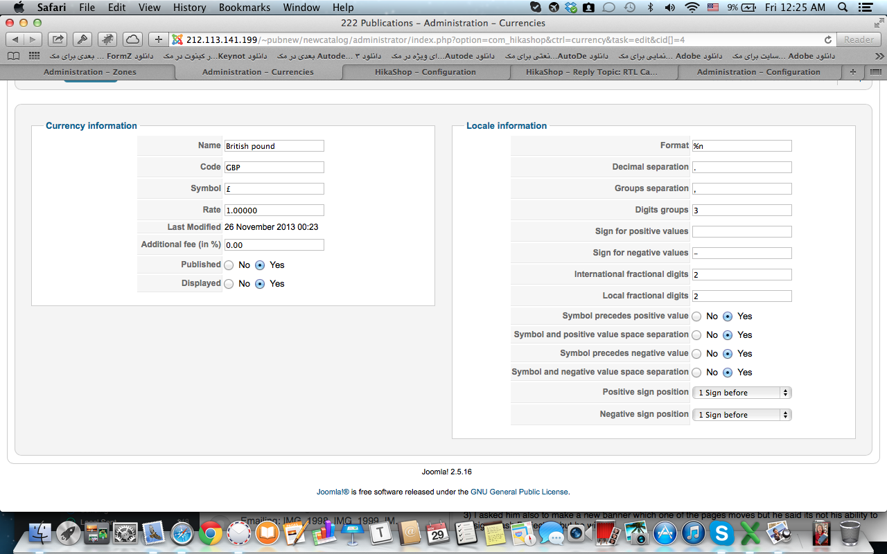

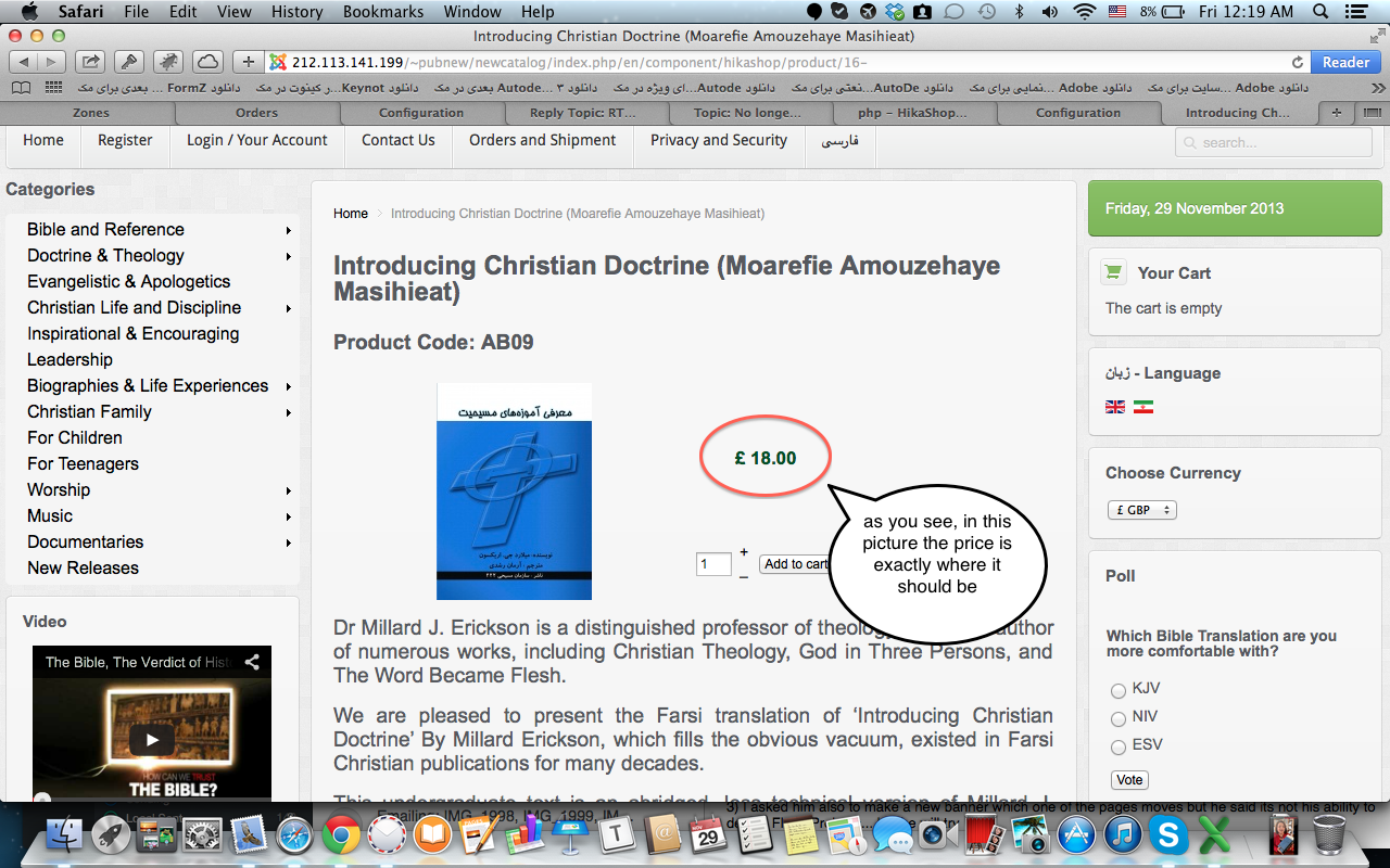

Sure! thanks for your response. I've attached 3 pictures that will tell you all you need to know about my problem. Thanks for your help in advance.

You need to turn off the "symbol and positive value space separation" option of your currency.
