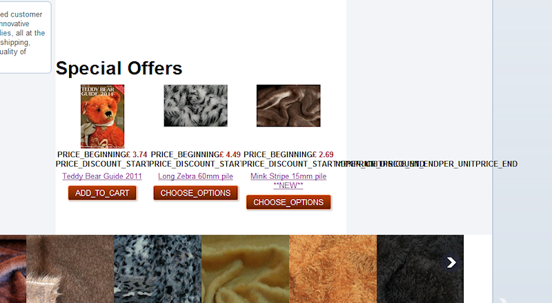

Can you point me in the right direction to solve this issue, the code shows instead of text, its a hikashop module

  • Posts: 86180
15 years 1 month ago #21656
If you have that problem everywhere on your website, it means that the translation file is missing, and if you're website is in english, you should make sure that the file languages/en-GB/en-GB.com_hikashop.ini is there.
Otherwise, I don't know. Please give more information. The version of hikashop and joomla, the URL of that page and how you're displaying your module, etc.

15 years 1 month ago #21660
Hi, I have worked out whats wrong, if the module is below the language module it errors, when above it's ok, I have mover the language module to the left now so no conflict.

[url=http://www.mohairbearmakingsupplies.co.uk[/url]
sorry check out this link to see.
  • Posts: 86180
15 years 1 month ago #21665
So that means that the language module modify the language code of the page and then your hikashop module doesn't find the other language file anymore.
If it works after moving the modules it means the now the hikashop module is displayed before that language module on the page.
