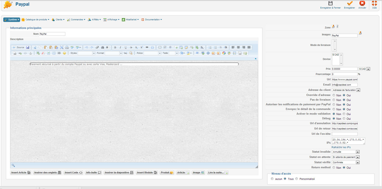

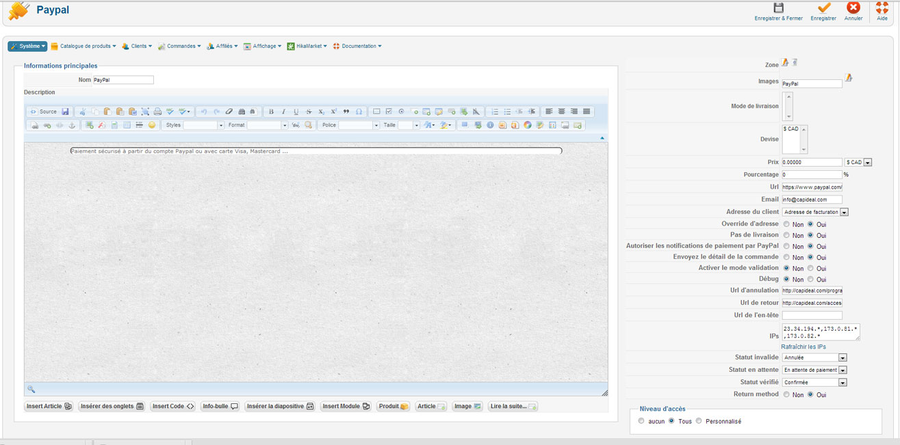

  • Posts: 91
13 years 6 months ago #92002
c'est déjà le cas
voir copie d'ecran
  • Posts: 91
13 years 6 months ago #92003
c'est déjà le cas
voir copie d'ecran
Last edit: 13 years 6 months ago by ces.
13 years 6 months ago #92028
Je pense que vous trouverez surement votre réponse ici :
Do you receive an email when the payment notification is received ?
If yes, then you should check the email message and that documentation: www.hikashop.com/en/support/documentatio...nt-paypal-error.html
If no, the it means that HikaShop is not triggered. In such cases you need to check:
Do you have any security component which could block the paypal notification ? If yes, turn it off and try again.
Do you have a system plugin which redirects URLs ? You can try to unpublish the different system plugins via the joomla plugins manager and try again to identify which plugin is causing the problem.
Do you have SEF activated or a SEF component installed ? If yes, you can try to deactivate it and see if that works.
You can also look at the tab "files" of the configuration for the path of the payment log file so that you can open that file and see what HikaShop wrote in that file.
