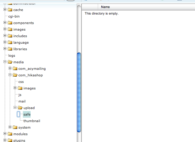

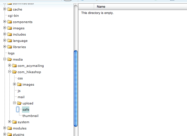

Could you activate the debug mode of your payment plugin and try again. Then, via FTP, retrieve the payment log file (the location is indicated in the option "Payment log file", under the tab files of the configuration) and upload it in your next post ?
  • Posts: 136
15 years 4 months ago #11858
I've gone through that procedure and have found that there are no contents in the safe directory. Screen shot attached.
