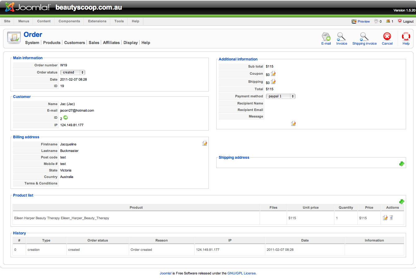

In the control panel ? There is a dropdown to change an order's status on the orders/sales page and on the order page itself, but not in the control panel.
Could you do a screenshot before the error and after the error so that we can see where you are and what you're going to get that error ?
  • Posts: 136
15 years 6 months ago #8043
I've tried changing the status from both areas I believe. Screen shots to follow.....

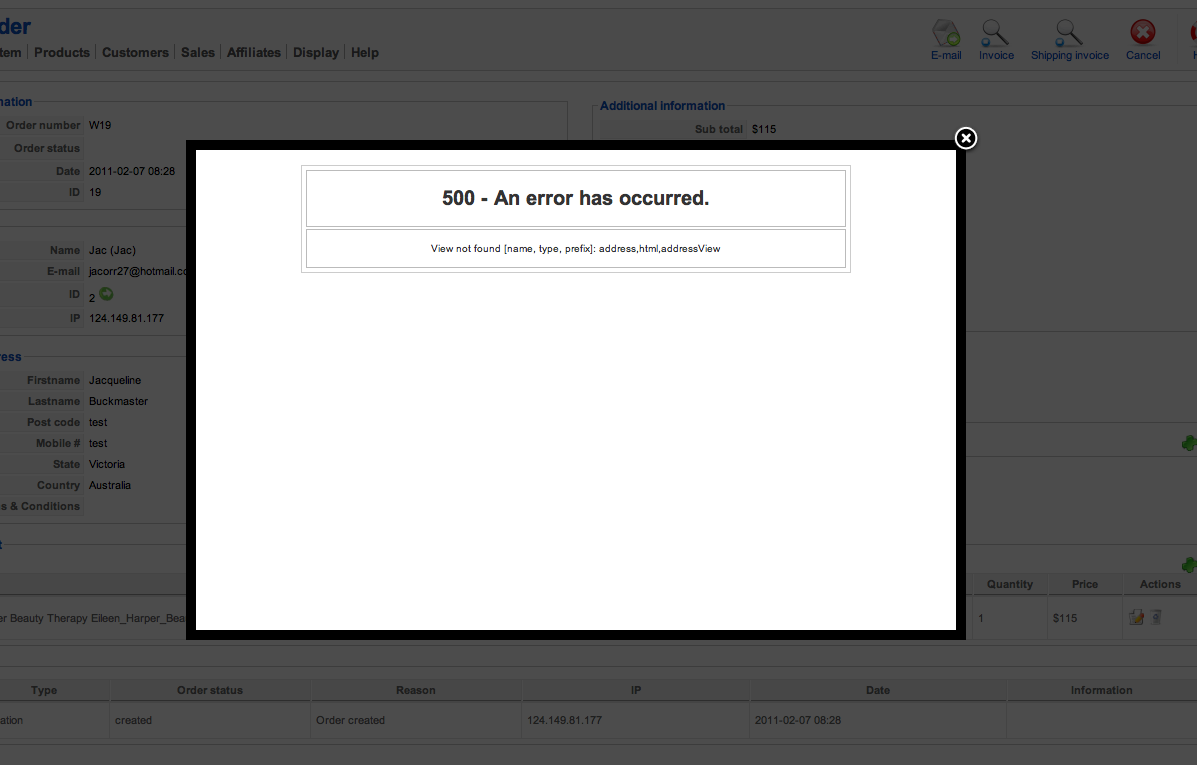

15 years 6 months ago #8044
Error message when changing the order status field

The problem came from the email customization you made. Copy/paste from the other email notification is not enough as there is some data which is different between both emails. I went there and fixed your email.
So, for any one wanting to customize the status notification so that it sends the full order details, I attached the code to use in that post
