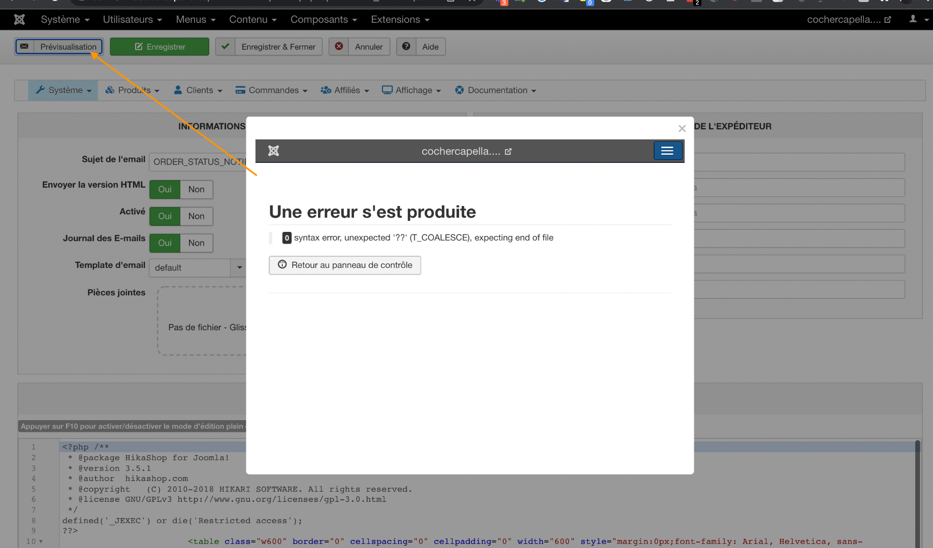

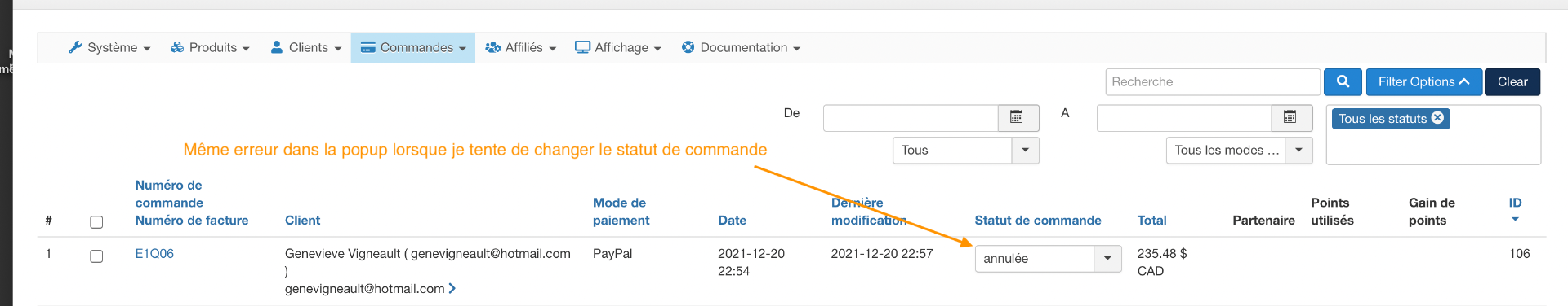

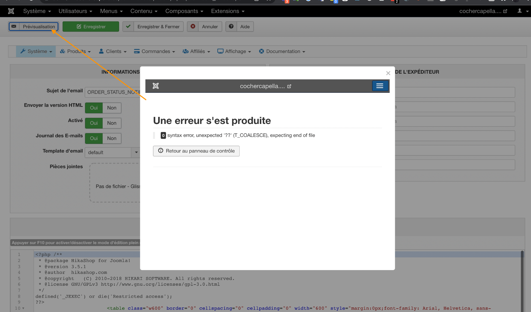

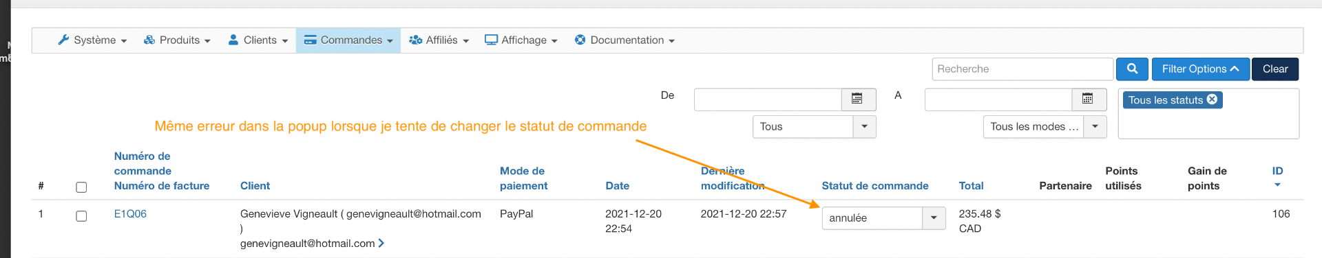

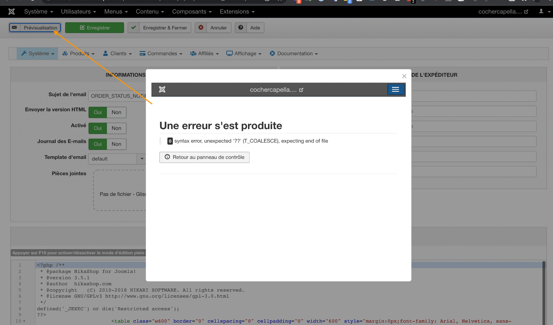

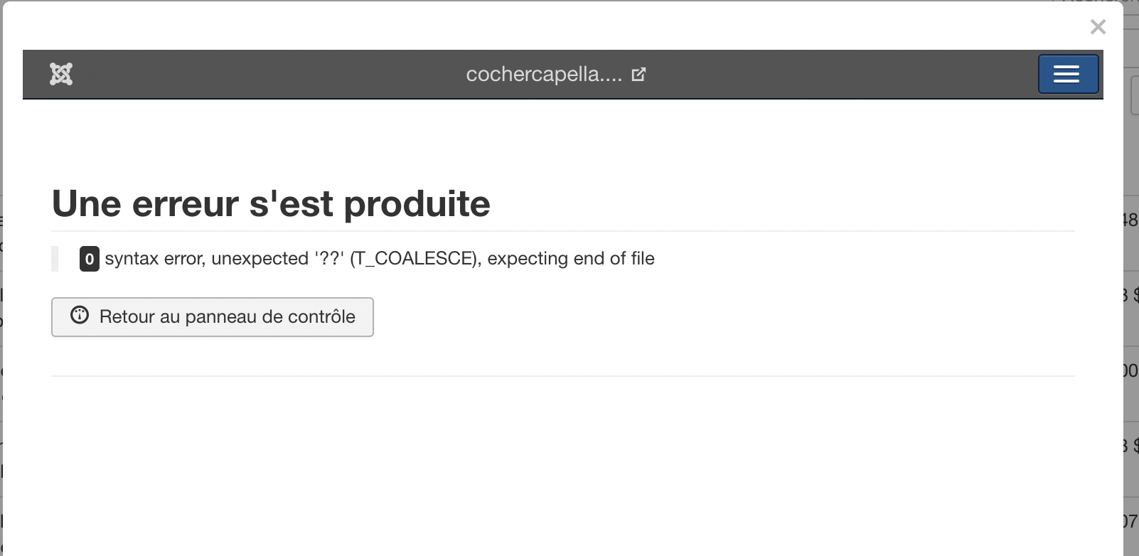

Lorsqu'on tente de changer le Statuts de commande dans la section admin de gestion des Commandes, on obtient cette erreur:
0 syntax error, unexpected '??' (T_COALESCE), expecting end of file
Même chose dans la page d'édition des emails lorsqu'on clic sur Prévisualisation.
Avez-vous une idée de la cause et de la solution? Merci,
Édition Statut Commande:
Prévisualisation email:

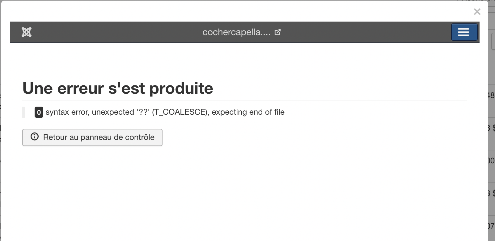

Voic l'erreur que je reçois avec l'option debug à ON:
Une erreur s'est produite
/home/customer/www/dev2021.cochercapella.ca/public_html/administrator/templates/isis/html/com_hikashop/order/address_template.php:9
Call stack
# Function Location
1 () JROOT/administrator/templates/isis/html/com_hikashop/order/address_template.php:9
2 Joomla\CMS\MVC\View\HtmlView->loadTemplate() JROOT/administrator/components/com_hikashop/helpers/helper.php:2616
3 hikashopView->loadTemplate() JROOT/libraries/src/MVC/View/HtmlView.php:230
4 Joomla\CMS\MVC\View\HtmlView->display() JROOT/administrator/components/com_hikashop/helpers/helper.php:2571
5 hikashopView->display() JROOT/administrator/components/com_hikashop/views/order/view.html.php:30
6 OrderViewOrder->display() JROOT/administrator/components/com_hikashop/helpers/helper.php:864
7 hikashop_getLayout() JROOT/administrator/components/com_hikashop/classes/address.php:152
8 hikashopAddressClass->displayAddress() JROOT/media/com_hikashop/mail/order_status_notification.preload.php:500
9 include() JROOT/administrator/components/com_hikashop/classes/mail.php:360
10 hikashopMailClass->loadEmail() JROOT/administrator/components/com_hikashop/classes/mail.php:31
11 hikashopMailClass->get() JROOT/administrator/components/com_hikashop/classes/order.php:1968
12 hikashopOrderClass->loadOrderNotification() JROOT/administrator/components/com_hikashop/classes/order.php:1927
13 hikashopOrderClass->loadNotification() JROOT/media/com_hikashop/mail/order_status_notification.preview.php:20
14 order_status_notificationPreviewMaker->prepareMail() JROOT/administrator/components/com_hikashop/views/email/view.html.php:303
15 EmailViewEmail->preview() JROOT/administrator/components/com_hikashop/views/email/view.html.php:23
16 EmailViewEmail->display() JROOT/libraries/src/MVC/Controller/BaseController.php:664
17 Joomla\CMS\MVC\Controller\BaseController->display() JROOT/administrator/components/com_hikashop/helpers/helper.php:2308
18 hikashopController->display() JROOT/administrator/components/com_hikashop/controllers/email.php:103
19 emailController->preview() JROOT/libraries/src/MVC/Controller/BaseController.php:702
20 Joomla\CMS\MVC\Controller\BaseController->execute() JROOT/administrator/components/com_hikashop/helpers/helper.php:2286
21 hikashopController->execute() JROOT/administrator/components/com_hikashop/hikashop.php:73
22 require_once() JROOT/libraries/src/Component/ComponentHelper.php:402
23 Joomla\CMS\Component\ComponentHelper::executeComponent() JROOT/libraries/src/Component/ComponentHelper.php:377
24 Joomla\CMS\Component\ComponentHelper::renderComponent() JROOT/libraries/src/Application/AdministratorApplication.php:101
25 Joomla\CMS\Application\AdministratorApplication->dispatch() JROOT/libraries/src/Application/AdministratorApplication.php:159
26 Joomla\CMS\Application\AdministratorApplication->doExecute() JROOT/libraries/src/Application/CMSApplication.php:225
27 Joomla\CMS\Application\CMSApplication->execute() JROOT/administrator/index.php:51
Retour au panneau de contrôle
  • Posts: 86058
  • Thank you received: 14181
4 years 7 months ago #338122
D'après le message, l'erreur est sur la 9ième ligne du code que vous avez pour l'option "format d'adresse" dans l'onglet Passage en caisse de la configuration.
