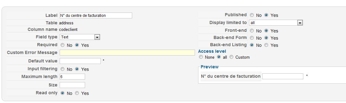

I know there is no option for that. That is why I was proposing it under commercial jobs. I am looking for someone to take this on as a commercial job. I have attached a screenshot of the field settings.

Try like that:
echo $this->fieldsClass->display($oneExtraField,$this->$type->$fieldName,'data',false,' '.$onWhat.'="if(this.id==\'codeclient\' && (!(!isNaN(parseFloat(this.value)) && isFinite(this.value)) || this.value.length!=6)){ alert(\'this field must be a number of 6 characters\'); this.value=\'\'; return false;} hikashopToggleFields(this.value,\''.$fieldName.'\',\''.$type.'\',0);"'); ?>
From the tests I could do on your website, that one is working.
