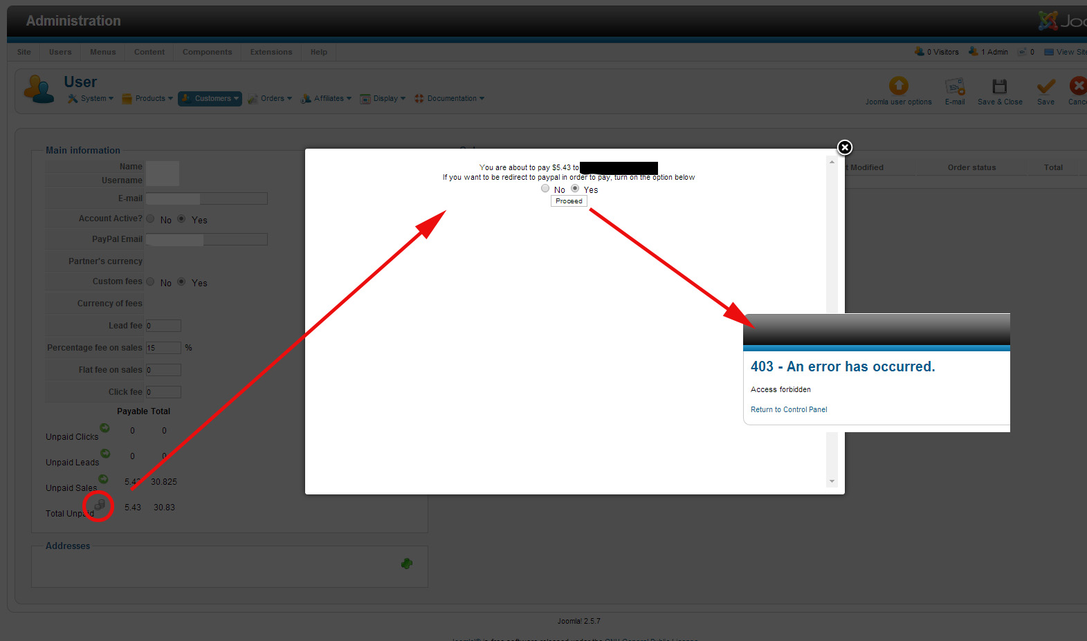

I am trying to pay an Affiliate, but there are two issues, one serious.

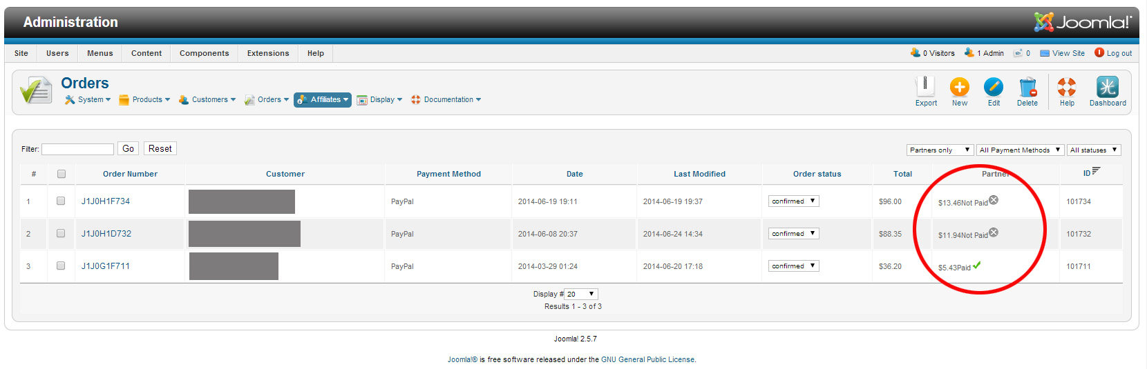

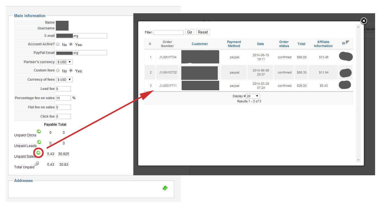

First - is there a way to pay all unpaid amounts at once or can you only pay one affiliate order at a time? I'm using PayPal for all transactions. (See 1st screenshot.)

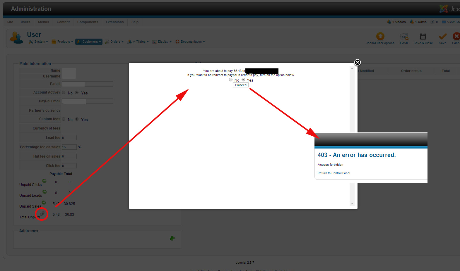

Second - when I click on the coin icon to pay an Affiliate for a single order, I get an error - see 2nd screenshot. Even though I get the error and cannot be redirected to PayPal to complete payment, I receive a "New Order Created" email saying I have paid this affiliate.
Please advise soon - I need to pay my affiliates asap and need to know how to resolve the error.

1. You can only pay one partner at a time.
2. The error you have indicates that you have an old version of HikaShop with a bug. A simple solution would be to update HikaShop to the latest version.
As a quick fix, you can edit the file administrator/components/com_hikashop/controllers/user.php and add the line:
$this->modify_views[]='pay'; if you don't have it in the function __construct at the beginning of the file.

Thank you for the quick reply. I checked the user.php file you referenced, and already had that line of code under function_costruct. My current version of HikaShop is 2.0.0 but I will have to pay in order to upgrade to the newest version. Is there any other temporary fix that you know of until I am able to upgrade?
  • Posts: 86101
  • Thank you received: 14203
12 years 2 months ago #161494
Make sure that you also have these lines at the same place:
		$this->modify[]='pay_confirm';
		$this->modify_views[]='pay_process';

Many, many thanks! That fixed it. I was missing the last pay_process line.

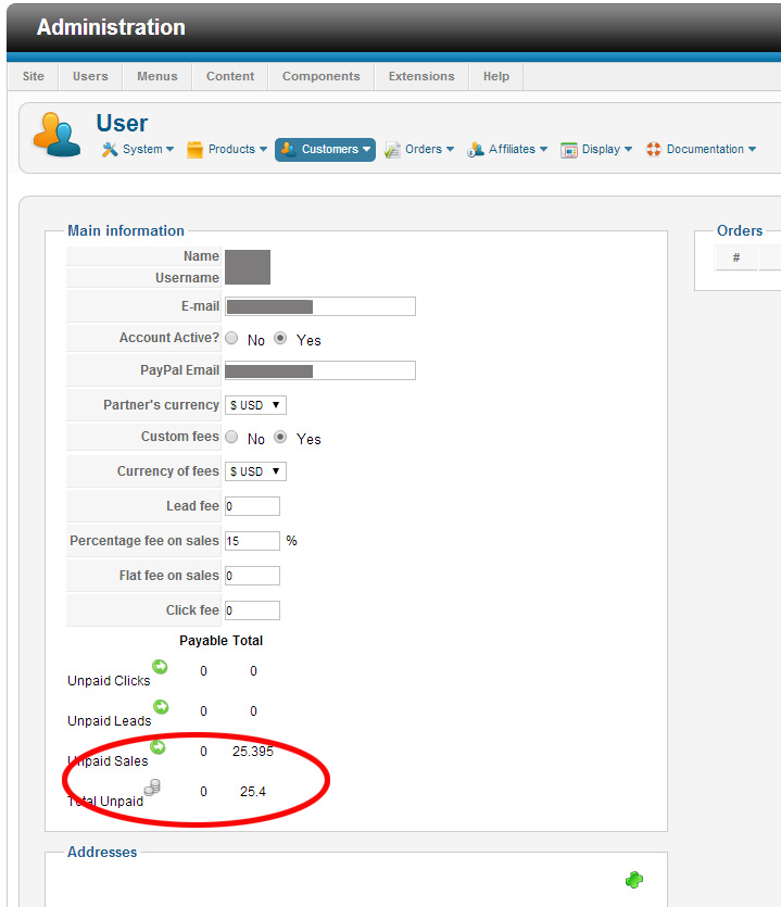

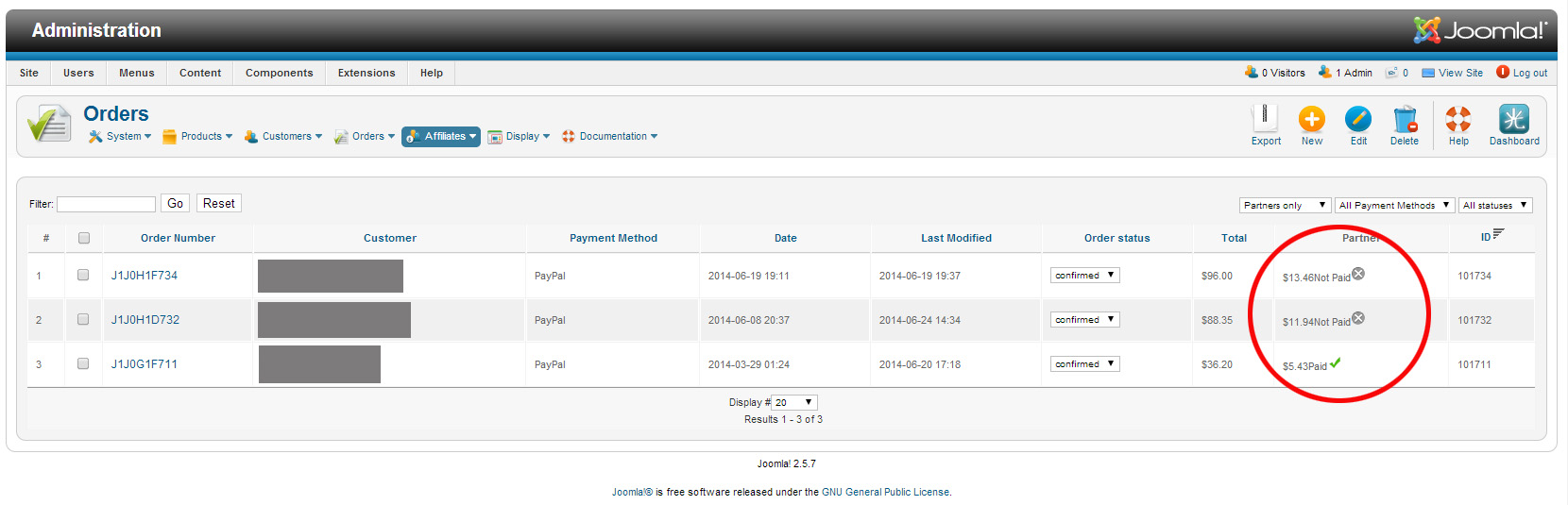

A new Affiliate question: I had three orders that required an Affiliate payment. I have now successfully sent a PayPal payment for the first order in the que, but now I cannot figure out how to pay the next order, since nothing is appearing in the "Total Unpaid" field (see screenshot). It shows I owe money but does not provide me a way to submit a payment, i.e. the little coin icon is grayed out/disabled, and the list of orders to the right is empty. If I go to the Orders menu, I can see a list of orders that still require payment, but for some reason this list doesn't also appear Affiliates>Partners section.
Thoughts?

That's because the delay to pay the fee has not been reached. See the option "Minimum delay before paying the affiliate commission" of the configuration.
