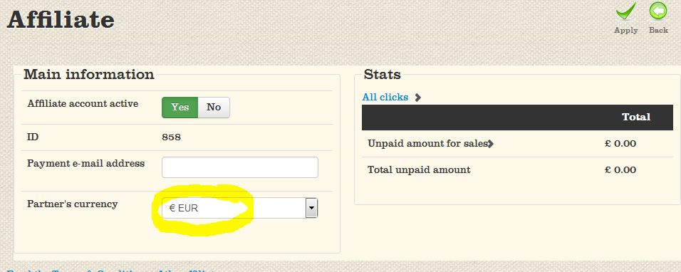

My shop main currency is set to GBP
On the partner / affiliate pages the currency defaults to euro, and if you change it to GBP it goes back to euros

I'm not sure about which page you're talking about. Could you provide a screenshot so that we can better understand ? (don't hesitate to blur sensitive information).

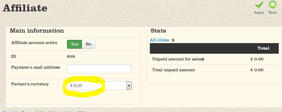

If you go into your user account and the affiliate section through the front end, as in the screenshot below the currency defaults to euro even though my shop's main currency is GBP. If I change it to GBP and click apply it comes back to euro.

I tried on my end with the latest version and the changing of the currency is working just fine for me.
Could you provide a link to the affiliate program page, a test user account, a backend access and a FTP access so that we can analyze the issue ?
