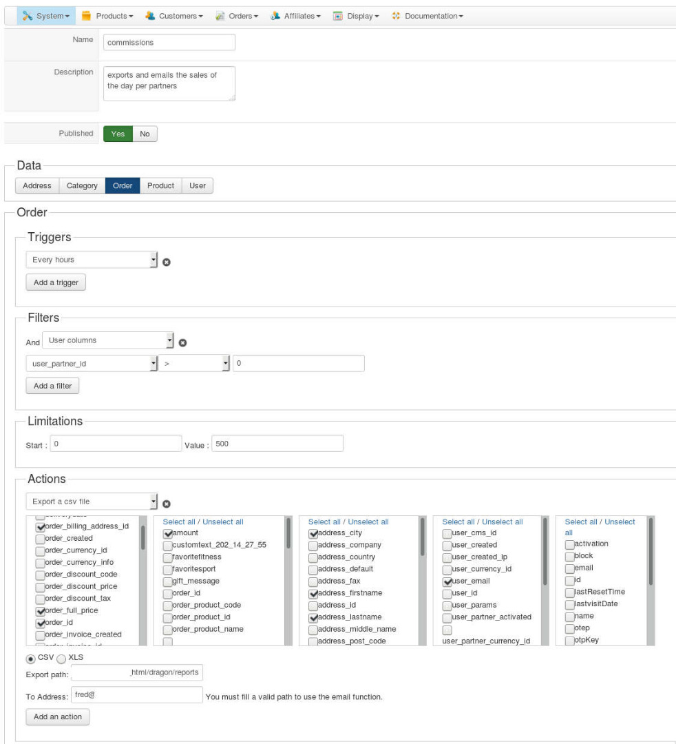

9 years 8 months ago #259637
Hi!
Actually I have the same problem when running the cron job from my server as I'm giving the "public" URL. I'm working on fixing that but this is a minor issue which either way should be fixed once the export works :-)
Now I am attaching the screenshot of my mass action. I initially tried without email and path and got nothing, now I have a valid path and email and while I am receiving an email telling me "Fichier CSV de l'action de masse" the whole message is empty and has no attachment. There is also no file in the setup directory configured on the server.
The cron report (as I can run it manually) says:
"HikaShop lancé le 2017-01-16 08:35
---- Details ----
Taux mis à jour avec succès"
So I must obviously be missing something (as always) but still wondering what :oops:
Thank you for your patience.
ps: I've noticed you can actually display the result on screen. So I tried, I selected all the fields and am only getting this with data in:
order_billing_address_id order_created order_currency_id
2 Tuesday, 03 June 2014 EUR
Of course all the fields appear since I selected them but they seem empty. I have however done some testing in November / December and since there is an order from 2014 I would think the more recent orders would appear too.
I also change the saving path from my server path (set up on the screenshot) to a web related path, current reports. I tried both reports and /reports and still get nothing, though the directory is writeable.
I hope those extra info will help to clear out the issue.
Thank you again.
ps 2: and since I had to wait for your response, I tried without having an email and directory set up. This time Hikashop offered to download the file and all the data are in that file! Yeah... so now how do I do to get it automatically either by email or saved on the disk?
Last edit: 9 years 8 months ago by bfred.
  • Posts: 86187
9 years 8 months ago #259678
So if you get the CSV with all the data when you manually process it, it's a good first step.
At least the data is being loaded correctly.
First, you want to check that your cron task is working:
www.hikashop.com/support/documentation/5...cron-task.html#check
Once you know it is working, it means that every hour, the system will run the mass action.
For the email to be sent with the CSV file, both a valid path and a valid email address need to be filled.
Make sure that you provide a valid path like: /path/to/my/website/myexport.csv
Also make sure that the mass action notification email is enabled in the menu System>Emails.
  • Posts: 94
  • Thank you received: 4
9 years 8 months ago #259744
Hi again...
And here it is... the path is actually supposed to include the filename! Bugger! That was my mistake... I just put the path thinking Hikashop was picking the filename.
Ok, so all is well in the hikashop world again.
Thank you very much.
