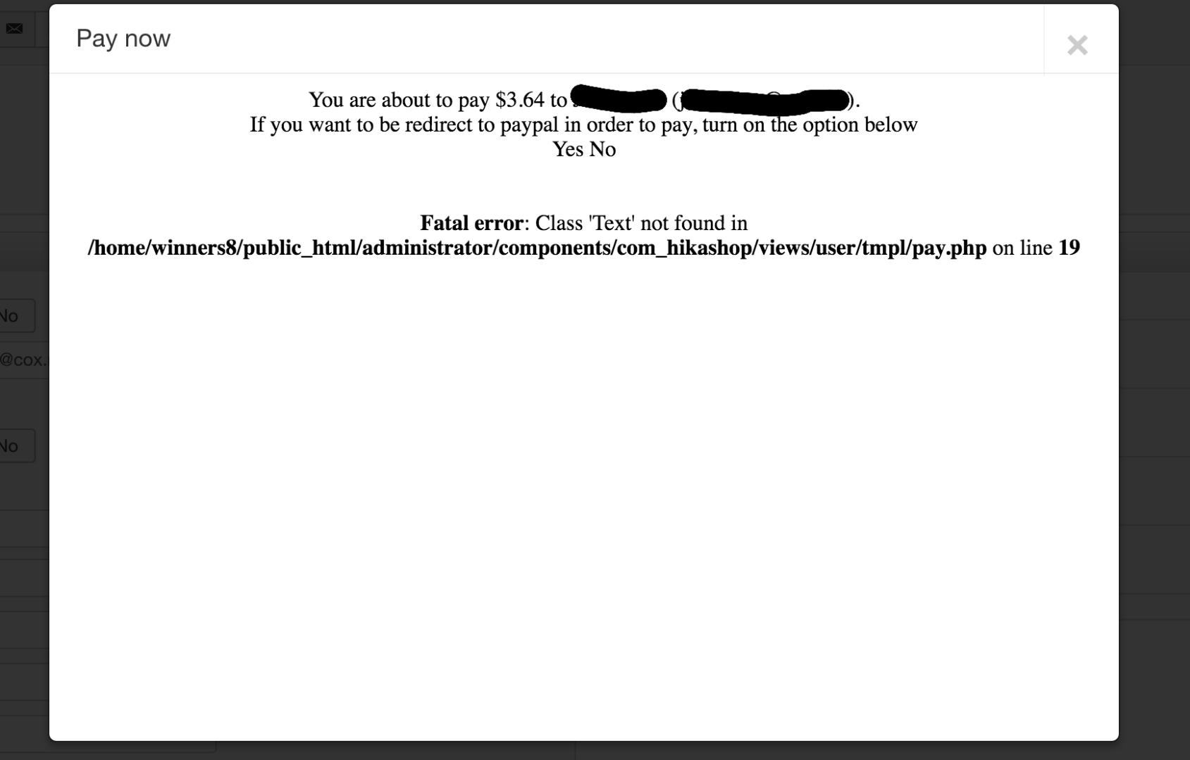

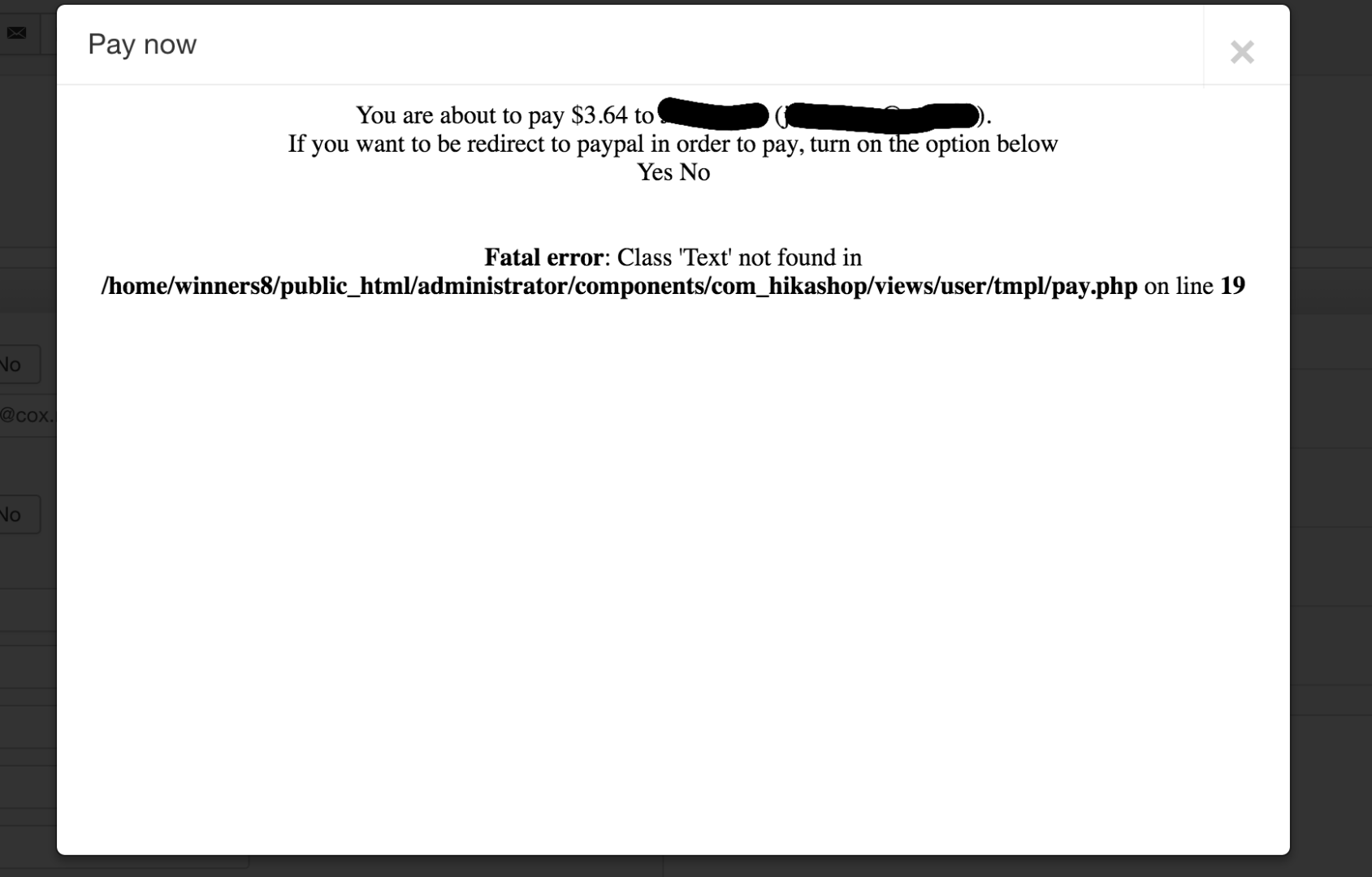

-- Error-message(debug-mod must be tuned on) -- : Fatal error: Class 'Text' not found in /administrator/components/com_hikashop/views/user/tmpl/pay.php on line 19
When I click on the pay now button, I get this error - Fatal error: Class 'Text' not found in /administrator/components/com_hikashop/views/user/tmpl/pay.php on line 19
The affiliate payment process worked fine until we updated to HikaShop 3.5.1...
Thanks in advance for your assistance...

the best way to progress on the subject, you have to go directly to the file (\YourWebSite\administrator\components\com_hikashop\views\user\tmpl\pay.php) and check that you have this around line 2 to 12 :
<form action="index.php?option=com_hikashop&ctrl=user" method="post" name="adminForm" id="adminForm">
<?php
echo JText::sprintf('PAY_X_TO_X', $this->currencyHelper->format($this->user->accumulated, $this->user->user_currency_id), @$this->user->name.' ('.$this->user->user_partner_email.')') .
'<br/>';
echo JText::sprintf('REDIRECTION_FOR_PAYMENT', $this->method) .
'<br/>';
echo JHTML::_('hikaselect.booleanlist', "pay", '', 0) .
'<br/>';
echo JText::_('AFFILIATE_PAYMENT_WARNING') .
'<br/>';
And if not, and especially the red part, correct it to have the same code and see if that solve your issue.

7 years 10 months ago #297324
Hello Philip,
I changed the part of the code which was different:
from echo Text::_('AFFILIATE_PAYMENT_WARNING') . to echo JText::_('AFFILIATE_PAYMENT_WARNING') .

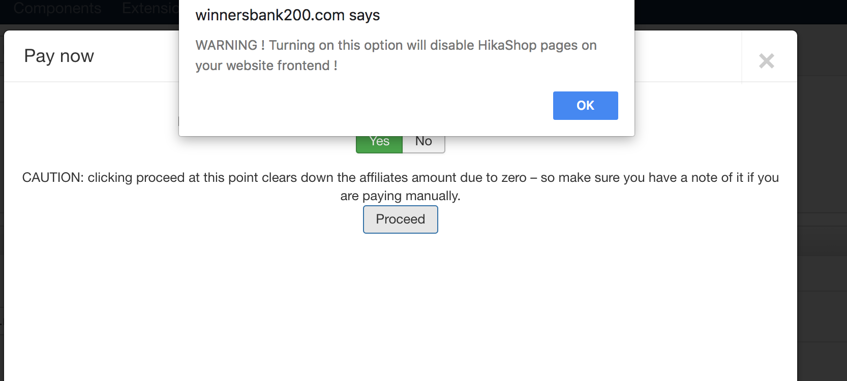

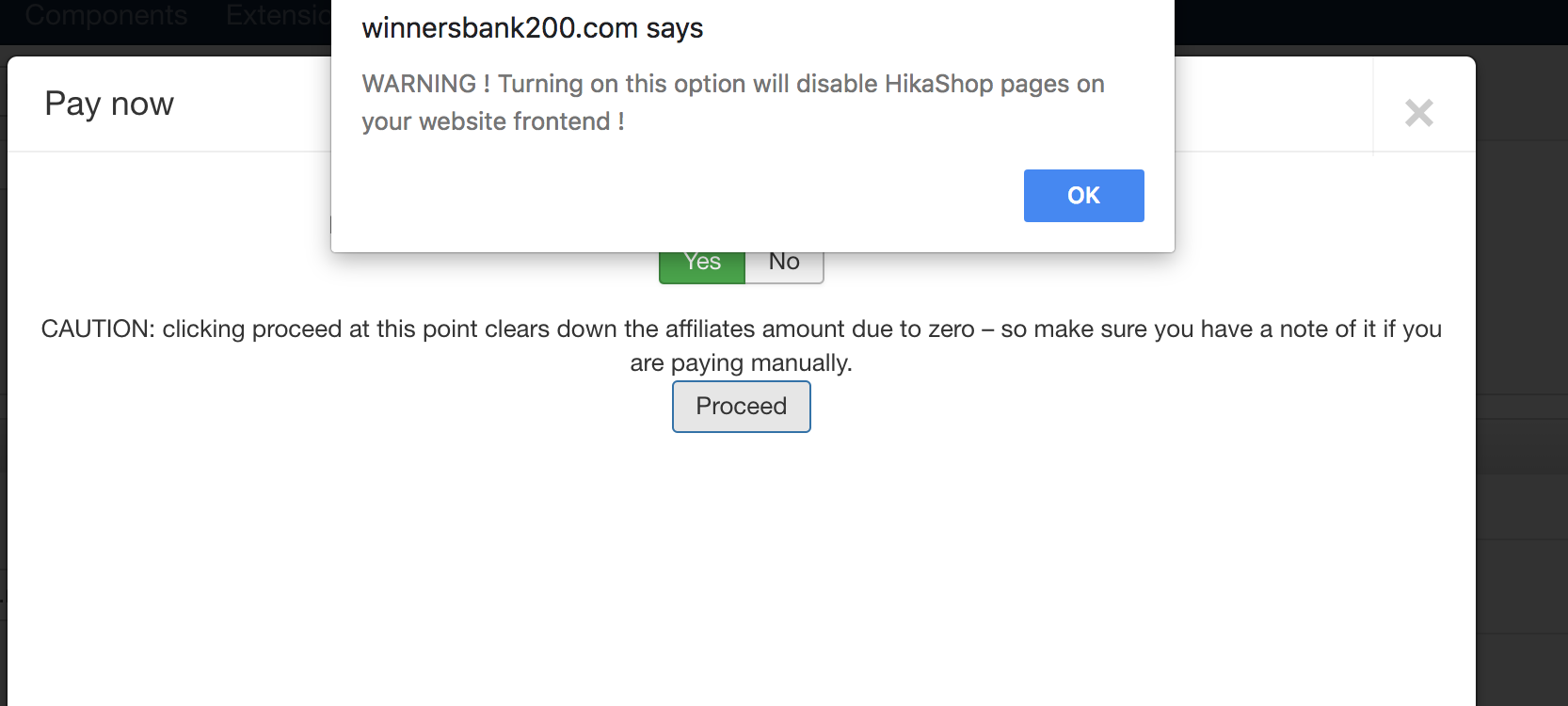

This edit cleared the error, however the process does not continue once the proceed button is clicked. Displays a message - WARNING ! Turning on this option will disable HikaShop pages on your website frontend !
When I click ok it does nothing...
Please advise...
Rufus

7 years 10 months ago #297375
We were able to reproduce that new issue and made a patch again.
Download again the install package on our website and install it on yours and you'll get that patch too.
Alternatively, in that same file, you can change the line:
<input type="button" name="pay_confirm" class="btn" value="<?php echo JText::_('PROCEED');?>" onclick="if(alert('<?php echo JText::_('STORE_OFFLINE_WARNING',true); ?>')){ document.adminForm.submit(); } else { return fase; }" />
to:
<input type="button" name="pay_confirm" class="btn" value="<?php echo JText::_('PROCEED');?>" onclick="if(confirm('<?php echo JText::_('PROCESS_CONFIRMATION',true); ?>')){ document.adminForm.submit(); } else { return false; }" />
