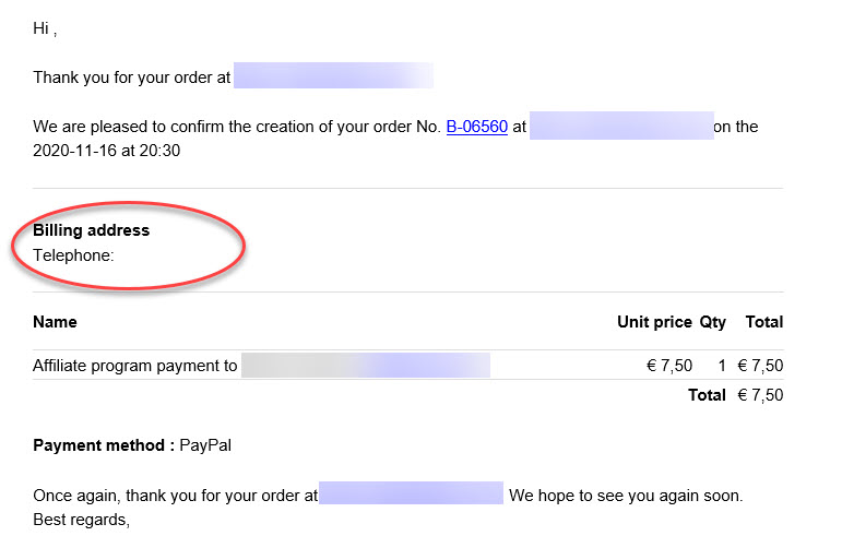

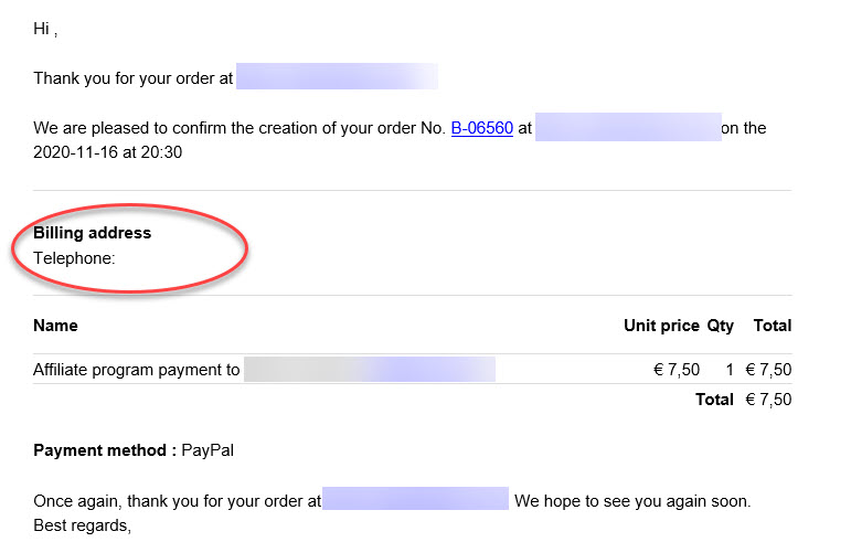

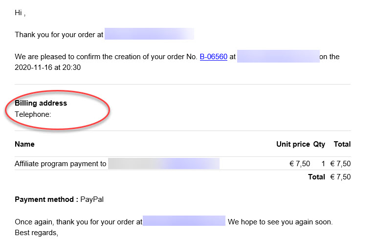

-- HikaShop version -- : 4.3
When we paid the partner, they get an e-mail.
1. Where can we change the text of those emails (only for the payments of the affiliates)?
2. Why does this e-mail have an ordernumber but we can't see it on the back-end orderlist or at the affiliate page on the partners account?
3. We can see this order only on the website when we click on the ordernumber link in the e-mail. Is that correct?
4. And if we want to print the invoice, there is no invoicenumber on it. Is that also correct?
5. Do you have any idea why we get Telephone on the Billing address? With normal orders we don't have this issue. (see screenshot)

1. You will have to edit the code of the email in the System>Emails menu. There is no easy way to do it. You'll have to check if it is an affiliate order or not based on the order_type which will not be "sale".
2. We don't display it on the backend as it's not a normal order but a "payout".
3. That's correct
4. I guess that means that the PayPal plugin didn't receive the payment notification for that order. It can come from many things:
www.hikashop.com/support/documentation/i...or.html#notification
5. I'm not sure. Could you provide a screenshot of the details of that order in the backend (you can change the id in the URL of another order to access it) ?
