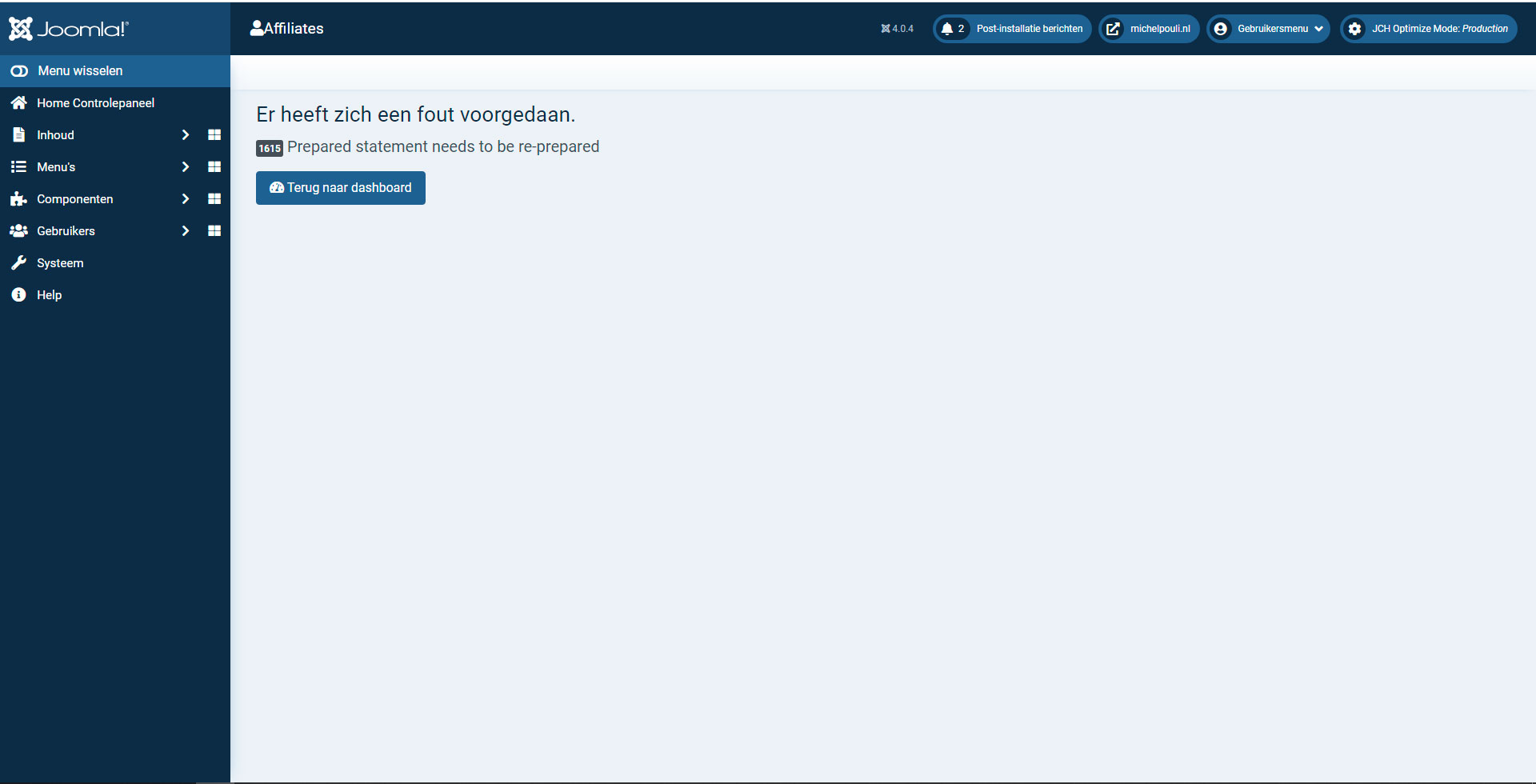

I entered an errorpage when trying to access the menuitem Affiliates-Affiliates in the backendmenu on our Joomla 4 testsite. See screenshot.

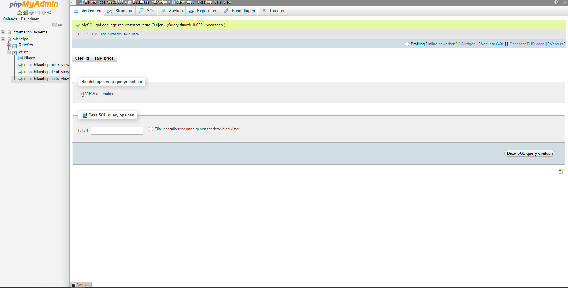

I contacted the hosting provider, they changed some settings, but this didn't help solving the problem. When I looked into the database I spotted besides the normal tables, some views for the affiliates see screenshot. In the database of the livesite in Joomla 3.10 I don't see these views. Can this have something to do with this issue?
4 years 11 months ago #337857 by nicolas
If the affiliate plugin is not activated, or if you don't access the Partners listing, these views won't be created.
The views are created specifically to precalculate the affiliate fees for each partner so that the partners listing can display them to you. And the query which is reported as generating an error is the one to precalculate the affiliate fees.

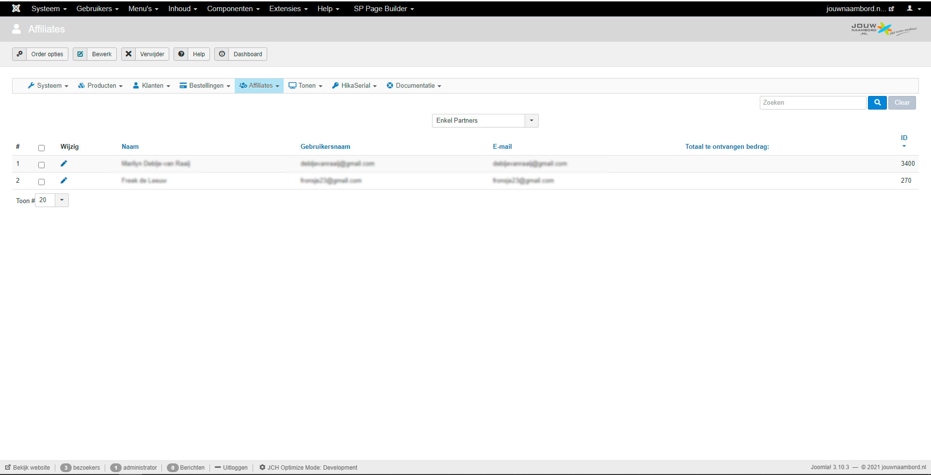

Thanks. I don't understand what you mean excactly. The config on both sites are the same. On the live site (Joomla 3) I get an overview of the partners and on the testsite (Joomla 4) I get an error. See screenshots.
4 years 11 months ago #337985 by nicolas
What I mean is that :
- I'm not able to reproduce the issue on the same page with PHP8 and Joomla 4. So it's likely an issue linked to the configuration of your MySQL and there is not much we can do in the code of HikaShop to avoid that.
- You can circumvent the issue by going in the menu Customers instead of Affiliates>Partners. There, you'll also have the partners listed.

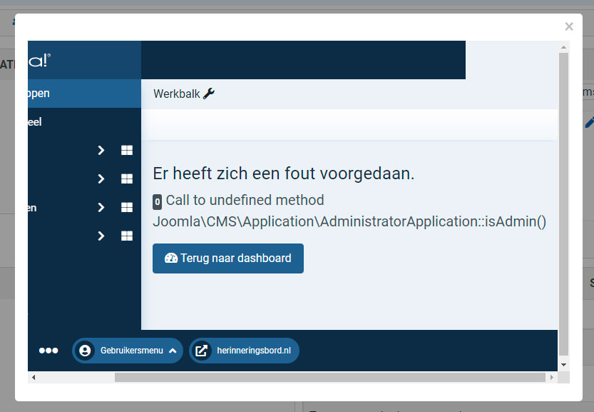

So this issue still remains and I went to the Customers menu as you suggested. Indeed the fee that should be paid is shown here. When I try to pay (as a test) I get another error. See screenshot. (PHP version is 7.4 as the PHP 8 has errors with the used template.)
4 years 6 months ago #341535 by nicolas
Could you activate the "debug system" setting of the Joomla configuration and try again ? That way, we'll know where there error is and we'll be able to provide a fix for this one.
4 years 6 months ago #341570 by jouwnaambord.nl
I did and I removed the Acymailing component. That seems to be the cause of the error.

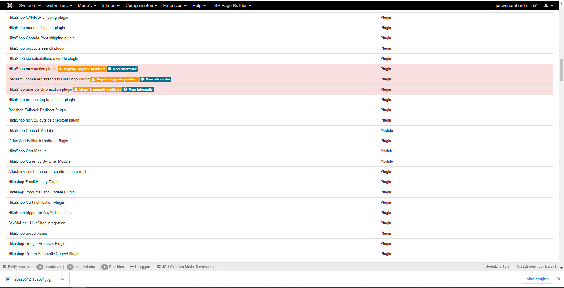

Before updating from J3 to 4, the precheck from Joomla (see screenshot) refers to several plugins that could break down the update. For Hikashop the warning contains:
HikaShop massaction plugin
Redirect Joomla registration to HikaShop Plugin
HikaShop user synchronization plugin
Hikashop Google Analytics Plugin
HikaShop geolocation plugin
HikaShop Payment Notification plugin
HikaShop affiliate plugin
So I disabled them before updating and then re-enabled them after the update. Still, the affiliate button still doesn't work.
4 years 6 months ago #341572 by nicolas
These plugins work fine on Joomla 4, as far as we know. I think you can ignore what Joomla tells you on the page of your screenshot.

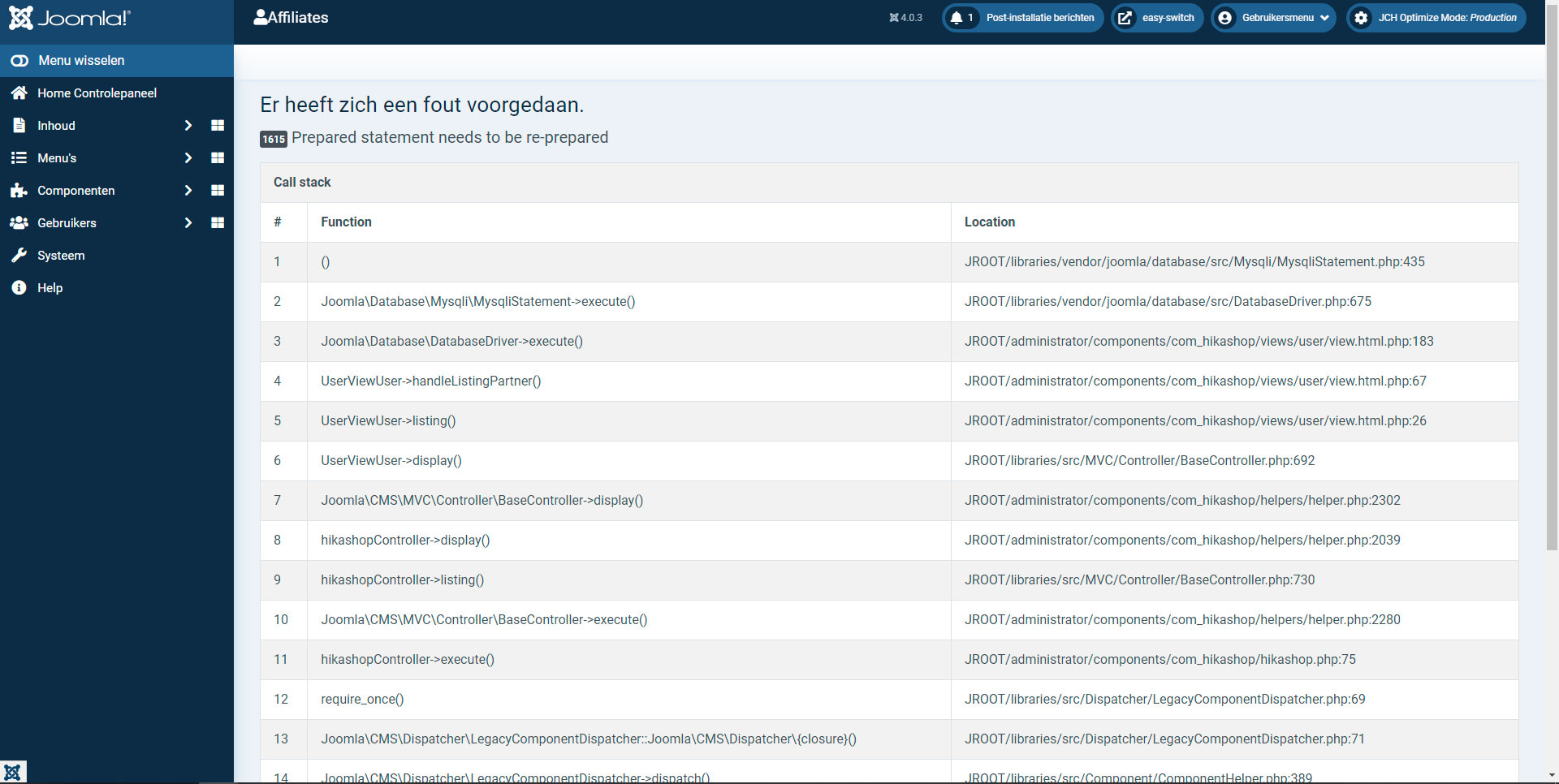

It's the menu Affiliates>Affiliates which still gives the error:
Er heeft zich een fout voorgedaan.
1615 Prepared statement needs to be re-prepared
Call stack
# Function Location
1 () JROOT/libraries/vendor/joomla/database/src/Mysqli/MysqliStatement.php:435
2 Joomla\Database\Mysqli\MysqliStatement->execute() JROOT/libraries/vendor/joomla/database/src/DatabaseDriver.php:675
3 Joomla\Database\DatabaseDriver->execute() JROOT/administrator/components/com_hikashop/views/user/view.html.php:183
4 UserViewUser->handleListingPartner() JROOT/administrator/components/com_hikashop/views/user/view.html.php:67
5 UserViewUser->listing() JROOT/administrator/components/com_hikashop/views/user/view.html.php:26
6 UserViewUser->display() JROOT/libraries/src/MVC/Controller/BaseController.php:697
7 Joomla\CMS\MVC\Controller\BaseController->display() JROOT/administrator/components/com_hikashop/helpers/helper.php:2334
8 hikashopController->display() JROOT/administrator/components/com_hikashop/helpers/helper.php:2069
9 hikashopController->listing() JROOT/libraries/src/MVC/Controller/BaseController.php:735
10 Joomla\CMS\MVC\Controller\BaseController->execute() JROOT/administrator/components/com_hikashop/helpers/helper.php:2312
11 hikashopController->execute() JROOT/administrator/components/com_hikashop/hikashop.php:73
12 require_once() JROOT/libraries/src/Dispatcher/LegacyComponentDispatcher.php:69
13 Joomla\CMS\Dispatcher\LegacyComponentDispatcher::Joomla\CMS\Dispatcher\{closure}() JROOT/libraries/src/Dispatcher/LegacyComponentDispatcher.php:71
14 Joomla\CMS\Dispatcher\LegacyComponentDispatcher->dispatch() JROOT/libraries/src/Component/ComponentHelper.php:389
15 Joomla\CMS\Component\ComponentHelper::renderComponent() JROOT/libraries/src/Application/AdministratorApplication.php:143
16 Joomla\CMS\Application\AdministratorApplication->dispatch() JROOT/libraries/src/Application/AdministratorApplication.php:186
17 Joomla\CMS\Application\AdministratorApplication->doExecute() JROOT/libraries/src/Application/CMSApplication.php:278
18 Joomla\CMS\Application\CMSApplication->execute() JROOT/administrator/includes/app.php:63
19 require_once()
In the clean install it doesn't give this error. So I don't think it's related to the MySQL config.
4 years 6 months ago #341596 by nicolas
It's probably the MySQL user which doesn't have the right to create views and this generates an error but the error is not interpreted correctly by Joomla's MySQL layer which then provides an error message which is not related to the problem.
Could you provide a backend access to the website and a FTP access so that we could add some debug code to look deeper into the matter ?
4 years 6 months ago #341603 by jouwnaambord.nl
Could be, allthough the massaction is working fine. I've sended you the access info.
4 years 6 months ago #341605 by nicolas
Thanks. I've modified a bit the code on our end to hide the error when the MySQL query fails.
I was able to test that the change works on your website.
However, that doesn't mean the problem is fixed on your website, it's just hidden.
To properly fix it, you would have to allow your MySQL user to create views.
Mass actions don't need views. The only place which needs views in the Affiliate>Partners menu.
