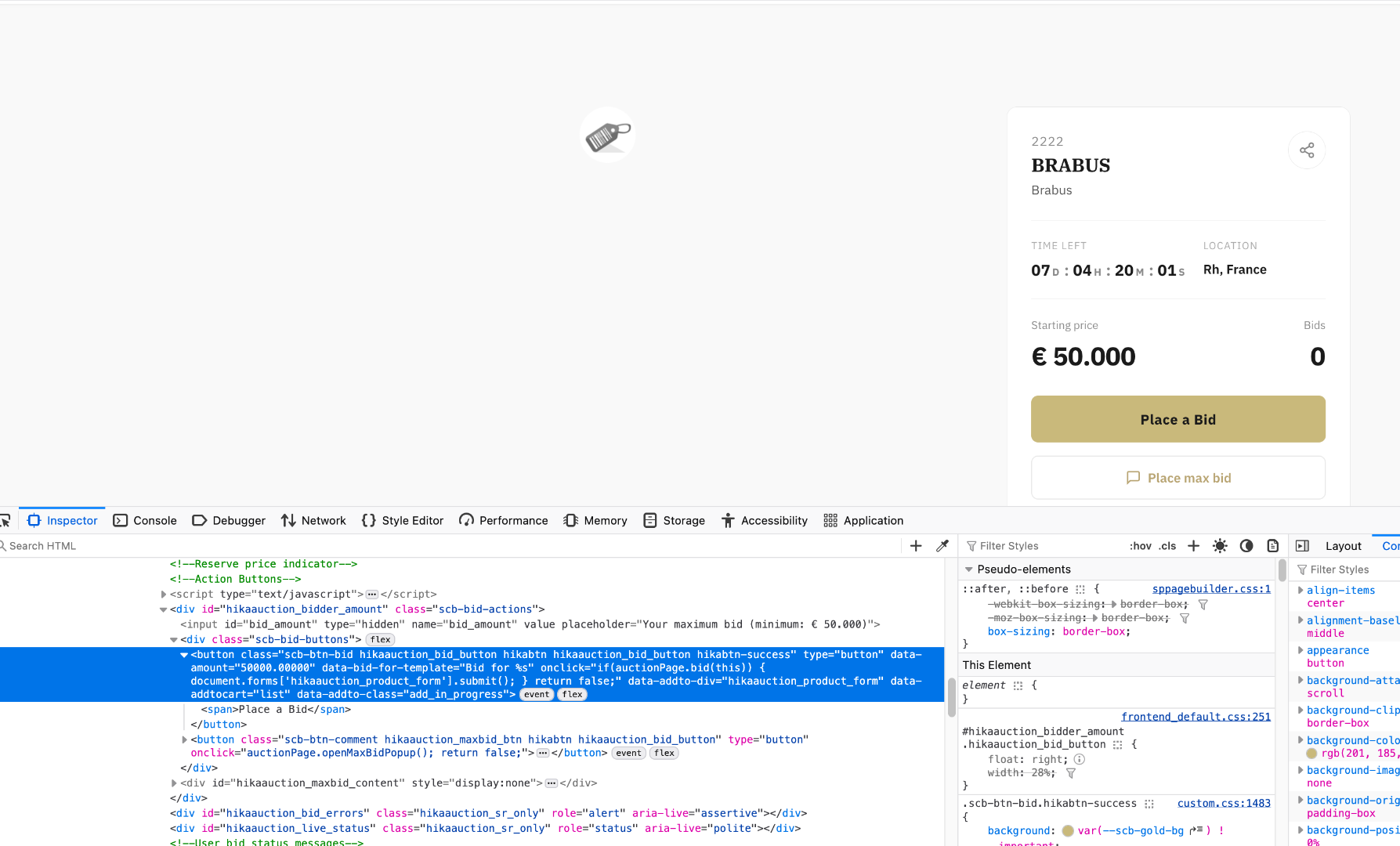

I found a bug in the new bid amount parsing patch.
On a new auction with no previous bids, the “Place a Bid” button submits the raw data-amount value from show_auction.php:
data-amount="<?php echo $this->bid_amount;?>"
Example DOM:
data-amount="50000.00000"
But controllers/product.php now parses the submitted value with localized currency format:
$amount = hikaauction::convertNumber($amount, hikaauction::getCurrencyFormat($currency_id));
If the currency decimal separator is not `.`, convertNumber() treats 50000.00000 incorrectly, strips the dot, and converts it to 5000000000, causing “Invalid amount” because it exceeds 999999999.
Manual “Place max bid” works because the user enters a clean localized/manual value, and after that the normal bid button may start working.
Suggested fix: in convertNumber(), detect already-normalized machine numbers before localized parsing:
if(preg_match('/^-?\d+(\.\d+)?$/', $num))
    return (float)$num;
This keeps raw values like `50000.00000` valid while preserving localized input support. i guess ;)
thank you.

Thanks senioriz, your analysis was exactly right and very helpful.
What was happening: when live formatting is active the bid field submits a canonical "machine" number (plain digits, a dot as the decimal point, the fraction padded to the currency's number of decimals, for example 50000.00000). The server then parsed that value with the currency's display format. For currencies whose decimal separator is not a dot (comma-decimal / dot-thousand locales), there was no comma to find, so the server treated the dot as a thousand separator and dropped it. That turned 50000.00000 into 5000000000, which then failed the amount check. It showed up most clearly with no previous bids, because that is when the raw starting/minimum amount is submitted as-is.
This is now fixed. The server parser recognizes a bare machine number (digits, a dot, exactly the currency's number of decimals) and reads it directly when the currency decimal is not a dot, so the displayed value, the submitted value and the server-side check now always agree. Standard bids and maximum bids both go through the same parser, so both are covered. The change is server-side only; no template or JS override is needed this time.
Download the install package on our website and install it on yours.
