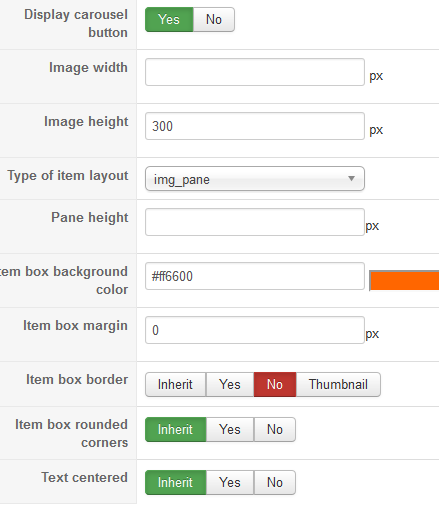

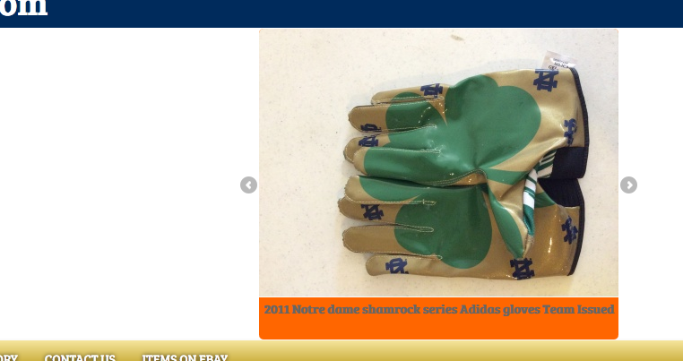

I just upgraded to business from starter. I have spent this evening learning about the carousel functions. I ran into an issue anytime I used
"Type of item layout": anything with a pane (Fade, img_pane, slider_horizontal & slider vertical)

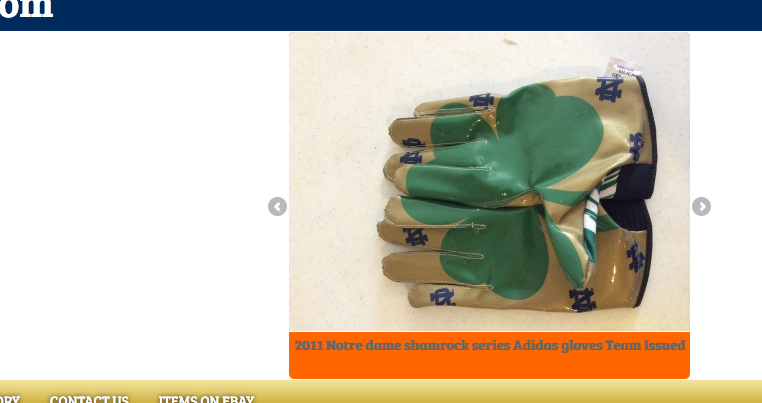

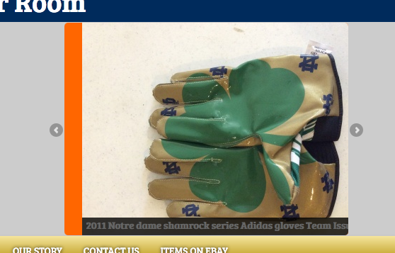

The Carousel would have a margin at the left. The orange background illustrates this. Even when the next slide moved it would not move the old slide all the way off.
Any layout without the pane was fine

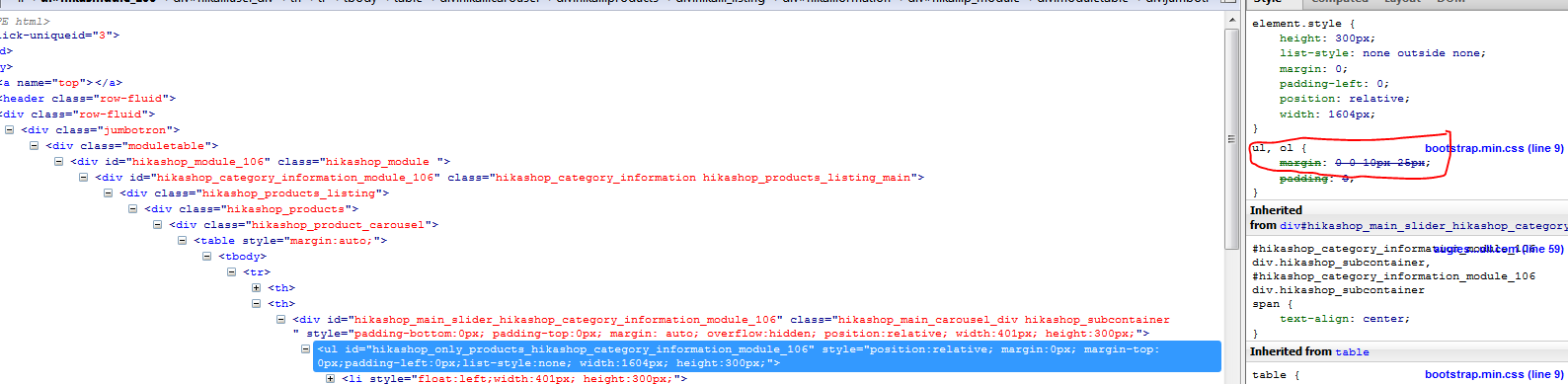

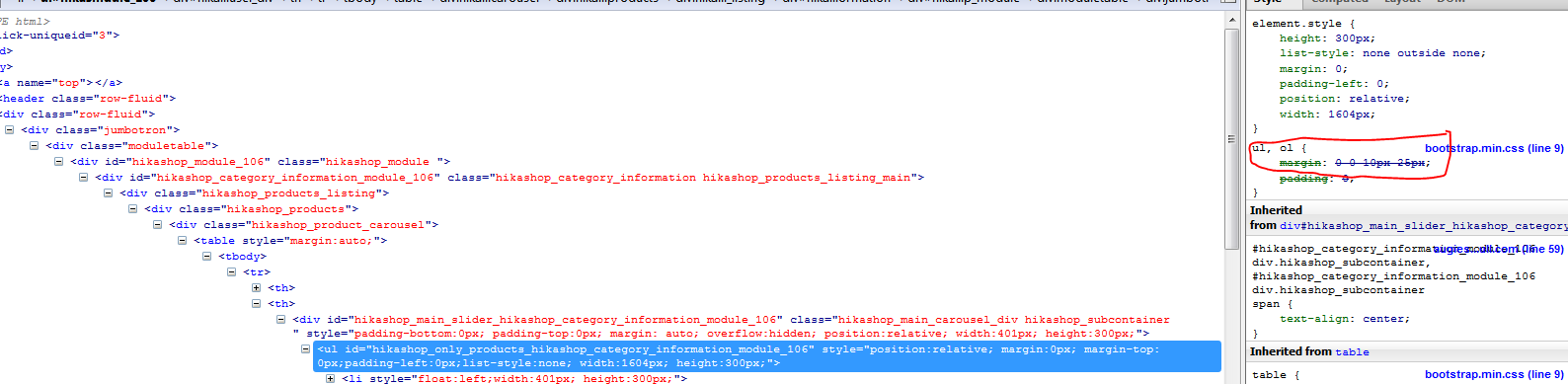

I tested this on my custom template and proto star with the same results. I used Firebug to isolate the issue and it turned out to be bootstrap.min.css causing it.
I just added a rule to my custom.css
/* Hikashop Custom CSS */
.hikashop_product_carousel ul {
        margin: 0;
I expect you could add it to the System, Configuration, Display, CSS, Front-end CSS File
for those who are not using custom templates?
