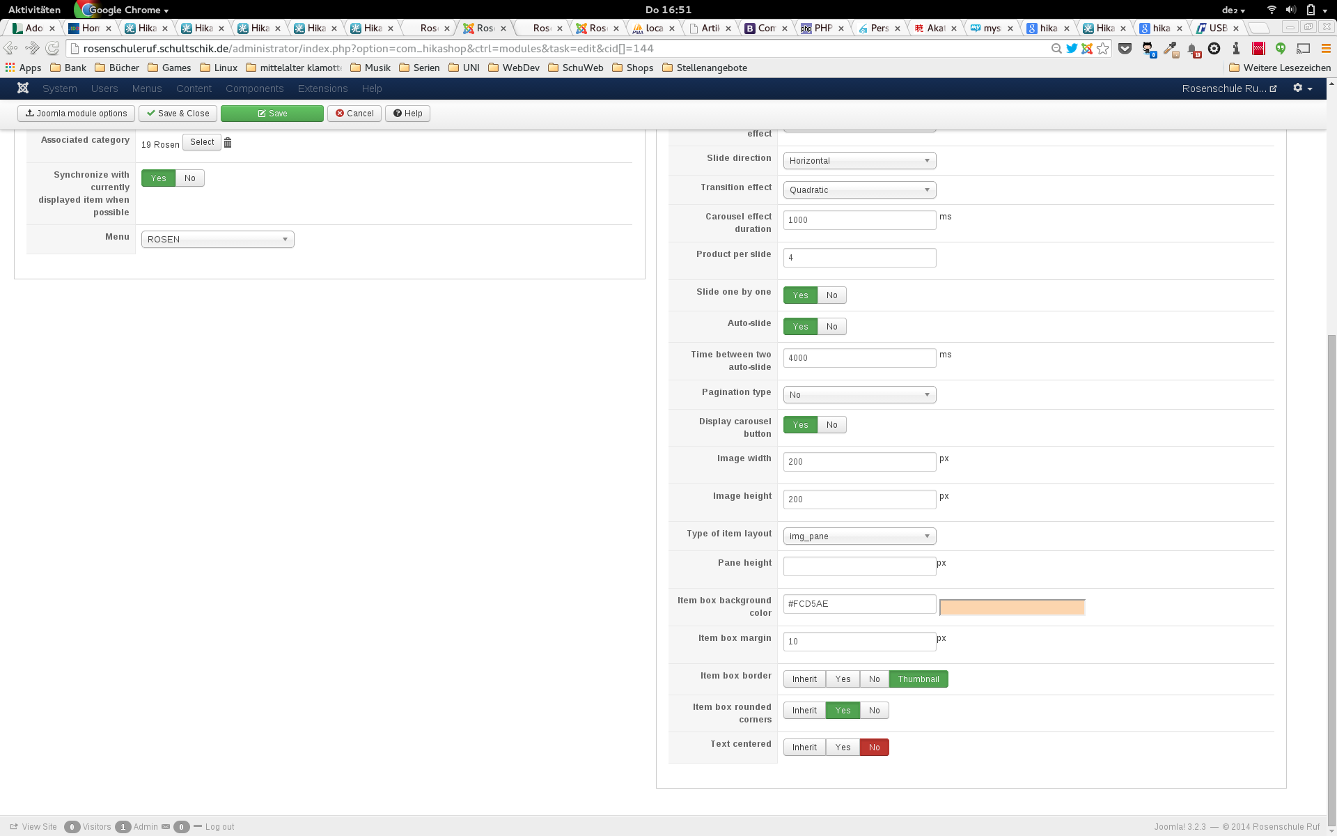

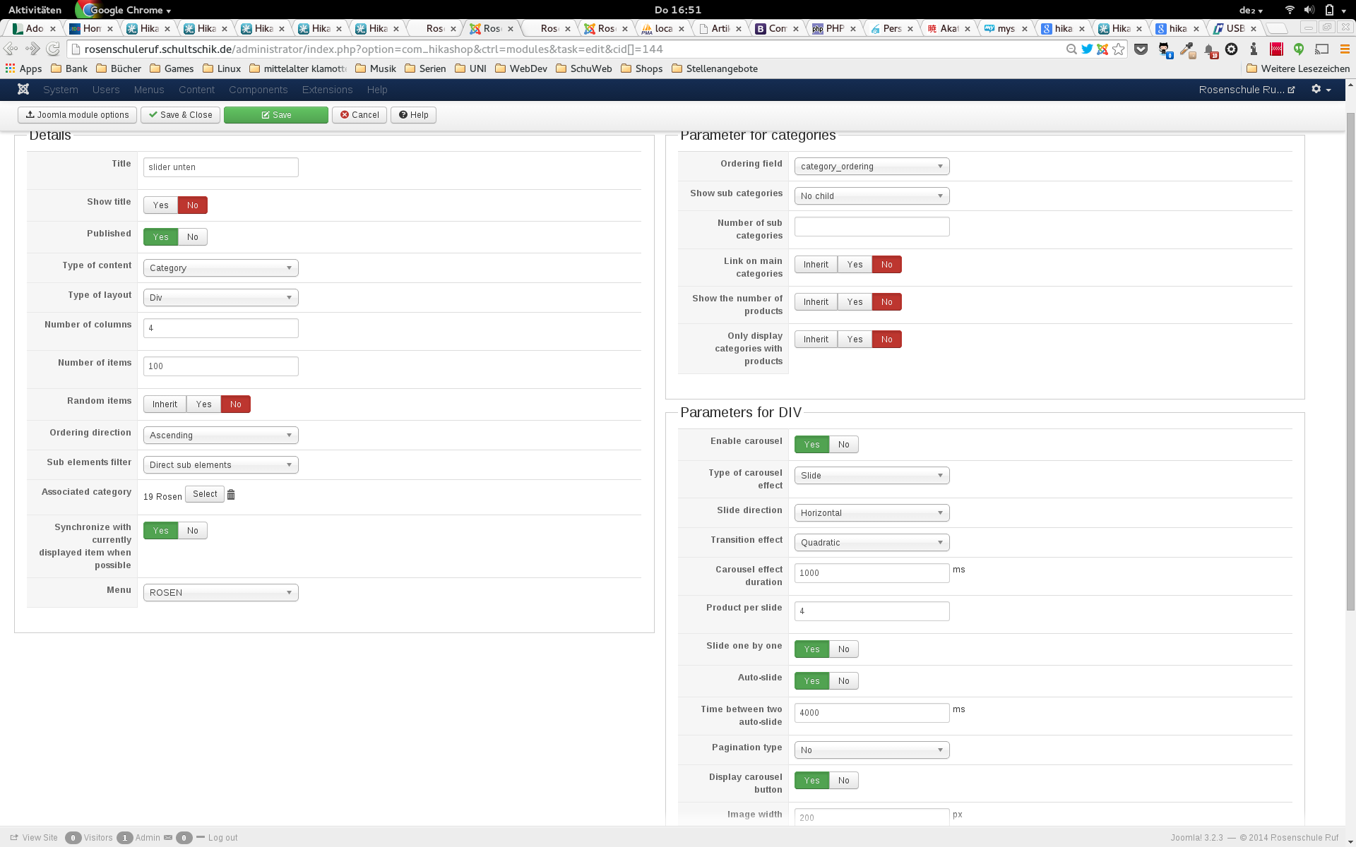

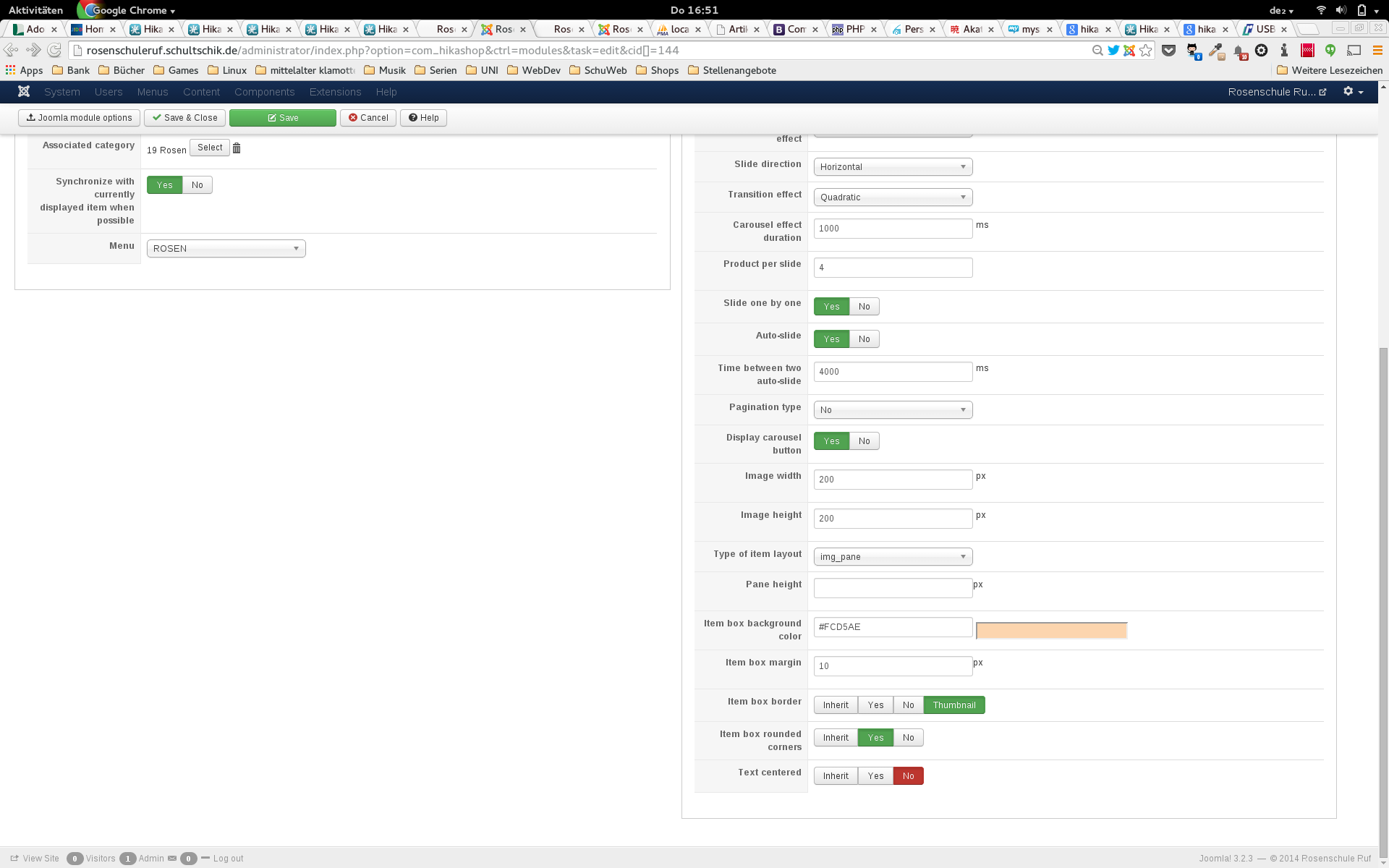

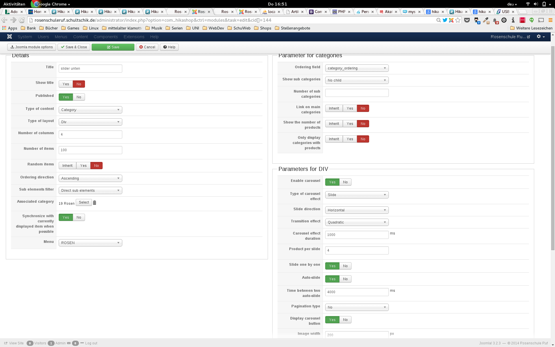

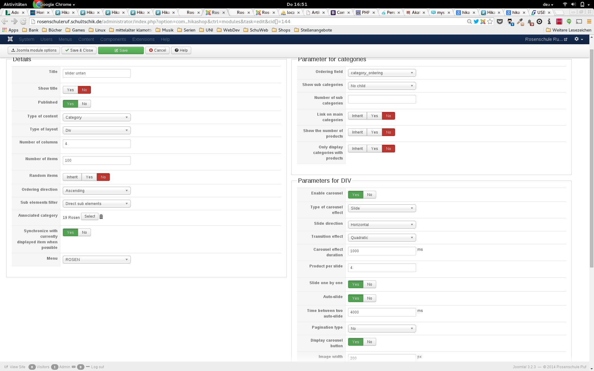

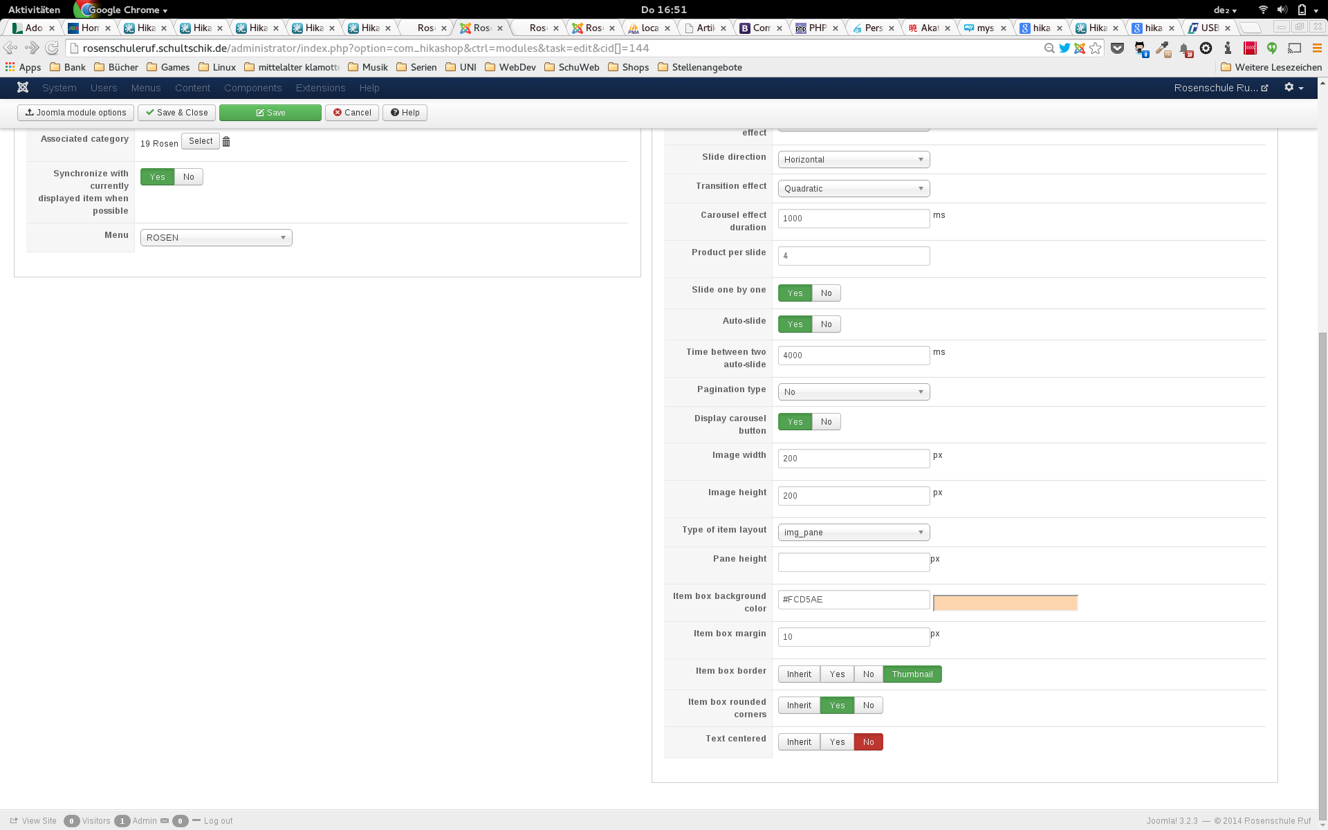

  • Posts: 36
12 years 3 months ago #159946
Here are two screenshots of the config of the carousel module
