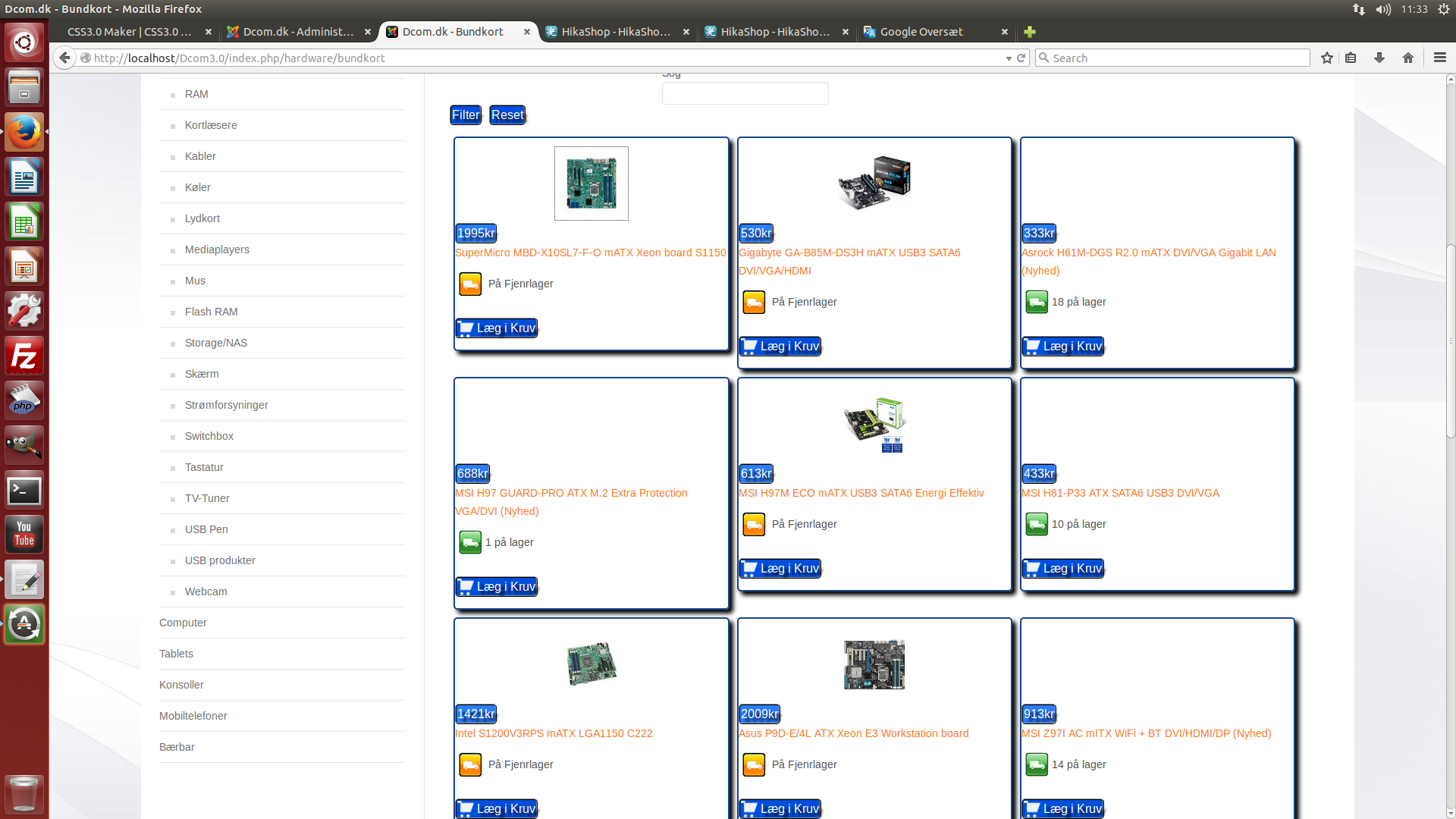

Hello
I have a little trouble with my rows are not straight height because of some of the product has to text line an other only have one. when it stand advance of each other and it does not look good.
I can see that hikashop is set to auto parts rows in that the width but not in the height.
Is it possible to get it to it, so the products are on a straight line :)
Tanks for our time

I would like to share how I solve this problem with my rows jumping up and down. The reason that my number was not equal because the text feldte were not the same all products thereby also 40px per line
In the Cosstum CCS file into I put these lines.
In order to control the height of the weather box.
.hikashop_subcontainer {
   height: 280px;
To control the text figures how much it must fill the product page
.hikashop_product_name {
   font-size: 100%;
   height: 35px;
Show you now want a different text layout can i write it in .hikashop_product_name or some text must have different color, etc.
Hope you can use or mail me and I will answer you as best as possible.
