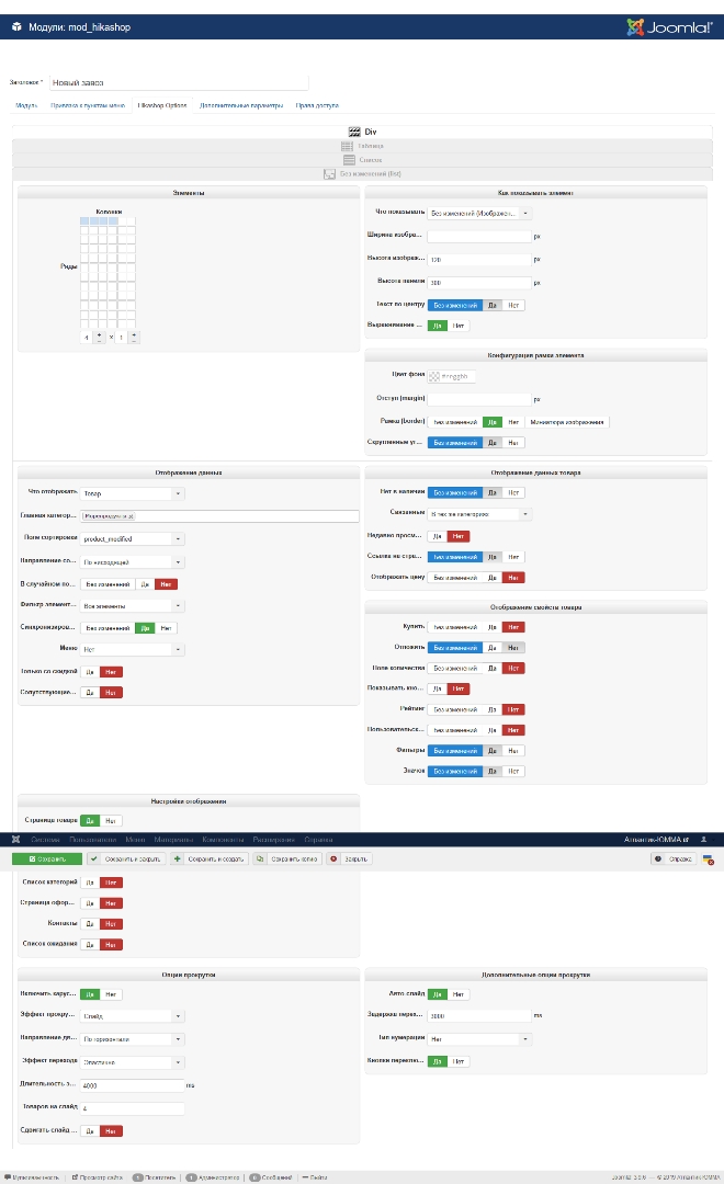

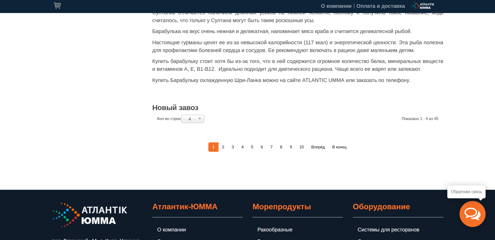

Sorry, I hoped that someone from the Russian-speaking team would answer. I attached here screenshots of frontend and backend

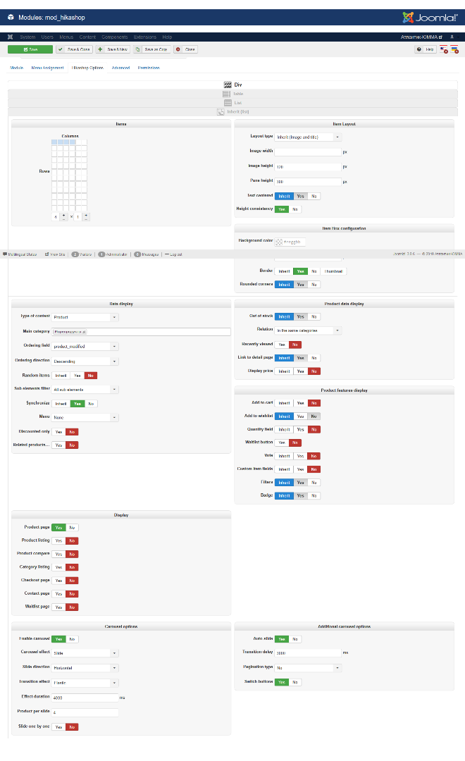

7 years 3 months ago #307282
English control panel screenshot here
