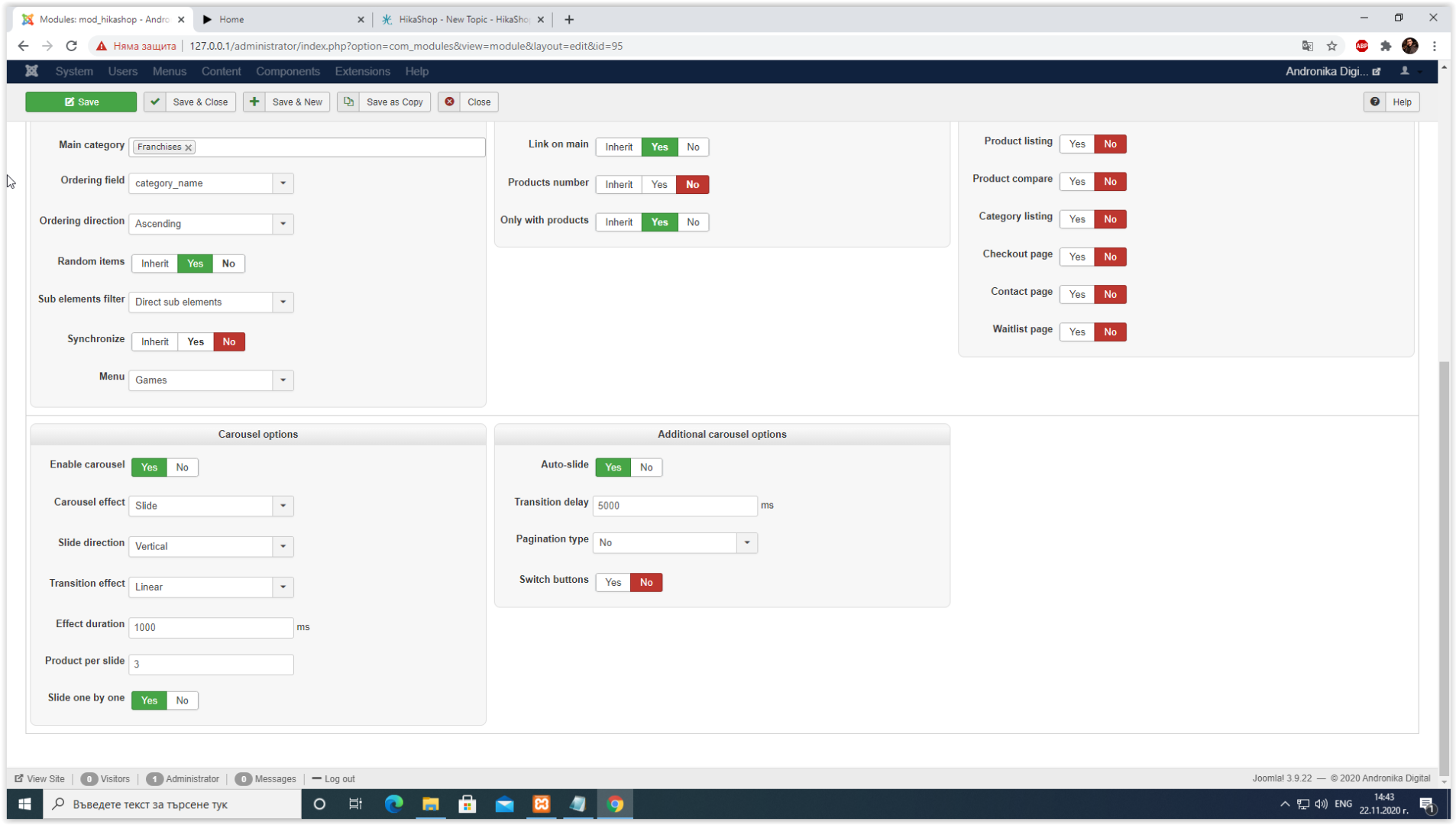

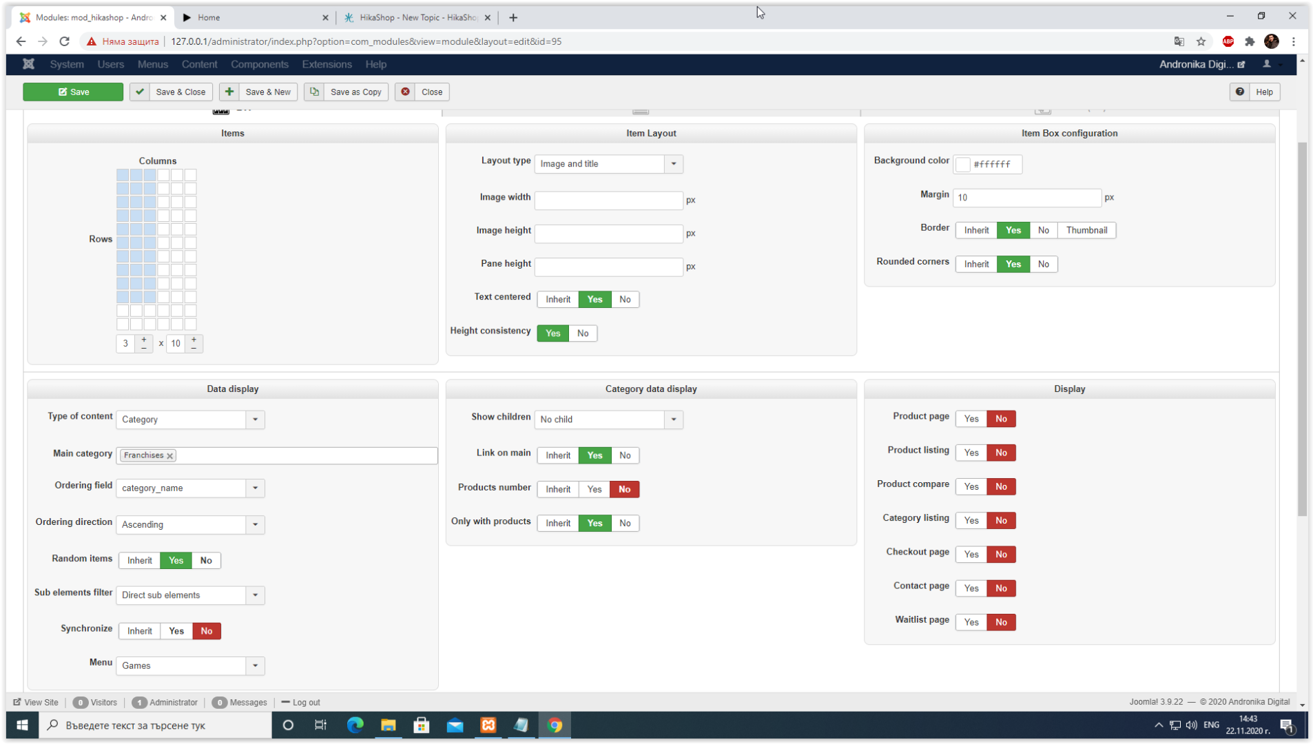

The carousel does not follow the setting 'Only with products'
5 years 10 months ago #326255
by neo191987
5 years 10 months ago #326281
by nicolas
Replied by nicolas on topic The carousel does not follow the setting 'Only with products'
You're totally correct.
That setting is currently ignored in carousel mode.
Add the code:
at the beginning of the view file category / carousel.php via the menu Display>Views and it should work properly.
We'll add that patch on our end for the next version.
Add the code:
Code:
$rows = array();
if($this->params->get('only_if_products','-1')=='-1'){
$config = hikashop_config();
$defaultParams = $config->get('default_params');
$this->params->set('only_if_products',@$defaultParams['only_if_products']);
$only_if_products = $this->params->get('only_if_products',0);
foreach($this->rows as $row) {
if($only_if_products && $row->number_of_products < 1)
continue;
$rows[] = $row;
$this->rows = $rows;
