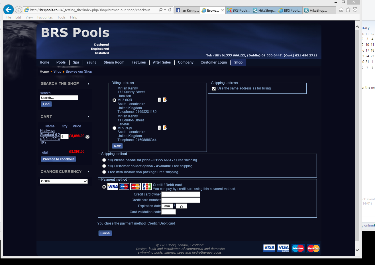

Hi There,
I'm just wondering, if you look at the Billing address in the image I'm attaching, everything looks a little squashed.
I would like to change the layout a little (basically put a gap between the two addresses, move the town to it's own line etc), where abouts would I look? I'm in Views atm but I'm not sure what I'm looking for.

I've tried to add for the above question the following css - but it makes no difference to the layout. Can you help?
.hikashop_checkout_billing_address_info {
padding-bottom: 20px !important;

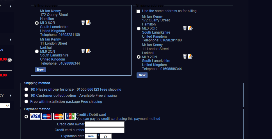

Mohamed,
You will notice that there are two possible billing addresses, and two possible shipping addresses. They are very close together, one above the other. What I would like to do is introduce a space between them, and I suspect the best way to do this is to add padding after the telephone number, which is what I was trying to do.
The page with the issue requires you to register, login and make a purchase, so to save you having to do this,
the direct link to the css file is www.brspools.co.uk/_testing_site/media/c...frontend_custom2.css
