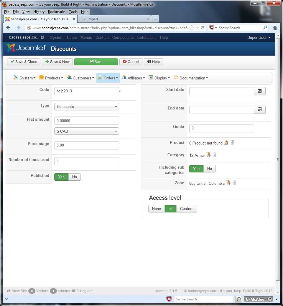

I can't seem to get my discounts working properly. For some reason, it applies the discount to all products even though I haven't entered the discount during the checkout process.
I've set a discount called "bcjc2013" to apply a 5% discount to products in the Armor category. See the attached screenshot for details.
I also find that applying the discount by category to be problematic for the number of products I have... ideally it would be easier to apply the discount by brand/manufacturer.

Discounts apply directly on the price of products, that's normal. What you want to use are called "coupons". Change the type of your discount to "coupon" and you will see that it works like you want.
Discounts/coupons can apply onto a product or a category. There is no option to have it apply to a brand for now.

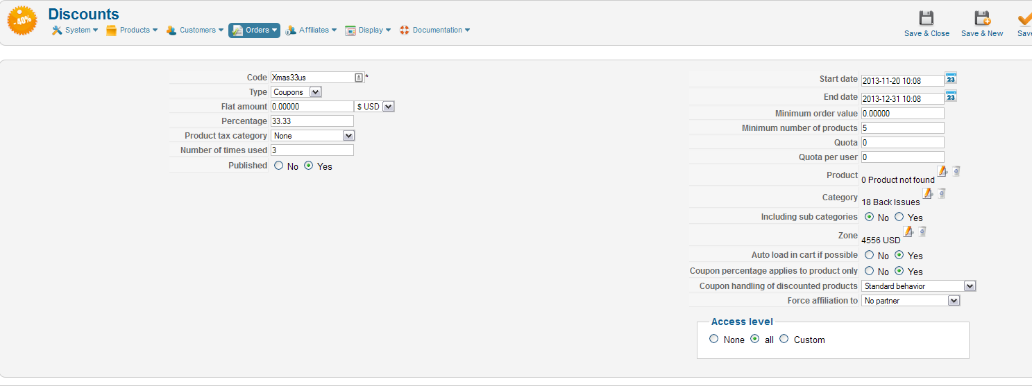

Hi, Yes as sure as I can be, attached a screen shot.
The discount is on the back issues category only. If the order is only for back issues (5 or more) it's working fine, but an order for 2 x back issues and a product from another category triggered the discount. This shouldn't be possible the other category product should have been at full price and no discount for the 2 x back issues as the number was under 5.
Hope
