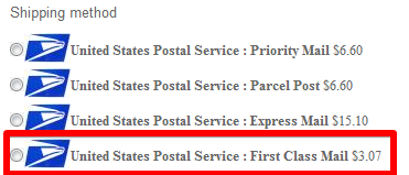

I just reinstalled the newest download over top of what was there, and it appears to have corrected the OP problem but now I have a new one. After I go to the checkout for the first time after adding an item to the cart I get a USPS error at the top. I get the rates pulled and can select one and continue past it. It seems to only happen the first time after adding the item to the cart. If I go back to proceed to checkout or navigate to another place on the site and come back, it doesn't do it. It's odd.
USPS error: -2147219434 First Class mail must weigh 13 ounces or less.
Failed to obtain shipping quotes.
I'm sure it has something to do with a configuration, but it's never returned this error before.

The error pops up no matter what, as long as First Class shipping is checked as an available shipping method. If the First Class options are unchecked, no error pops up (I suppose that would be obvious if First Class isn't even being requested in the rates pull). The rates for all the other methods checked still seem to come through, and the checkout process can continue, however, First Class just doesn't seem to be functioning at all, under 13 ounces, above 13 ounces, either way it fails.

The testing was my mistake, I didn't save the weight of the package I wanted to test, sorry about that, you are correct, it does work correctly if the package can be shipped via First Class mail. However, if the shipment exceeds the 13 ounce limit, shouldn't the first class option just not show? Is there a way I can turn off the raw UPSP error code that's appearing? Visitors and customers should never see a debug error code like that, I can't imagine that being the correct operation of the component. If it's something I'm missing, I can't find it, but if showing the error like that is the default, is there any instruction as to how I can hide it from view? As I move forward with all my websites, I am going away from VirtueMart and moving to Hikashop, so I need to make sure I know all the in's and out's of the system. Thanks.
12 years 11 months ago #119179
You're right, I've done some modification through the USPS code so your customer won't see the "13 ounce error".
