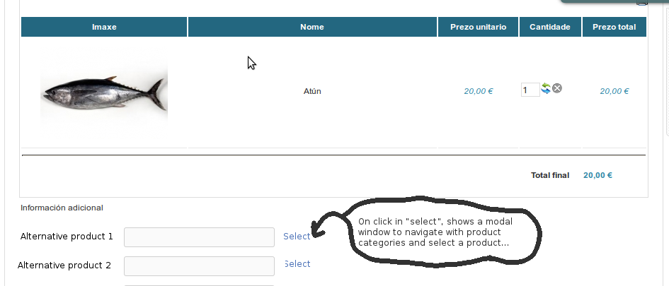

12 years 11 months ago #119830
Ok. An example you could see in the image. I would like to fill a custom field with the name of a product from a modal window with a list of products and categories.
Thanks a lot for your help

12 years 11 months ago #119848
Hi there,
This kind of thing is not possible with Hikashop without some huge customization. You can either create a plugin if you feel confident enough or ask on the commercial job forum if it's really what you want.
Either way, you can use the content module as Mohamed suggested and only propose specific products with no price and a name like "alternative product: your product" so it will be in the order but the client won't pay for it.
