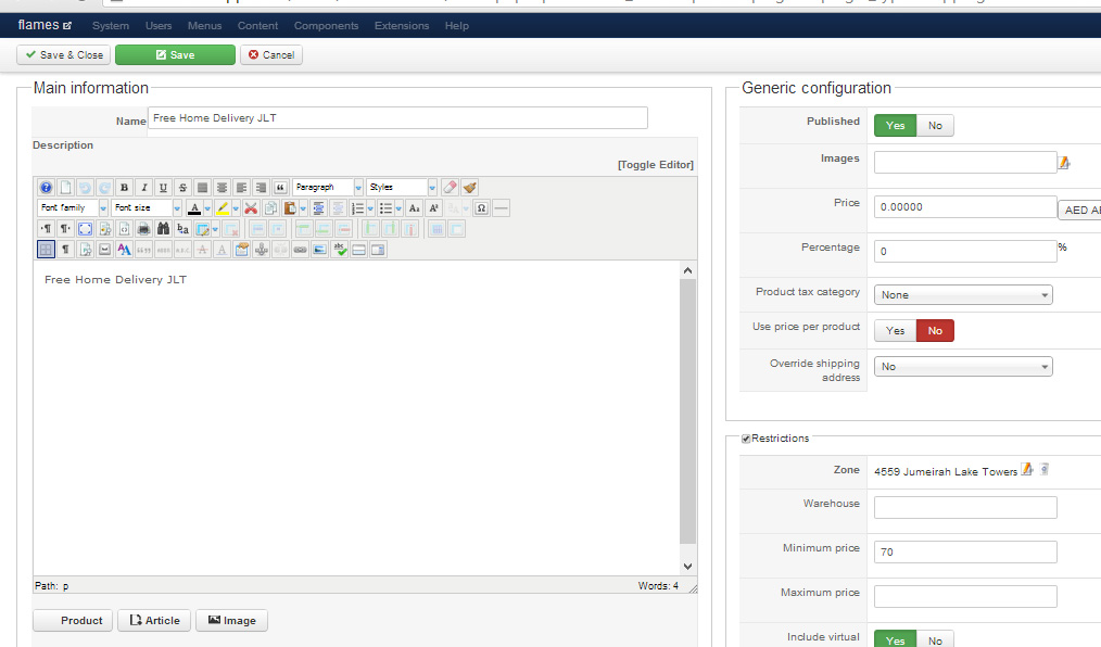

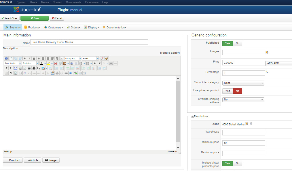

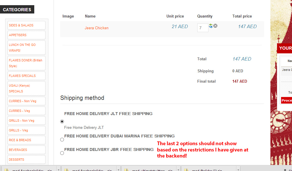

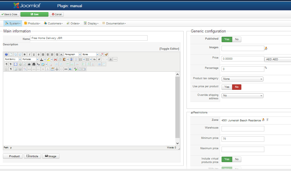

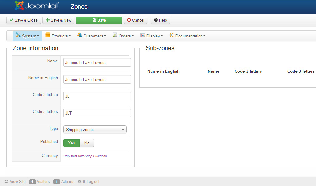

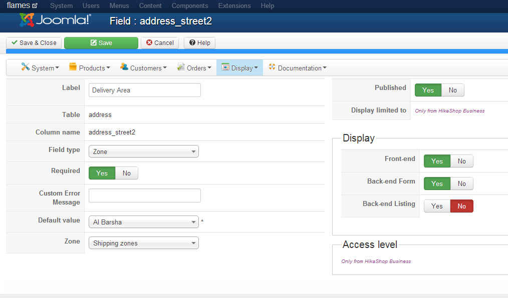

Thanks for your reply. Here is what I have done.
I have created a custom field (display >Custom field) called delivery area of "Field type" ZONE and selected the "Zone" as SHIPPING ZONE.
I have also created separate shipping methods (using hikashop manual shipping plugin) for each zone. Under the restrictions I have applied the respective shipping zones as Zones and I have also restricted the shipping method for each zone with a minimum order value.
However, after I do this, on the front end, when a customer places an order he is getting an option to select from all the shipping methods I have created at the backend. ie. all the shipping methods are visible! What I want is that he should just get the shipping method that I have defined for his delivery area.
To explain better, I have attached screenshots with my message. I can give you access to the back end of the site if it helps.
Thanks.

I just see one shipping configuration. We can't see the two others, in order to understand why they are displayed if they shouldn't, the best is to see their configurations.

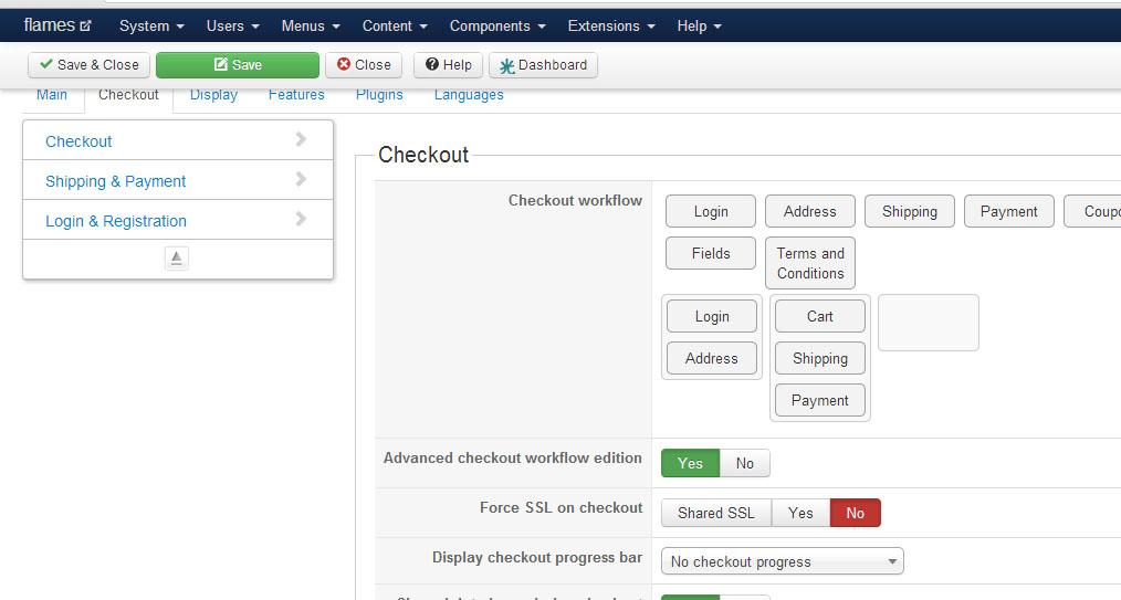

Did you put an address action, before or through your shipping action's step ? if not can you do it and test it again, because you can't use your shipping zone restrictions if your customers can't add their delivery address.

How do I do that? Not sure how to put an address action. I put an address on the workflow step. Pls see attached screenshot. However I am guessing this is not what you mean.

I have checked and double checked....but it is not working...What I want is based on the customers location selection (delivery zone) at the time of logging in, the shipping method displayed should also be that. What is happening as of now is that all the shipping methods defined at the backend are showing up on the front at the time of checkout. Let me be more clear. For eg: At the time of logging in, I have defined my delivery zone to be Dubai Marina....then the shipping method displayed at the time of checking out should also be the shipping for dubai marina...and not Dubai Marina, JBR & Jumeriah Lakes Towers. (these are the 3 shipping methods I have defined at the back for testing purposes). Pease help.

12 years 10 months ago #122717
The problem was coming from your custom fields configuration, so now your restrictions should work.
The following user(s) said Thank You: shivali
  • Posts: 32
12 years 10 months ago #122754
Thank you!! tested and it works! Can you pls let me know what exact configuration was wrong so that I do not repeat it again.
Cheers
Shivali
12 years 10 months ago #122861
The problem was coming from that fact that :
- you have changed the type of your "address_state" and "address_country" custom field
- you didn't used them through your address form but your used a single dropdown for the country, and the "adress_state2" for the state.
Regarding the state/country selection, you HAVE to use the "address_state" and "address_country" custom field and to don't change their type.
