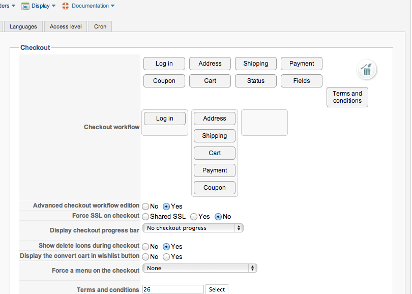

12 years 7 months ago #136955
1. Can you show me how did you configured your checkout workflow ("Hikashop->System->Configuration->Checkout")through some screenshots ?
2. I didn't really understood the problem that you were having with the credit card payment plugin, can you show me some screenshots of the issue that you are having ?
Note that it's possible that your issue has already been fixed through the last Hikashop version.
