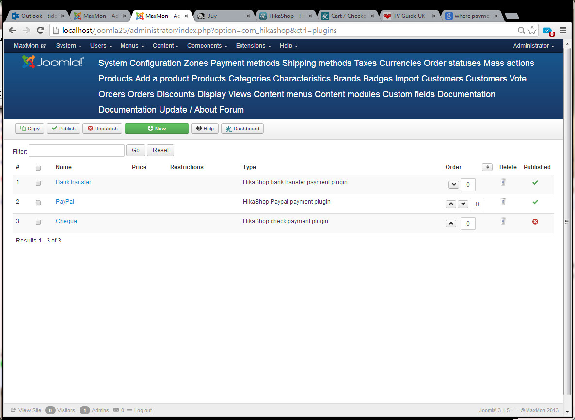

But this 2.2.2 version still looks a little weird. I cannot find any UI to reliably take me directly to shipping vs. payment plugins and the dashboard banner looks weird, with lots of unclickable words (see attached) in place of things I would like to do ... like going to payment methods or badges.
I can get to the correct plugins by using the Joomla plugin manager, then returning to HS.
Mystified :(

www.hikashop.com/support/documentation/5...html#display_general
Menu position : As you might have already seen, HikaShop does not use the standard joomla menu interface. We decided to do our own interface in order to handle an additional level of menus so that you can easily reach any functionality of the HikaShop backend. Our custom menu is added under the title of the page by default on 2.5 and below but some backend templates have a reduced size for this area, thus hiding the menu. So you have here the possibility to add the HikaShop menu above the main area where you should not have such issues. If you upgrade from 1.5 or 2.5 to 3.0 or above, you will have to turn off that option after the update.

Ah, the old configuration parameter #422 problem :) I had wondered what that knob did, but thought it was to do with front end menus. Complex product ... but excellent support.
Thanks!
