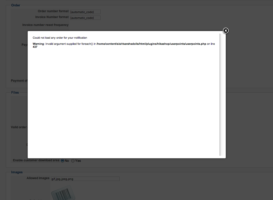

I'm having issues having orders being automatically confirmed as Paypal is not sending the information back to Hikashop. I've tried turning the debug on but just get the following when I try and access the log file:
Could not load any order for your notification
Warning: Invalid argument supplied for foreach() in /home/content/s/a/r/sarahsdolls/html/plugins/hikashop/userpoints/userpoints.php on line 437

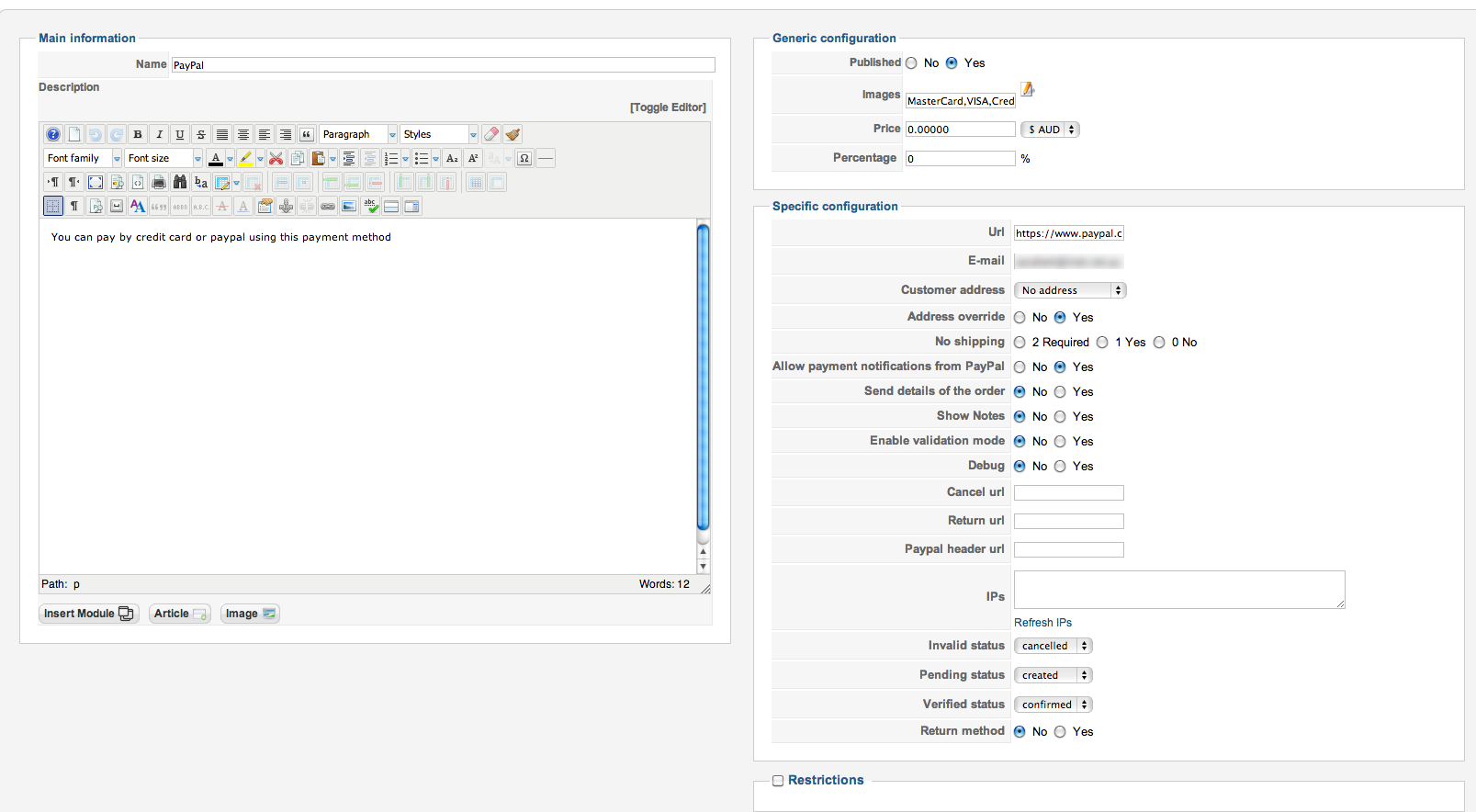

Thanks to post a screenshot of your paypal method configuration. (and hide your paypal email address).
To see which error cause the communication problem between HikaShop and Paypal you have to enable the debug mode in Paypal configuration, and then go in Configuration > Main > Files > Error log file > See the report to see if any errors are returned when using Paypal.

As I said, I can't read the error log as it comes up with an error when I click on it:

This plugin should not cancel the report log popup display, and if it's unpublished it should interfere with nothing.
Thanks to give us the corresponding lines for this error.

12 years 10 months ago #129366

12 years 10 months ago #130470
I don't really understand why you have still this error message displayed.
First of all thanks to refresh the IPs in the paypal configuration, and check if your email is a valid paypal email.
