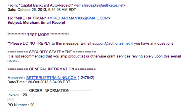

Site runs fine; customer ordered book and went through payment process but got TEST MODE ON.
Customer gets order created message, product will be delivered when payment received; no payment arrives in my account.
Checked Authorize.net, it's in LIVE MODE.

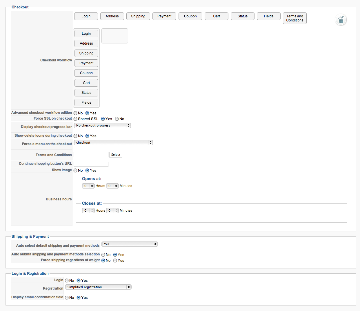

Please provide a screenshot of the configuration of your checkout workflow and your Authorize.net payment plugin (you can simply hide/remove the credentials for the screenshot).
  • Posts: 12
12 years 10 months ago #129419
Hi. I've got the screenshot of the checkout flow, attached below.

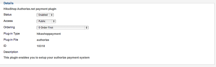

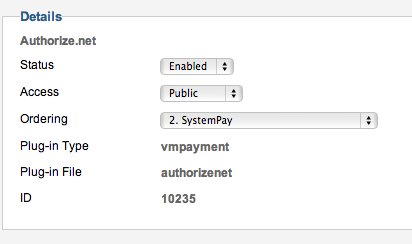

I found two plugins in the
Extensions > Plugin Manager
Hikashop Authorize.net Payment Plugin & Authorize.net (screen shots attached).

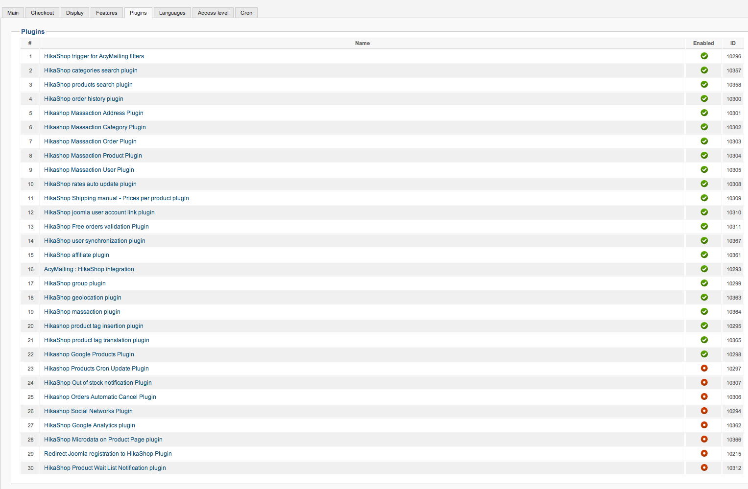

However, when I go to Components > HikaShop > Configuration > Plugins
neither one of these shows in the list of 30 available plugins. (screen shot also attached)
Could that be where the problem is?
  • Posts: 26386
  • Thank you received: 4078
12 years 10 months ago #129432
For the plugins, I was thinking more "HikaShop", like:
demo.hikashop.com/administrator/index.ph...&plugin_type=payment
and also :
demo.hikashop.com/administrator/index.ph...nt_edit&payment_id=3
(HikaShop > System > Payment methods)
  • Posts: 12
12 years 10 months ago #129433
There were none listed in the configuration > Payments section, only two shipping plugins, one enabled, one not.

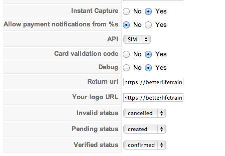

Hi, I loaded the link and it looks enabled and correct with the keys and secrets installed. screen shot attached. Unfortunately the original developer is completely out of the picture and unavailable.

You should turn on the allow payment notifications from %s option so that orders get confirmed automatically when payments are received. Also, make sure that the debug mode is turned off if you're on a live account.
Is it working now that you have the payment method setup ?

The payment method was already set up - when the link provided was loaded it came in pre-populated with the Authorize.net information.
I did change the allow notifications and - thank you so much for seeing that - the debug mode. I was looking in the Joomla system itself for the debug toggle.
We did get an order and a payment notification yesterday (attached), and hopefully these last two fixes will solve the problem.

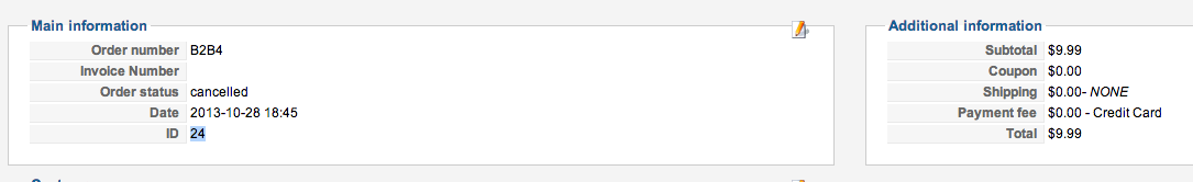

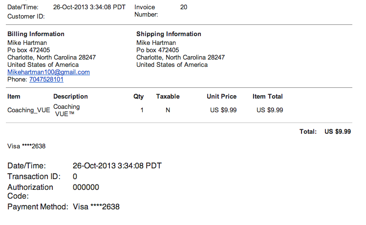

  • Posts: 12
12 years 10 months ago #129928
Okay.

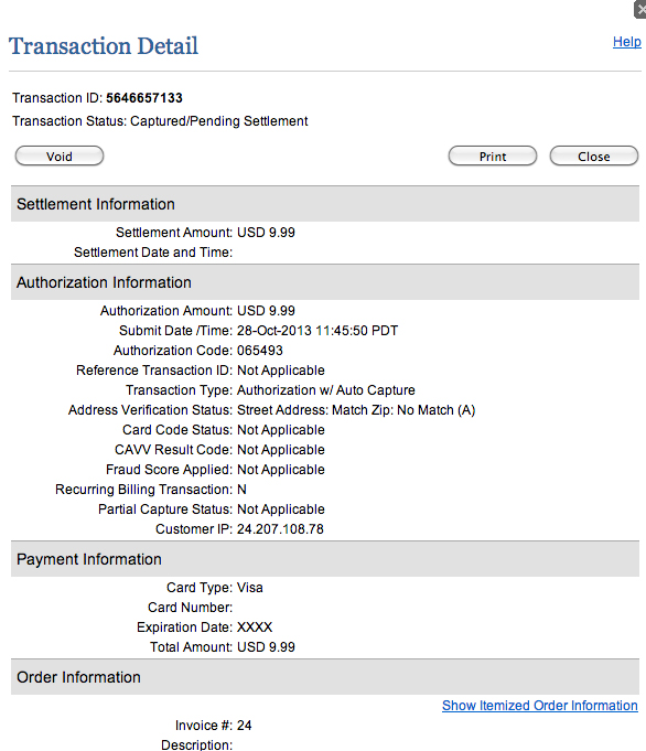

The test order message is now gone, and we've confirmed with Authorize.net that the orders are successfully completing on their end. (screen shot ordergoesthroughauthorize.jpg)
While there I also generated a new Transaction Key and entered it into the HikaShop credit card/authorize.net plugin.
However, the order is not coming into my computer as it normally does, and when I login to my site and go to Extensions > HikaShop > Orders, all orders placed since October 25 are showing as 'cancelled'. (screen shot hikashopordercancelled.jpg)
The customer's card was successfully charged (screenshot creditcardstatement.jpg), but the customer did not receive a confirmation of the order or the access to the product ordered.
We have a client awaiting our go-ahead that the ordering system works so he can make a payment and begin his training.
