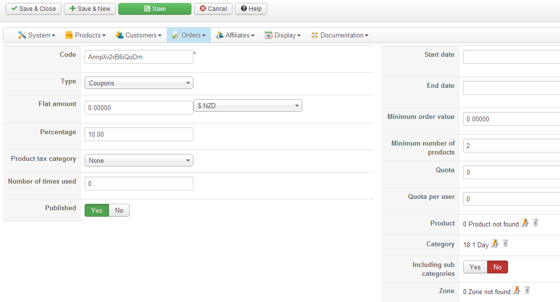

I have created a non-publish category called discounts.
I then have created a coupon that applies a 10$ discount if 2 or more items from this category have been selected. The coupon has the following set to yes "Auto load in cart if possible" and "Coupon percentage applies to product only".
However when I get to checkout, the discount has been applied to everything.

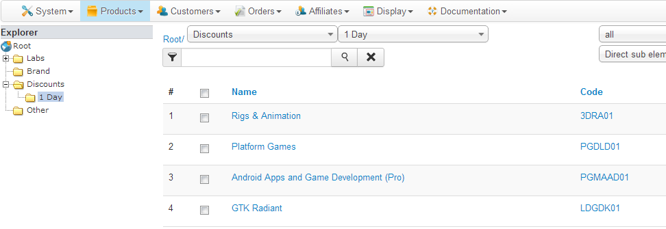

Here is a list of the products in the discount:

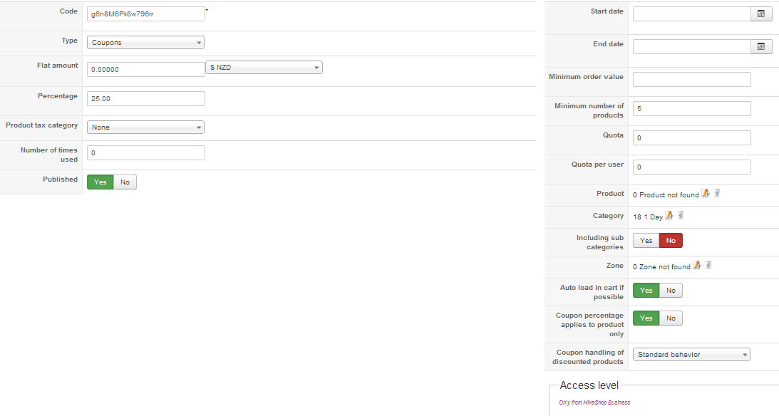

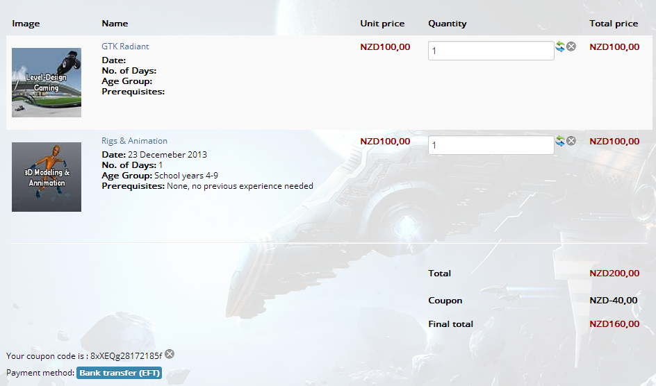

Here is the coupon that should apply when two of the above products are purchased
Here is what the checkout looks like

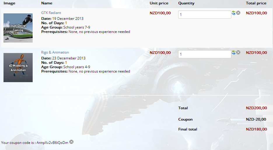

The result should be $180 (no discounted product) + $200 - $20 (10% discount on the discounted products because two of them were ordered)
This however is the coupon being applied and it's been applied to all products
Last edit: 12 years 10 months ago by abasel. Reason: Forgot an attachement

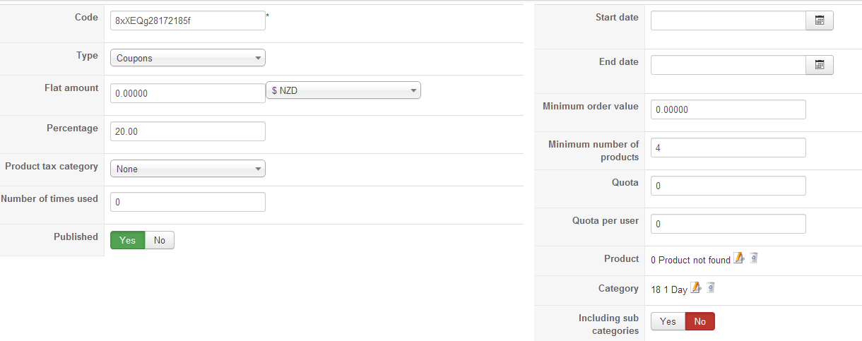

12 years 10 months ago #130222
Your problem is coming from the fact that the Minimum number of products is applied for ALL the product in your cart, so if you have 2 products in the discounted category, and 3 other products from another category, the coupon that will be auto loaded will be the 8xXEQg28172185f one.

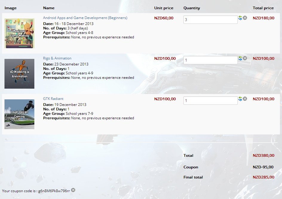

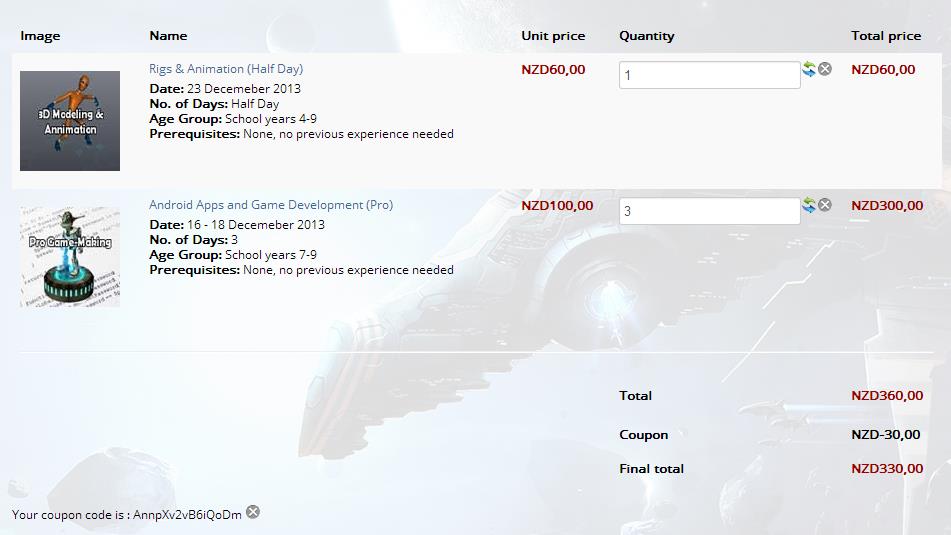

From the screen below you will see that I have two items, one of which is a discount item. The problem I have (and I am not sure if there is a way around this is that this should be seen as three items as they have purchased three). Hika however only applies the 10% discount as it sees it as a single item.
Is there a way around this as I need it to be seen as three items?
If I added another single day item I would then need the 4 day discount applied etc. Basically an order of 3 items (even if the same item) needs to been seen as 3 products for discount purposes.

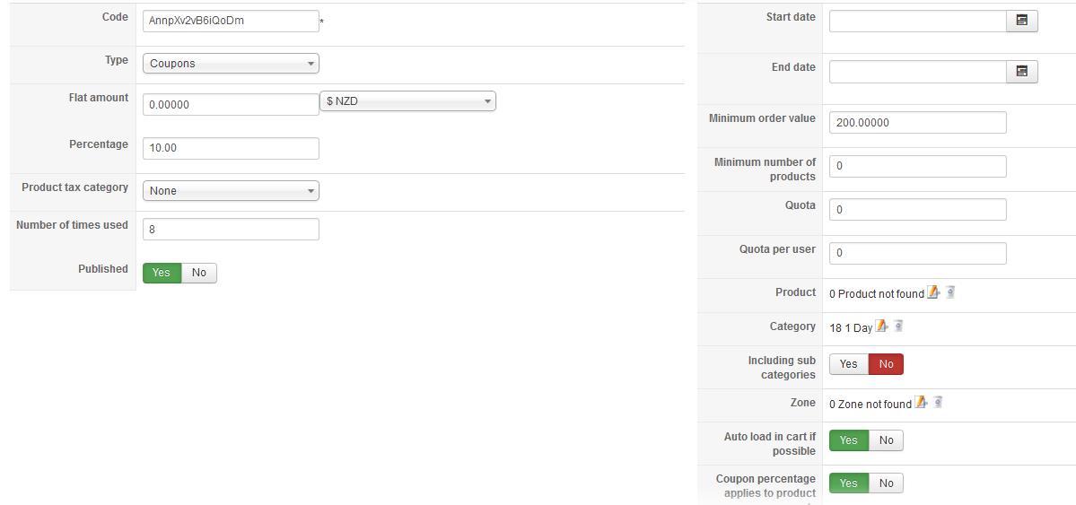

  • Posts: 139
12 years 10 months ago #130341
I think I have worked it out. As a single discount product always costs $100, I can use value of order instead of product quantity. There I test for the value of the order instead the number of products... this seems to do it.
Thanks for all your help... truly a GREAT product with excellent support.
  • Posts: 139

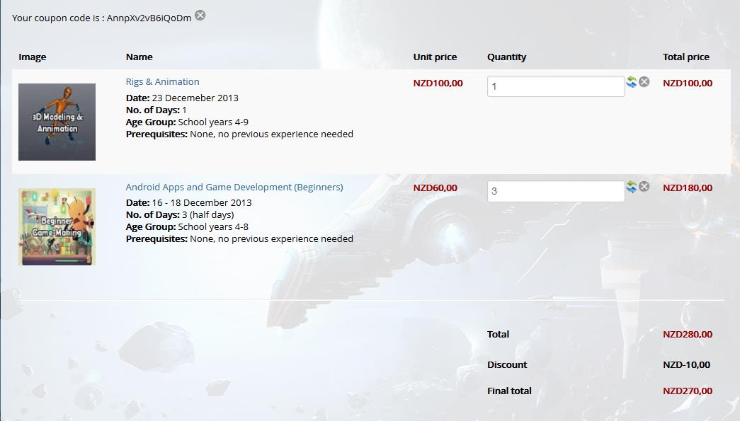

12 years 10 months ago #130381
Alas this is still not working, see image attached.
The value of discountable products is $100, yet Hika is taking the non-discountable product into account too.. there should be not discounts (I have renamed coupons to discount in the language file) in this scenario.
The issue seems to be of a similar nature to what was happening when I was testing by product quantity.
(Just so there is no confusion, I have renamed coupon in the checkout to discount (using the language file), so wherever you see discount in the front end it is actually a coupon)

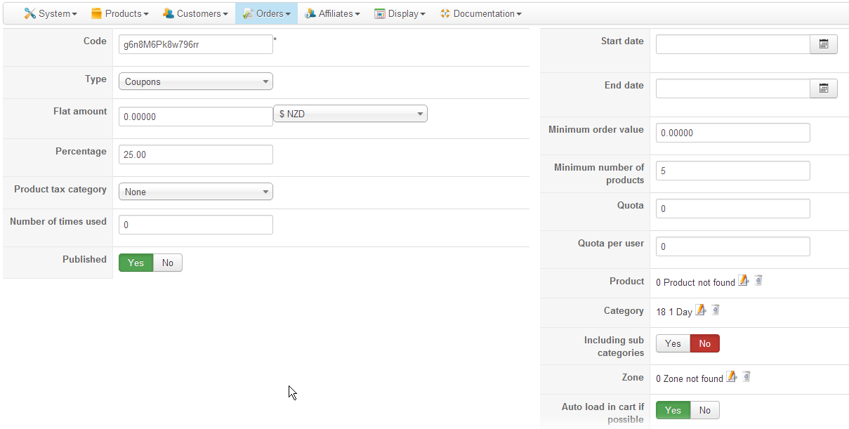

12 years 10 months ago #130475
Your configuration seems to be good.
The coupon should be applied only on the products of the category "1 Day" if the order is upper than NZD200 and it's applying to product only.
Are you sure that the half days product is not in the 1 Day category ?

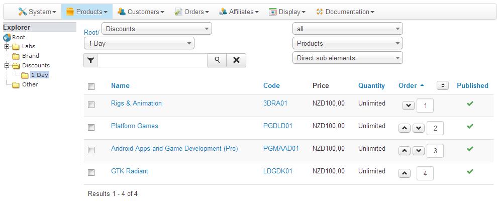

  • Posts: 139
12 years 10 months ago #130509
Yes, see screenshot
