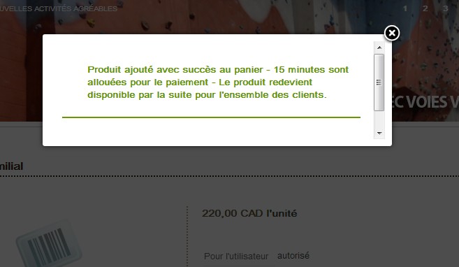

Hi. Just wondering how and where to change the Checkout Notice Box size ? Been looking everywhere, can't find any place where we can change the size. The height is not high enough, showing the box with a scroll, not wanted at all !

If want to change the size of your popup, you'll probably find your answer through this thread :
You can edit the file administrator/components/com_hikashop/helper/cart.php and change the line:
echo '<div style="display:none;"><a rel="{handler: \'iframe\',size: {x: 480, y: 140}}" id="hikashop_notice_box_trigger_link" href="'.hikashop_completeLink('checkout&task=notice'.$url_itemid,true).'"></a></div>';
